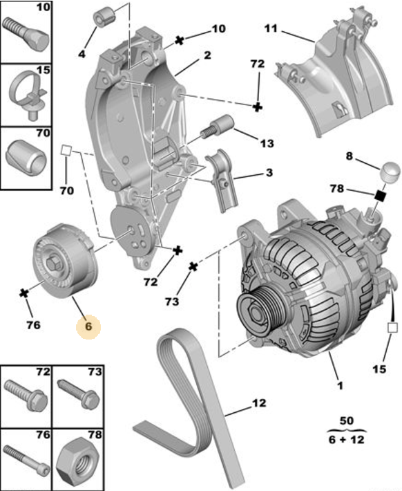

Yes, the alternator has a dynamic tensioner and must be locked with a pin prior to changing the belt.
Tensioner at (6)
Tensioner at (6)

Re: Noisy aux belt tensioner c5x7
No manual adjustment on the dynamic tensioner - as it's supposed to be 'dynamic'. It's compressed first, then pegged as you know, then belt replaced, locking tool removed, then the tensioner slowly decompressed using the tool.
If it's nothing else like the alternator pulley, then I suspect the dynamic tensioner may need replacing.
In anticipation of replacement, the part was superseded, so may be a reason.... anyway the new part number ((6) on the diagram), is 1611424380, £152.88!!

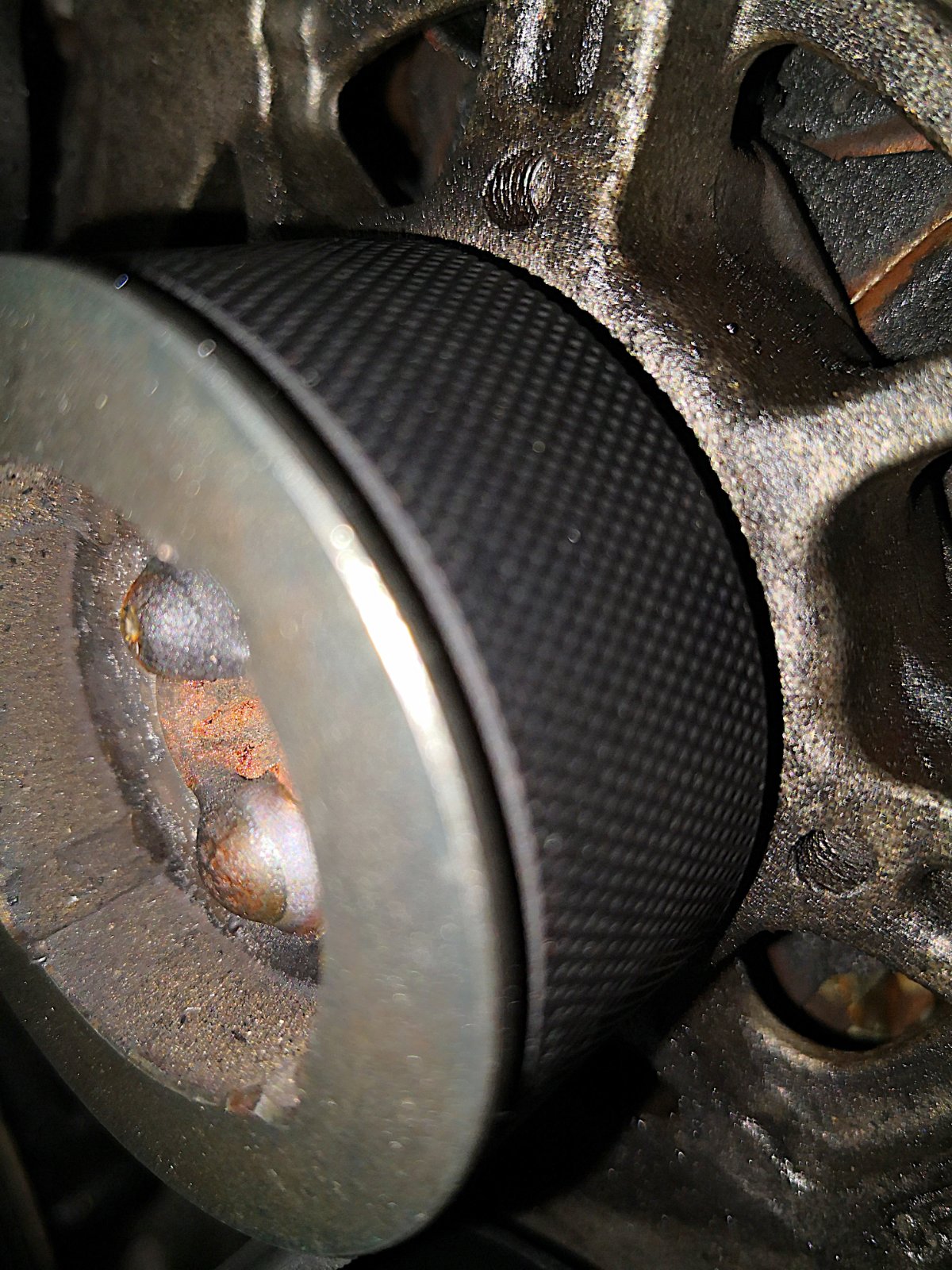

My 2016 C4 HDi (which I have had for less than a year - it's done just over 50,000 miles) has this issue of the 'chattering' aux belt tensioner. I am guessing it had been doing this for some time before I got it as the top tensioner (mine has two!) was lying at a bit of an angle suggesting the swing bearing had had enough.
I fitted a new belt & tensioner kit (Gates) a few months ago but sadly this didn't cure the chattering problem. Loading it up (A/C, lights, blower fan, PAS etc.) didn't seem to affect it. What DID stop it was some WD40 on the vee side of the belt - but only for 30 seconds or so then back it came. It's worst at idle speed.
I've had the new belt off, thoroughly cleaned it and all the pulleys and it's still the same. I even tried the old belt back on in desperation!
What I have also noticed is the stop/start seldom activates now, I don't know if it's connected but I'm not that bothered about that.
Having looked at @GiveMeABreak 's diagram above I just had a quick look at my setup to see if it's the same - which it's not! Mine has two sprung tensioners, one either side of the alternator pulley. BUT what I have now found is where there should be a bolt securing the alternator pulley, there is a welded 'blob'! Grrr. (I already had reservations about the previous owner's choice of garage....)
So may we be looking at replacing the whole alternator?
I will attach a pic, apologies for the poor quality, it's kinda hard to get a decent photo due to the pesky chassis leg in the way!

Hi Ttron, I'm not sure what might be causing yours - I replaced the pulley on the alternator itself and it has cured the noise. The old pulley was very badly seized when I tried to move the freewheel of the pulley. I'm looking at your photo and the visible pulley appears to be a different type - not like a 'clutch/ freewheel' type.

Thank you for your input @aerodynamica . I have no way of knowing if this is the original pulley, and even if it is, what's been done with it in the past. I've already had reason to question the previous owner's 'trusted' garage's methods. (I.e might it have been a clutch/freewheel type before being butchered?). To be fair though the alternator did spin very freely when I had the belt off - and probably in both directions as I cleaned it very thoroughly (though I wasn't consciously checking for that).aerodynamica wrote: 27 Dec 2024, 22:29 Hi Ttron, I'm not sure what might be causing yours - I replaced the pulley on the alternator itself and it has cured the noise. The old pulley was very badly seized when I tried to move the freewheel of the pulley. I'm looking at your photo and the visible pulley appears to be a different type - not like a 'clutch/ freewheel' type.
When you say "freewheel" should it be like a bicycle freewheel such that turning the pulley backwards would not turn the alternator shaft?

Hi, yes it's much like a bicycle freewheel. My old one was virtually seized although it was only once it was off that you could actually tell. I'll be honest, I'm not 100% sure what the freewheel system does - possibly purely a smoothness refinement. Although I considered it was an attempt to allow the alternator to spin faster than its drive belt at times when the engine slows e.g with engine braking. I'd have thought that was less likely since the alternator is almost always under load. Would be interested to know if anyone knows for sure.
I'm not sure the garage would have swapped the pulley with the wrong type because the freewheel variety have quite a specific fitting. Although it's not impossible.
Perhaps if you search the exact part number you might get an image of the correct item to compare to the one on your car.
