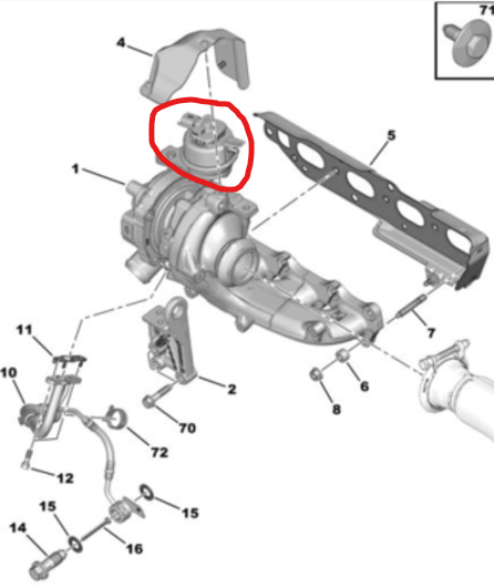

I have checked the live data, se picture and my concern is that the "Position indicator of the turbocharger go to 0 "zero" when the fault appear. Normally it has the same valye as the "reference value". So i think it can be the turbo position sensor. But i cant fint out how it looks and where it is located on the engine. What is it and where? Someone have a diagram where all sensors, actuators and vacuum are located?

Hi Ole, no the actuator is the bit circled:
PSA don't provide these separately, but they can be bought online form aftermarket suppliers or the OEM supplier and often can be replaced without removal of the turbo - depends on vehicle and access of course.

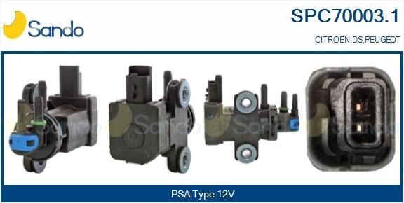

Today i got the item(18) Turbo Solenoid Valve (se picure).
On the new one there is 2 holes fore bolts. One at top and one at the bottom i cant even se the bottom bolt and dont know how to loosen if there is a bolt.
In the drawing is only one bolt?
Do you have any instruction how to remove the Turbo solenoid Valve?
Thanks in advance Ole

It dosnt looks like the drawing. But i took away the item(18) Turbo Solenoid Valve. Very tight, underneth was 3 hoses and 1 connector. Put in the new and cleared the faultcodes. Now it has been running for 2 days without any engine lamp on.
Keep my fingers x.ing.
Thanks for all help MArc
Best regards Ole
