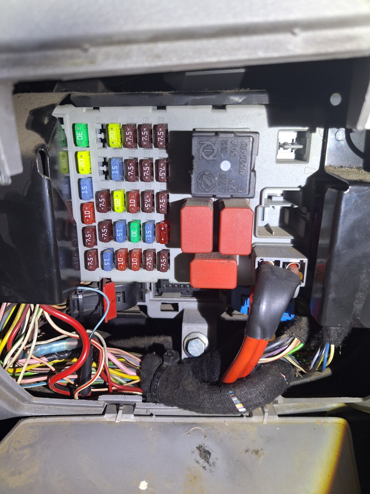

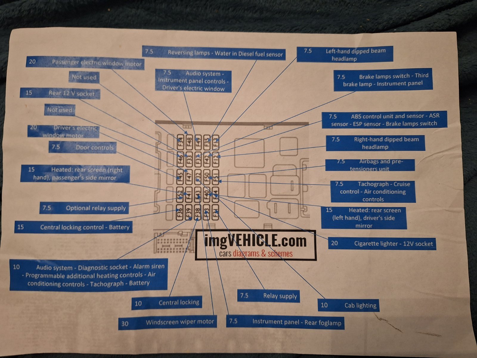

Obviously I can wire directly to the main battery with a small fuse, I have already fitted and tested a split charge relay myself, or I can take power from my leisure batteries. What other options are there? are any of the main fuseboard slots suitable (I have attached a photo of my main fuse board and a diagram I have verified as accurate when dealing with other things, I am just not sure what if anything is always on in there? Ideally I'd like to be able to run it from the vehicle battery whilst I am inside with the doors locked.

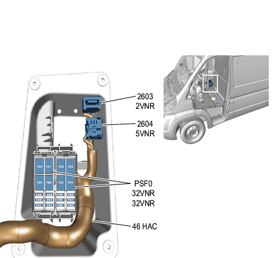

Ok, so first off, you may not even have the supplementary fuse box - because as I said it really depends on configuration of the vehicle and intended use (mini-bus for example that will require additional electrical fuses for the passenger cab). I think this is the one shown (if you have it it):
Back to the fusebox in your photo, this looks to be the fusebox in your diagram.

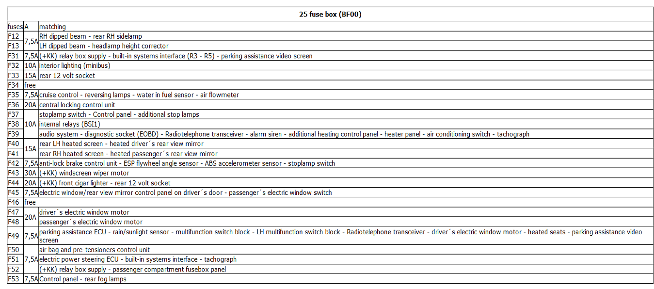

This is the allocation (note the fuse numbers can be seen on the housing in your photo etched in the grey plastic under each fuse.
Click Table to Zoom
Click Table to Zoom

Ok but this is exactly where I started, my own print of the fuse allocation is identical no? and as I said I had verified it.
I guess you have answered my question on the the Aux fuse board, if it is not at or near the bottom of the driver side b pillar it probably does not exist at all, which again I kind of figured
But I am no closer to the answer I was looking for, namely which of these fuse positions, (if any) would be ALWAYS live? and if it is none of them? is there any reason other than the aforementioned battery drain (if you forget to switch it off) to not wire it directly to the vehicle battery? otherwise where else might you suggest? I would really prefer to have this wired and fully live all the time, with an off switch.
What do terms like not used mean? is this literally just not wired to anything at the back of the fuse box, or is it a live spare fuse point I could use? short of going and poking at everything with the multimeter and a trial and error with the various states of ignition to fully locked....
by trial and error I have determined, for example, that the driver side electric window motor appears to be always on? but this is a twenty amp fuse, I have tested my piggy back back on this and it seems to to work, though sometimes with odd combinations of locking and ignition. I am wondering if there is also a timing element to this? i.e. it might not work if I have been locked in the van asleep for a number of hours?
What's an optional relay supply? and would central locking or central locking battery be a better option?
