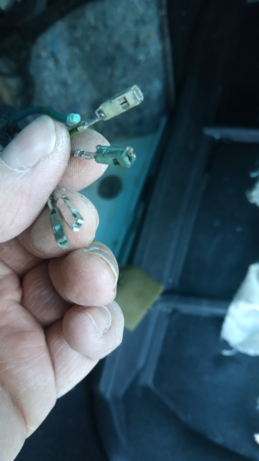

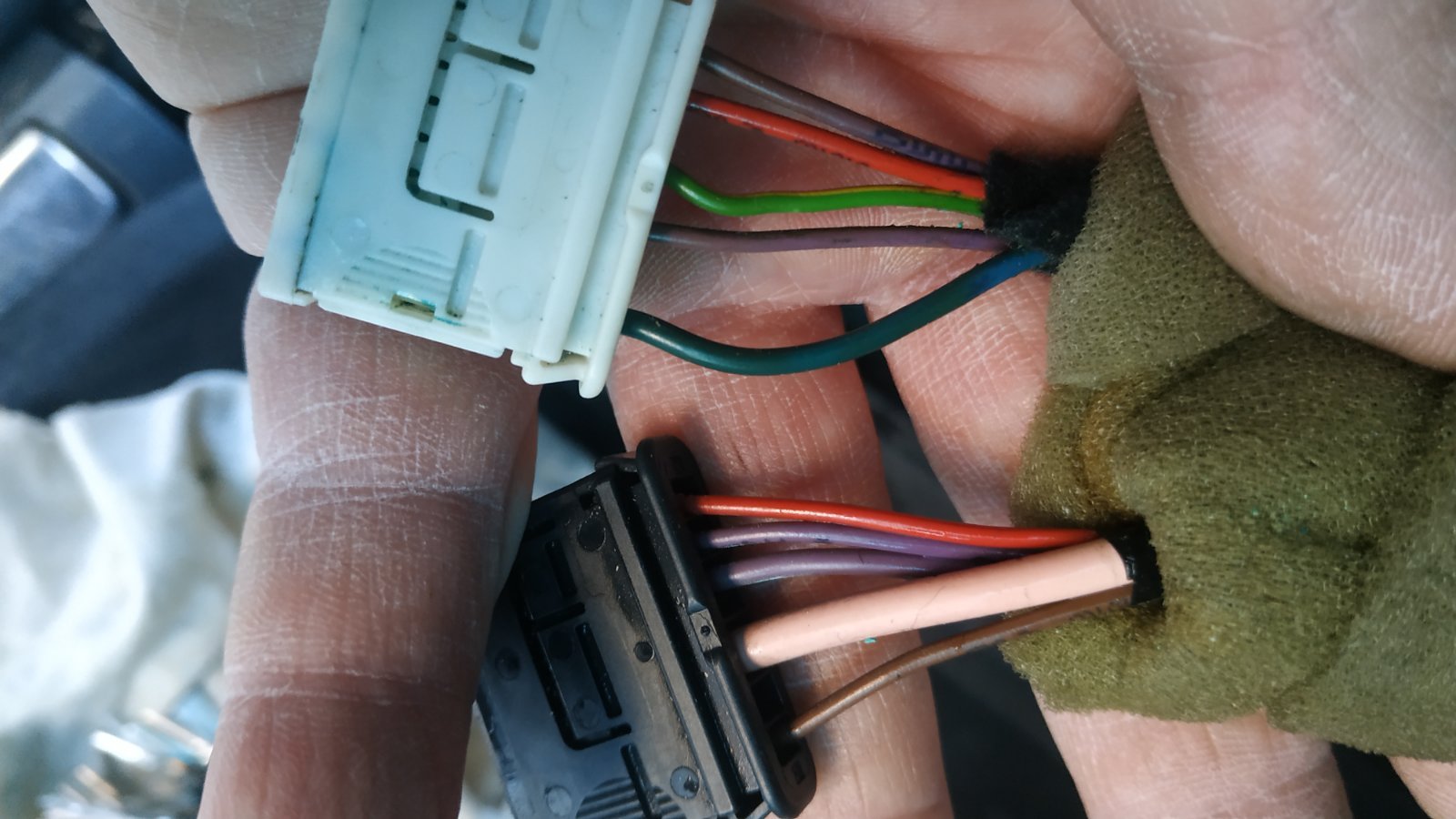

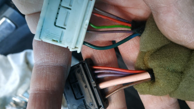

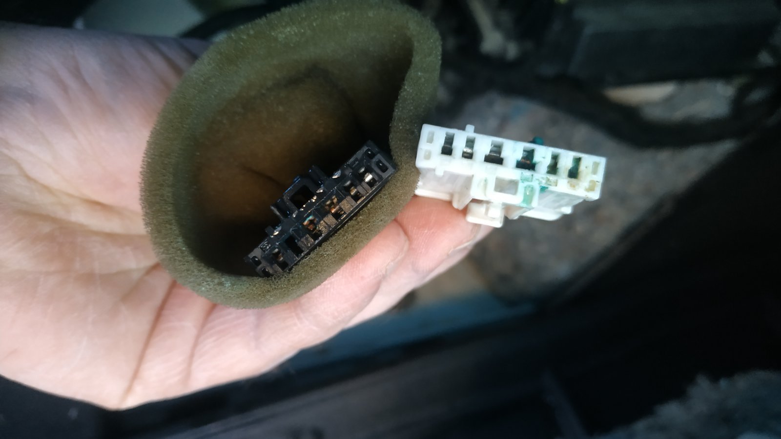

the problem turned out to be the sockets for the towbar's electrical network - they are located in the left trunk pocket. The sockets were in short-circuit mode. I don't have a towbar installed and both sockets were at the bottom of the left trunk pocket. However, the left trunk pocket had 5mm. - 6mm. of water which causes corrosion and a short circuit in the towbar sockets.
I was clear that there was a short circuit that duplicated the circuit of the brake light switch - I looked in detail at the diagram provided by Mark (GiveMeABreak) in several posts viewtopic.php?t=65527 , but I didn't know where to look.
So your suggestion Colin, made me open this area in order to dismantle each of the brake light bulbs. But with the opening of the left trunk pocket everything was clarified. I loosened and cleaned the bushings, raised them up, tied them up and everything is fine. I have properly working brake lights again!
