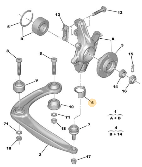

An answer swiftly provided by Marc:MattBLancs wrote: 18 Oct 2024, 15:58 Put a request on the parts thread
viewtopic.php?p=817830#p817830
To see about a new set of these:

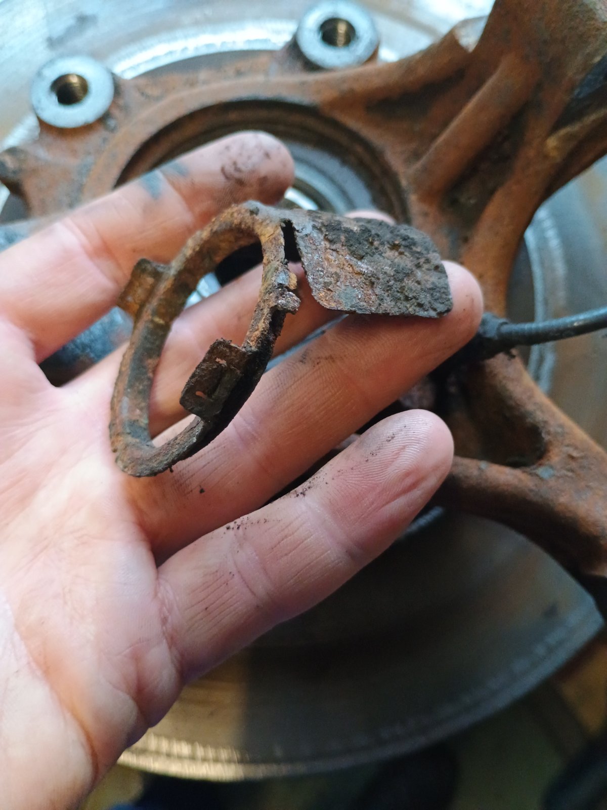

Not too painful. Current crusty thing has gone back on for now (quick splodge of Tetroseal, as per hub itself)GiveMeABreak wrote: 18 Oct 2024, 21:49Here you are MattMattBLancs wrote: 18 Oct 2024, 15:56 Good afternoon
Could you tell me the price for a bottom ball joint heat shield for the grey 308?
eBay seems to suggest 3623 13 could be the correct item. eBay also £17.99 each!? Autodoc has them listed to but out of stock (£4-£6 if they do come back in stock)
A pretty crusty mess of what's left of the two on this car!
Vin VF3**************[VIN obfuscated, can be read by forum staff]**************[VIN obfuscated, can be read by forum staff]
Thanks as always!
(6) Ball Joint Protector, part: 362313, £6.05
Will seek to pick up a pair and swap them in next time I'm "in the area" for another job

Grey 308 SW:
Suspension knock eliminated by the job above. Interestingly I checked the MOT advisory (from test in July this year) and it was noted only as slight play in the other side!
The other seemed fine to me, but as I bought a pair anyway I'll swap that before next July. Passenger side with invariably have me mistakenly pull the driveshaft out, so I will drain the gearbox oil as prior step for that job.

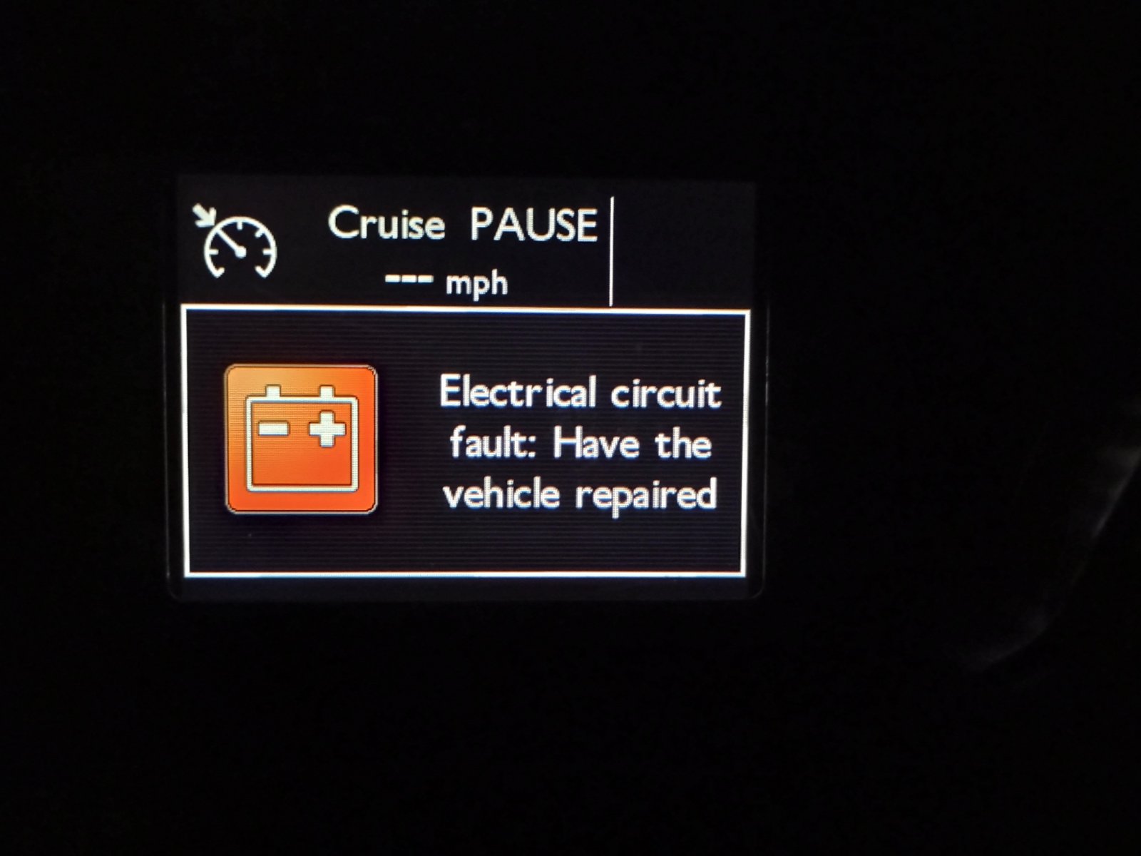

Strangely upon staring at home I was told
"ELECTRICAL FAULT, HAVE CAR REPAIRED" and SERVICE light lit.
Half a mile to Morrisons, off, filled up and restarted:
Disappeared, has run fine all the way here. Maybe the cold (3°C) is making the battery voltage drop.

Quite likely the battery protection unit, they are a common failing!

Ah ok, gives me something to investigate (as well as the diagnosis results)
