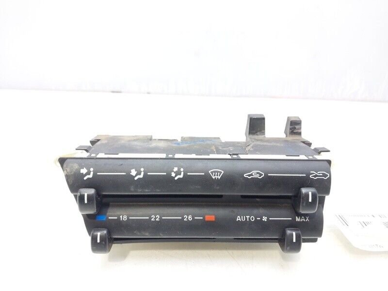

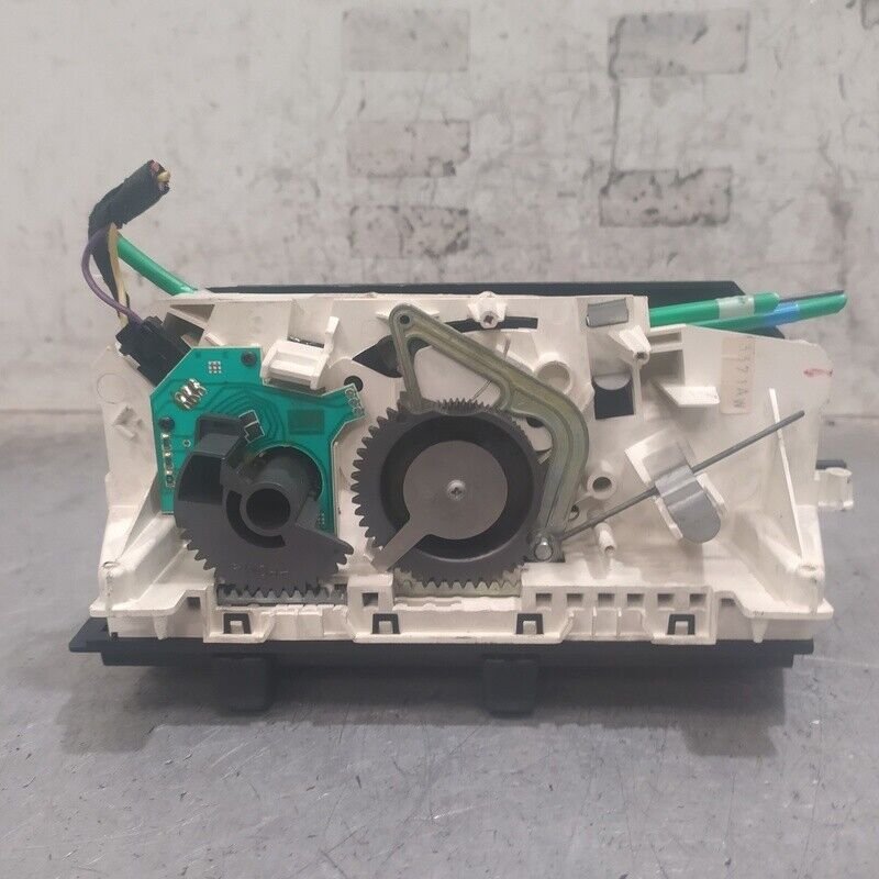

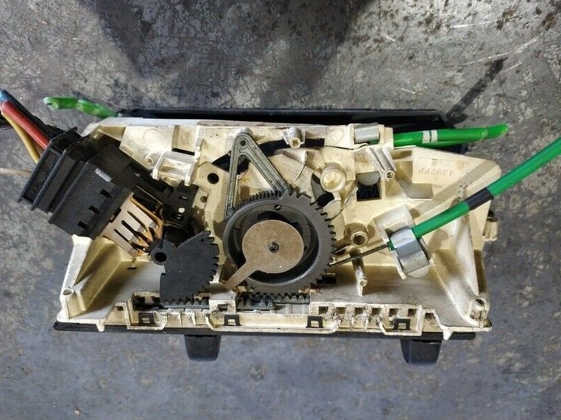

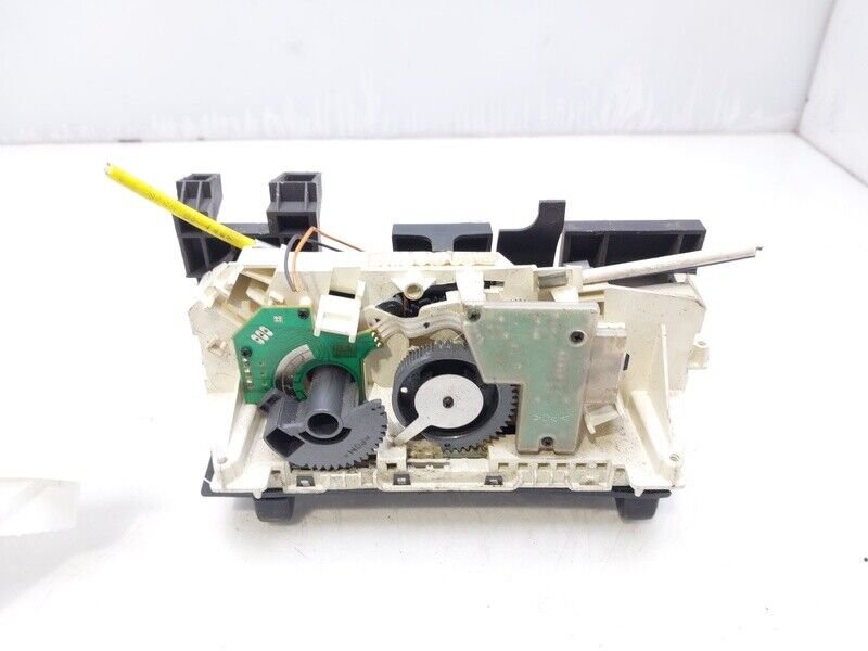

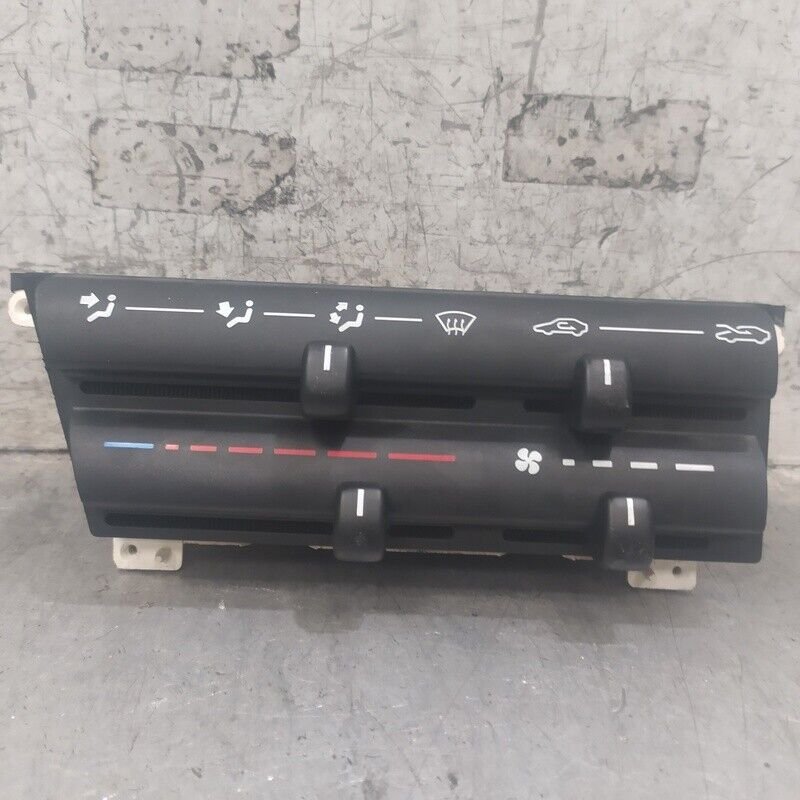

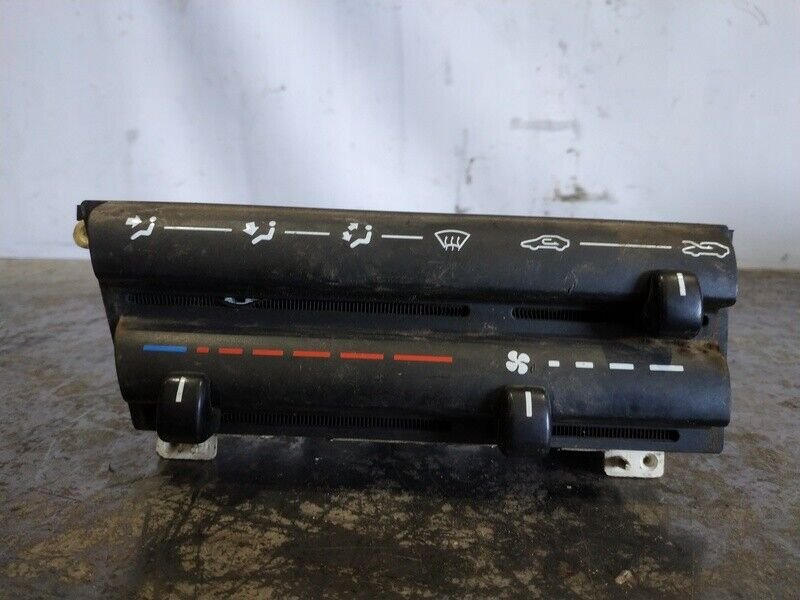

For Info, I have found the following types....Note, these are LHD ones, I presume that the same types are made for RHD cars as well.
Edit: Looking at the internals I think the "chassis" is exactly the same with just the LHD/RHD facia plates being the difference.....so IF you need one and your facia plate is OK then the european markets is open to you
Type A....No Air-Con/No Auto-Fan, very early/base spec cars
Type B....Later cars, No Air Con, No Auto Fan.
Type C........ Later cars, Air-Con and Auto-Fan
