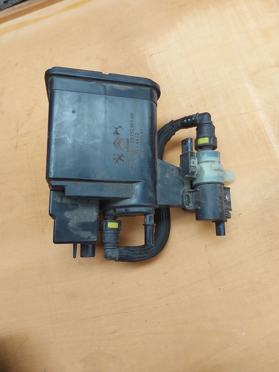

Yes, carbon canistre it was fault

Hello. I'm suffering from the same error. Two mechanics said that I need to change the throttle valve or the intake manifold sensor. Yesterday I updated the engine block firmware. The error remained. But u1108 and u1308 also appeared. What kind of carbon filter is this?
P.S. is this it? was it replaced or repaired?
