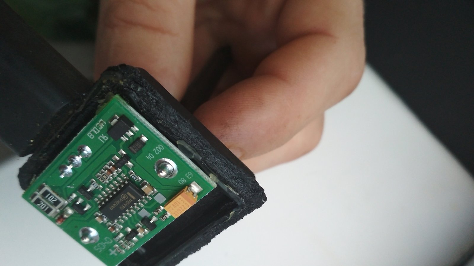

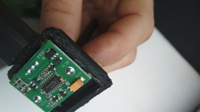

I've found this rather explanatory photo of coolant level sensor from C5 mk1
https://www.drive2.ru/l/488704057439944839/ Solder cracks at connections and they become intermittent
In my case it probably didn't help that engine mounts were knackered for quite a while, especially hydraulic one next to pump.
