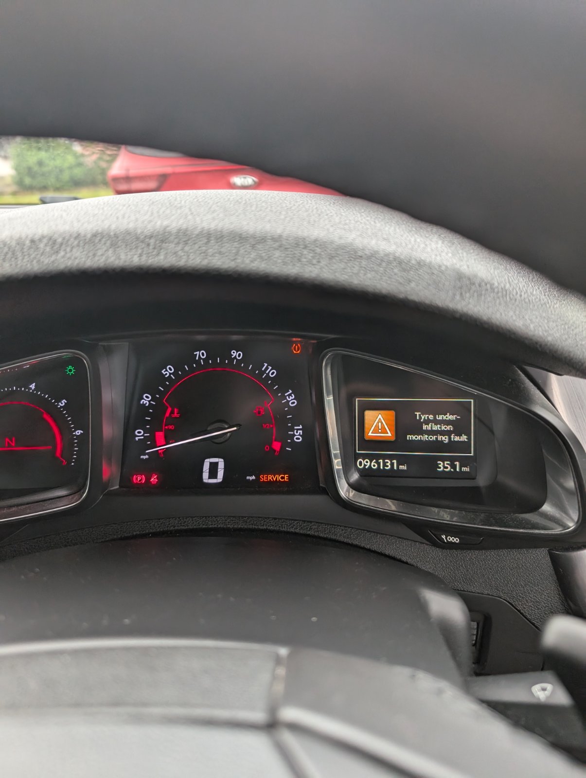

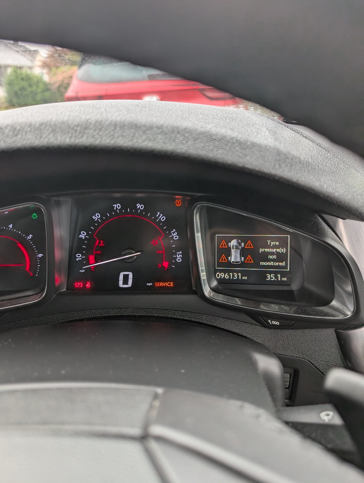

Hoping you guys can help.
Have a 2015 ds5, last couple of days I've been getting the attached service messages upon engine start.
'tyre under inflation monitoring fault' and 'tyre pressures not monitored' (have attached pic of both)
Could this be something to do with the battery for the pressure monitor needing replacing or?
I have no idea what kind of tyre pressure monitoring system my car uses, i cannot see the psi for each tyre on my dash, so I'm guessing it's just the standard one that monitors the pressure as opposed to each individual psi?
Anyone help me out on what I'd need here? Quick fix or a bigger job for a garage to do?

Re: Tyre under inflation monitoring fault
Can you provide your VIN, so I can see which system you have as there are 2 possibilities. Please post your VIN in full without spaces - it will be automatically masked from public view after submitting your post & will only be visible to staff.
Ok, so you have the direct TPMS system with wheel transmitter modules.
So this warning can be for several reasons - one or more transmitters are not communicating with the TPMS ECU, which can be the battery has expired (they only last about 10 years if lucky) or the ECU has an issue, so it really needs a diagnostic to determine the specific cause.
Thank you. Upon having a quick look a battery replacement seems cheap enough to do and hopefully it is that, my car is almost 10 years old and the full history of paperwork I have for it on work done doesn't show any work being carried out on this.GiveMeABreak wrote: 01 Oct 2024, 10:06 Ok, so you have the direct TPMS system with wheel transmitter modules.
Until you get a diagnostic done (preferably by either the dealership or somebody that has a Lexia kit with Diagbox) to determine the actual cause, I strongly suggest you don't start replacing anything. The ECU's are pretty robust, so may be a pairing issue with the BSI or a transmitter or another reason. The transmitter modules are not supposed to opened up but replaced as they are sealed to prevent problems.
Thanks for this sorry for the late reply..GiveMeABreak wrote: 01 Oct 2024, 10:31 Until you get a diagnostic done (preferably by either the dealership or somebody that has a Lexia kit with Diagbox) to determine the actual cause, I strongly suggest you don't start replacing anything. The ECU's are pretty robust, so may be a pairing issue with the BSI or a transmitter or another reason. The transmitter modules are not supposed to opened up but replaced as they are sealed to prevent problems.
Just like to add that although I haven't had the issue tested yet, it's seem to be intermittent. For example, the last few days it hasn't come on upon car start, only after 10-20 mins of driving.
But then some other days it came on right away? Could this be a sign of the battery wearing out and needing replacing?
So the vehicle is exactly 10 years old on 12th November. The batteries in the transmitters are designed to last for at least 10 years, so it may be that one or more is starting to fail - but can't say for sure. A diagnostic would provide one or more fault codes - so if you get a chance to retrieve those when you have had time, pop them up here.
The trouble is the battery can't really be easily replaced - the sensor is glued onto the inner part of the tyre and the innards are cased in resin. They are designed to be replaced after the service life and without knowing which sensor it is (if any) you wouldn't know which sensor is faulty - but again it may be another issue totally - hence the need for a diagnostic.
