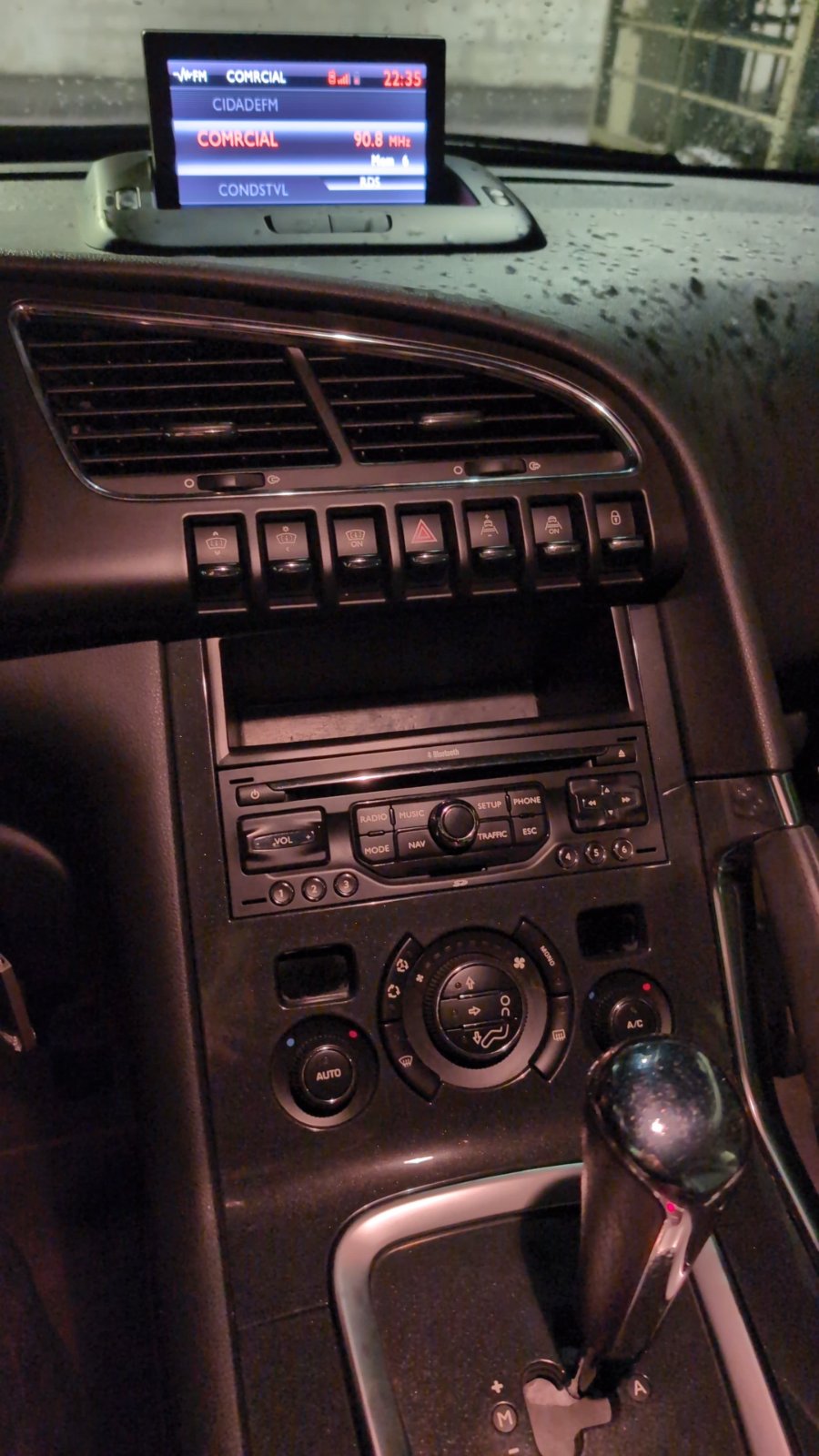

So, I bought a used 2011 Peugeot 3008 1.6 HDi Sport, 112cv. From what I was able to understand, it has a RNEG system with the retractable screen on top of the dashboard (photo attached, from my own car). It has version rneg_d_r29a_r29.01. From what I saw in the foruns, the most recent version would be rneg_d_r50b_r50.03. Is this correct? If so, where can I get it from so that I can update it? Should I have some concerns before doing this?

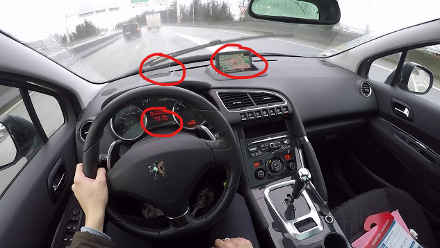

Another question: is the upgrade to RNEG2 a good option? Any other good options? SMEG? Other? I also have a 2010 Peugeot 308 that I upgraded 4 years ago with one Aliexpress android unit, and everything works correctly, besides the poor microphone sound quality that I still didn't have the time to solve. I was hoping that I could do something similar to the Peugeot 3008, but I'm seeing that this is much harder to do. I can't even understand what would happen to the retractable screen if I just put a 2 DIN head unit like I did for the 308. Also, would the security features of the car still work? Would the information in the multiple dashboards appear? (photo attached with the 3 places I mean. generic photo taken from the internet)

RD4 & RD45 are completely different systems to MyWay. As to what functionality you will lose will of course depend on what Android unit you are going to replace it with, but this vehicle as a retractable display for a start and the data is handled differently as with the HUD, totally different to a basic RD45 unit.
Navigation data sent to the HUD and the dashboard (matrix) are specifically calibrated. When you bypass all these for an Android screen, you will just loose the lot I suspect. An Android unit will not be compatible with your HUD, nor the retractable screen. I can tell you that aftermarket mapping won't work on your original display or the HUD.
