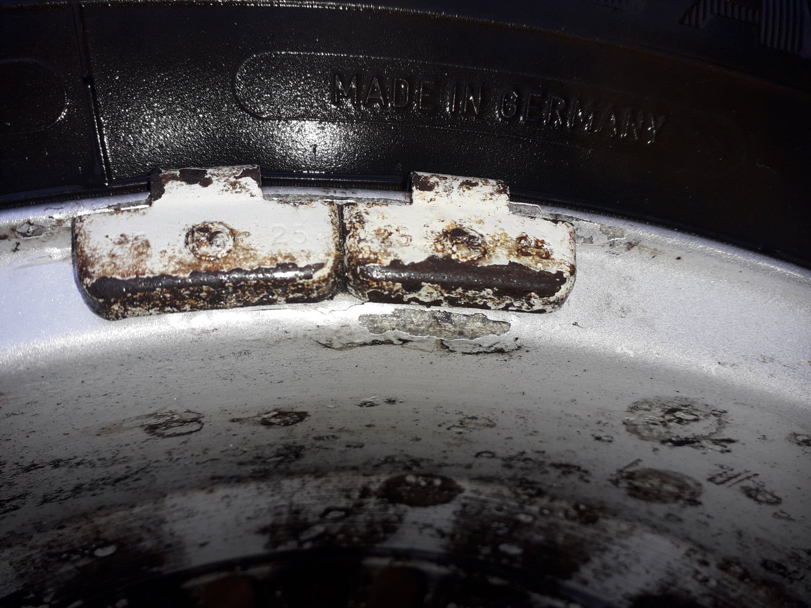

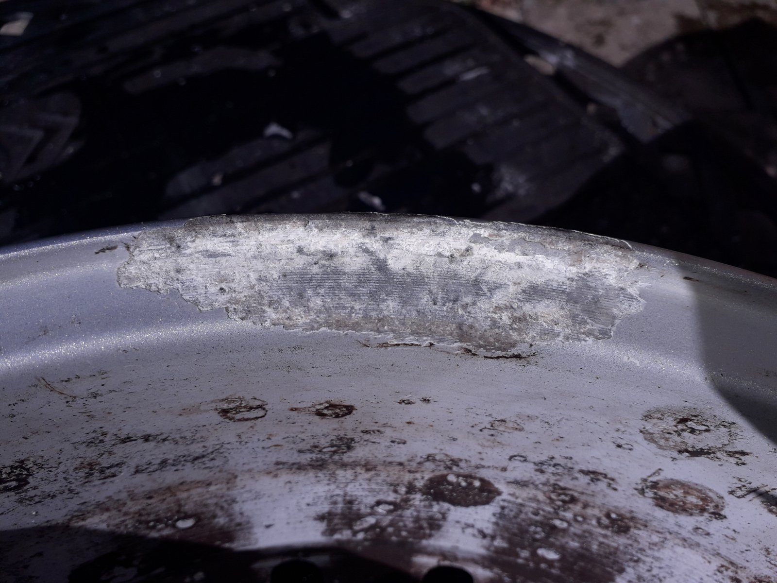

On another C5 thread I highlighted that a pair of knock-on rim weights, on the inner rim, had been fouling the hand-brake cable guide bracket, unseen since fitting in 2018.
I have started this thread to highlight the other problem knock-on weights can cause - corrosion. The photos tell the tale. So, I recommend insisting on stick-on weights. As my alloys are 23 years old, I have for some time asked the local fitters to give me the tyre-less rims, to touch up as necessary. I did learn something from them this time. The fitters said that on older wheels they run an abrasive wheel along the sealing surface of the rim and use a silicone sealant, so they can achieve a first time air tight fit. Good for them, but not for the bare metal so exposed. I counted 15 trails of corrosion leading from the bare metal around the inner rim to inside the tyre space.
Insist on stick-on wheel balancing weights on alloys

Re: Insist on stick-on wheel balancing weights on alloys
Fitters should be using stick on weights by default for alloys....
Agreed on the stick on weights are more ideal however i have seen some that are a bit to thick & can rub on brake callipers too, some caipers have a tiny clearanc with the wheel.
Also many alloys leave the factory with hammer on weights including PSA ones, if using hammer on weights they should be specific coated ones for alloy wheels.
The reason they need to do this is because of corrosion in the first place, where the bead has been sitting on the tyre you get corrosion, after a few years you find the paint has all bubbled & once disturbed there is a good chance it wont seal, its fairly normal to have to clean it up with a wire brush. It's either that or sending your wheels for a full refurb at every tyre change.aspire_helen wrote: 28 Oct 2024, 17:20 I did learn something from them this time. The fitters said that on older wheels they run an abrasive wheel along the sealing surface of the rim and use a silicone sealant, so they can achieve a first time air tight fit. Good for them, but not for the bare metal so exposed.

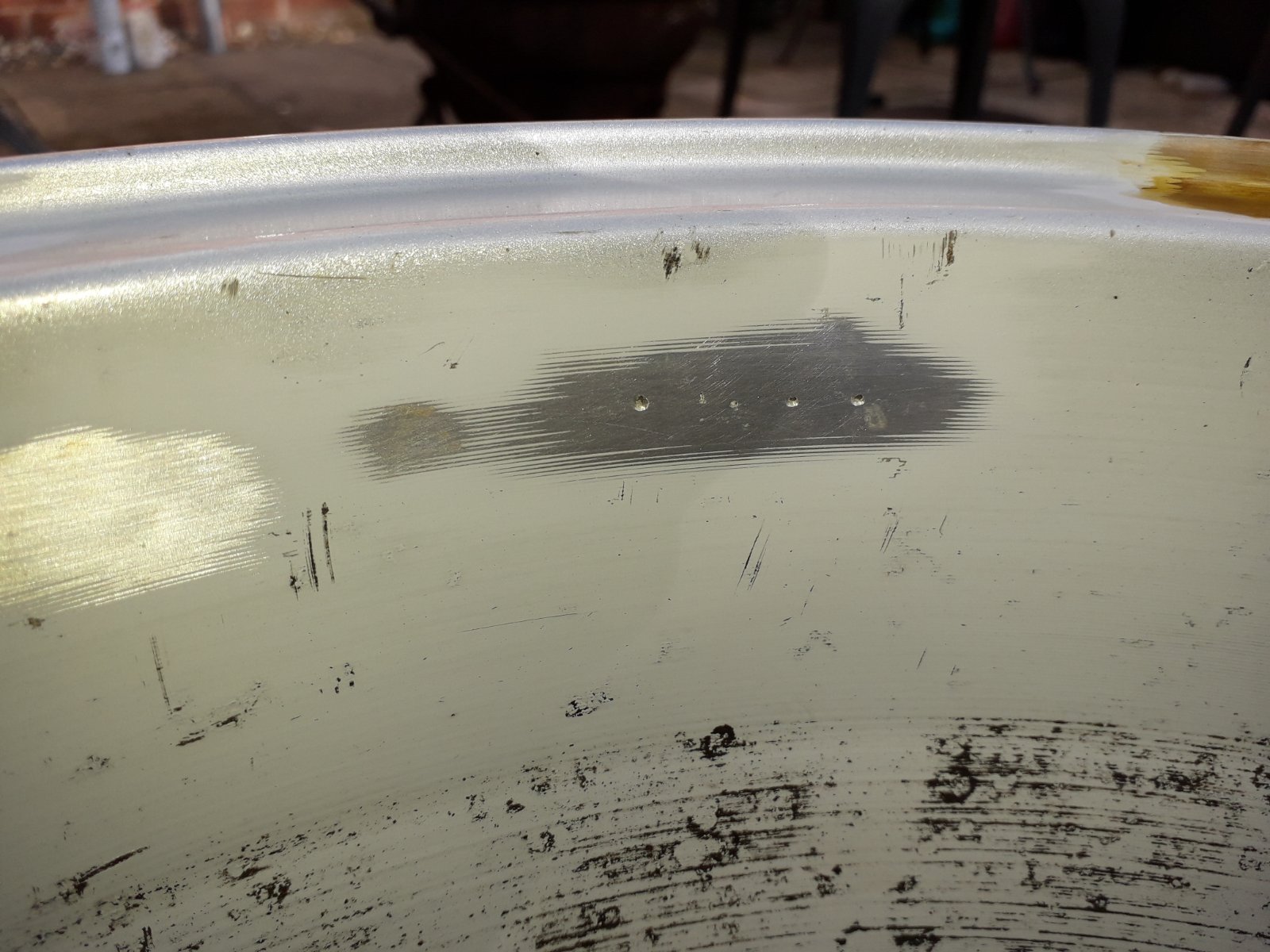

aspire_helen
- Posts: 221
- Joined: 08 Sep 2020, 22:12
- x 80
Sloppy Sod
You remind me. My wheel has such holes on the inside, four sets of 4 or 5 holes, 90degs apart just as if the clamp face has had a row of pimples for grip. All have been the seats of corrosion. Of course, I cannot determine when during its 20+ years this has occurred, but only once. See photo.
