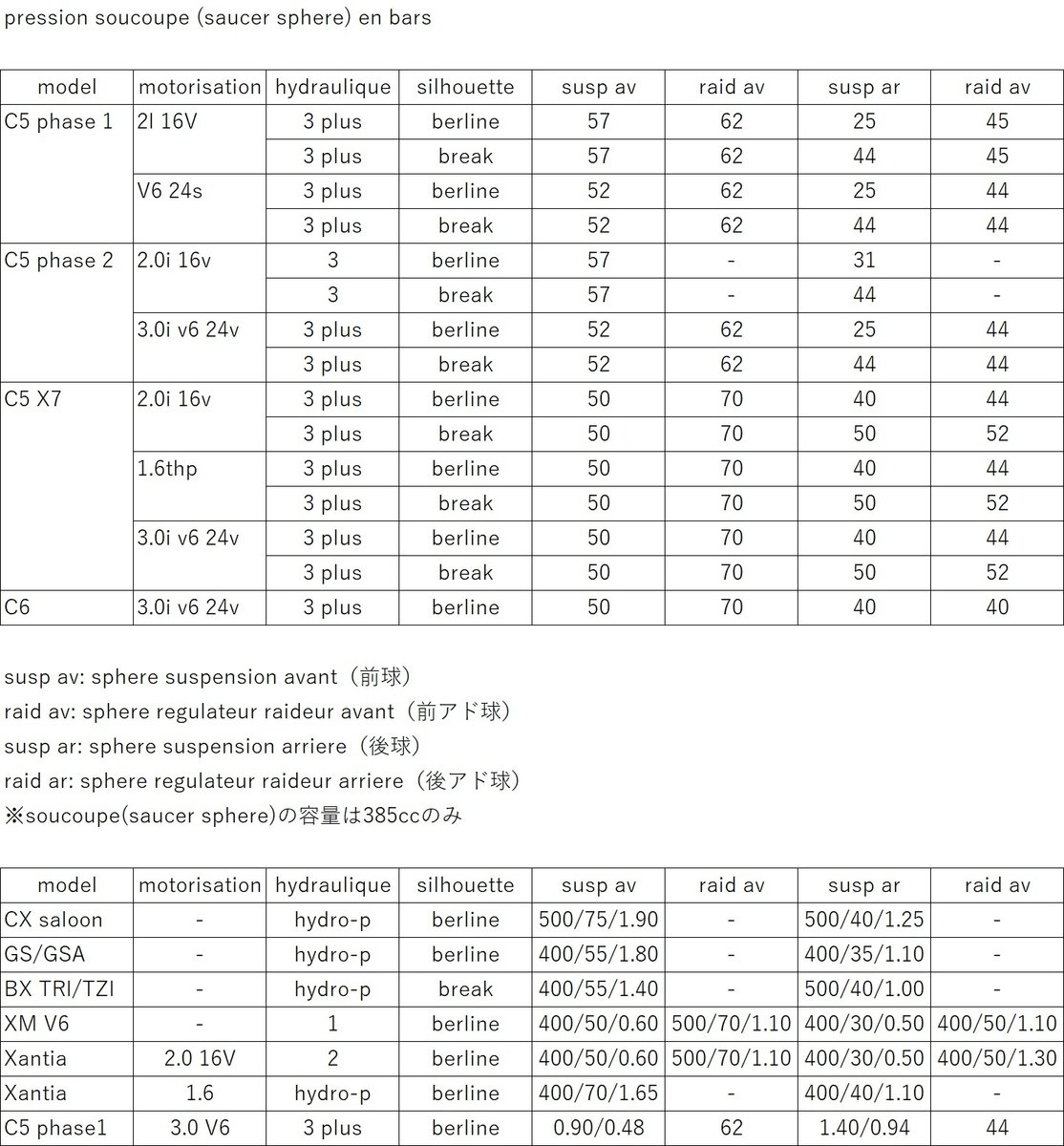

I found a table with values for the spheres pressures, but it's french. From what i understand my front's should be 57Bar.
BTW where is that third sphere? I just don't see it.

careca wrote: 26 Oct 2024, 22:31 I found a table with values for the spheres pressures, but it's french. From what i understand my front's should be 57Bar.
If the car does not have a sport button, then it does not have a firmness control with an additional ball - i.e. no Hydractive 3+ suspension.
All that remains is a moderate increase in the pressure of the front ball bearings and to find out exactly what pressures are required via the VIN.
Only the original ball bearings are optimally designed for the vehicle - replicas from any manufacturer are suboptimal and can usually be used on many models.
