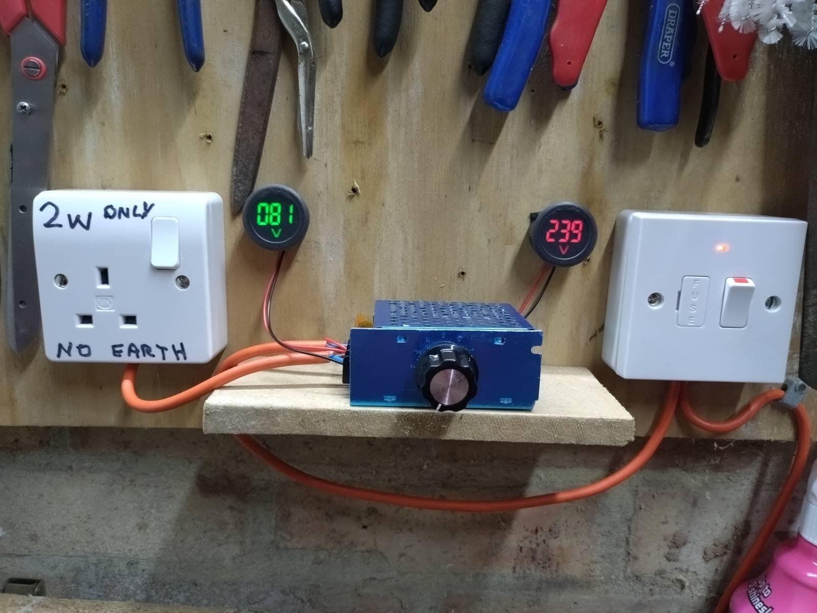

Well I received the last parts I needed enabling me to complete the supply setup:
MTMO
MTMO
and following that I was able to mock up the final test bed for the idea thereby putting you all, well both of you, out of your misery :-D :
Spoiler: show
Unfortunately after a few tests the 300W strimmer motor was not at all happy so I am looking for a more powerful motor, but at least it proves the fundamental idea works!! :-D

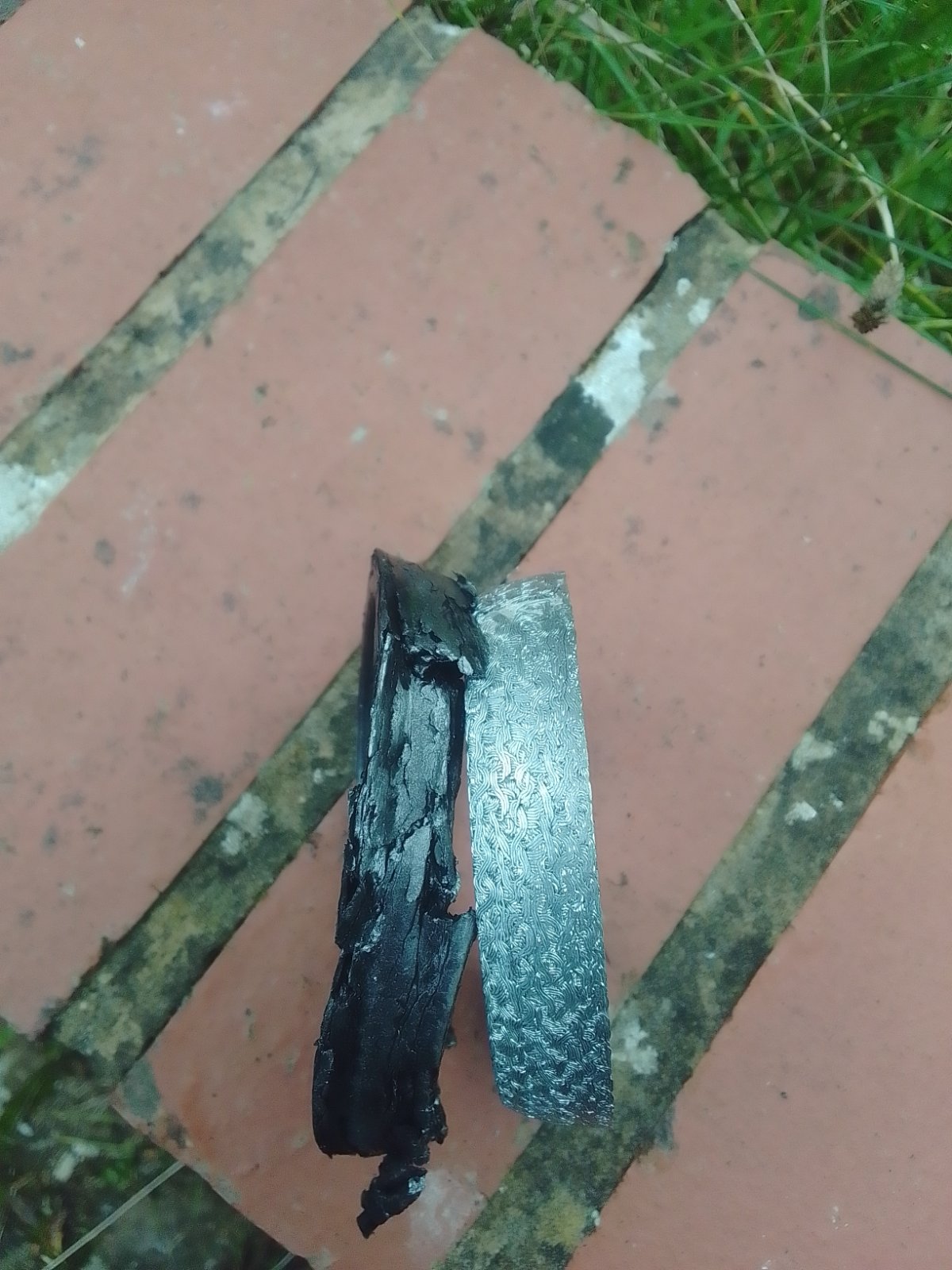

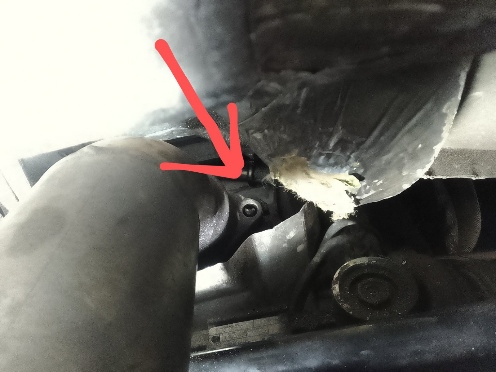

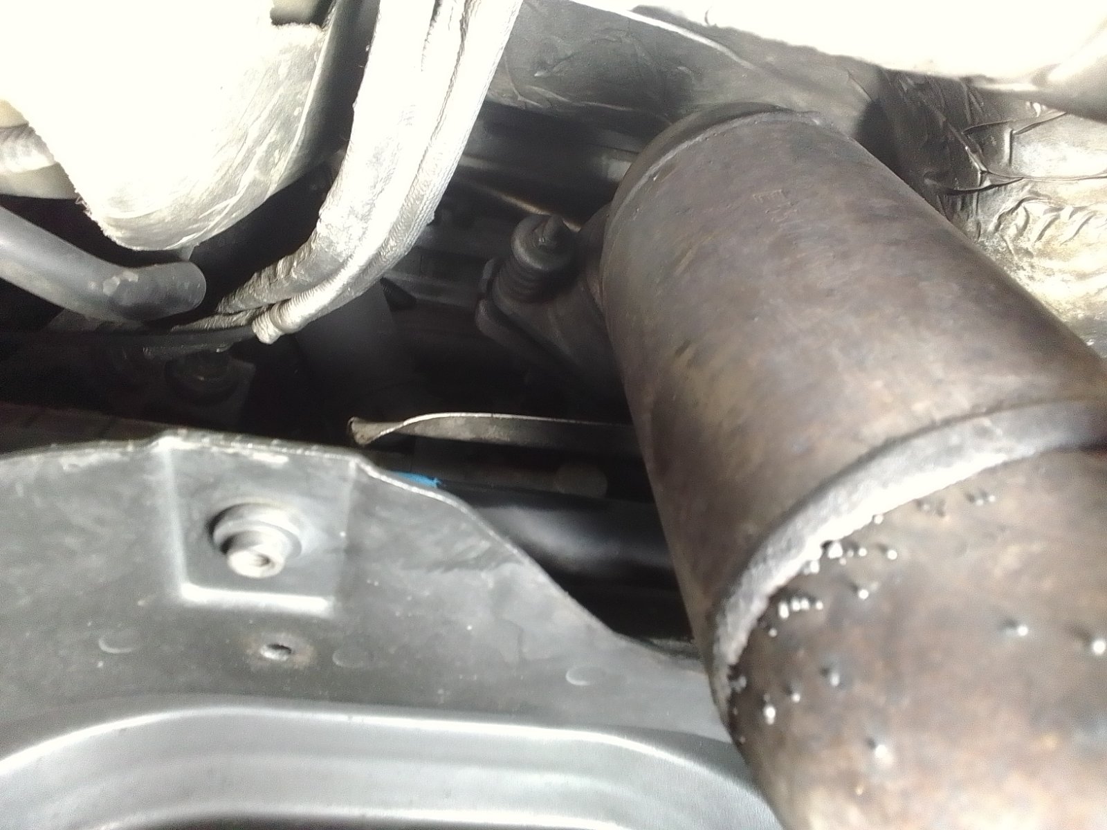

I finally got to work on the car yesterday but gave up after a few hours. I managed to release one of the spring bolts from the turbo/exhaust joint with only minor scrapes, a sore back and the realisation that I'm not as slim as i used to be.

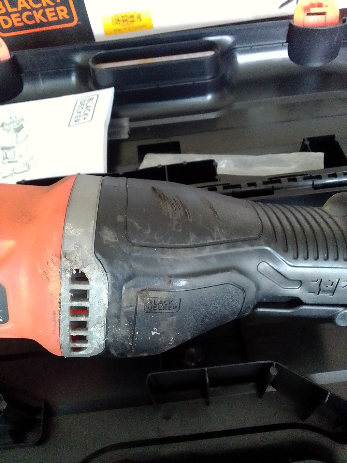

The second bolt however refused to play ball!! Not only was it in the most awkward place which I could only just get a hand to. It was loose, spinning and had a nyloc nut on it!! The main problem with this is that there was no access to the top of the bolt. So I gave up for the day thought about it and I decided to ordered a new toy....a reciprocating saw. It arrived today so I got straight to it, 2 hours of cutting through the spring to get to the bolt finally paid off.
Minor damage to my new saw which shows how tight the gap is to get to it.
The next step was relatively easy, replace the gasket
and defy gravity with a bolt that constantly moves whilst trying to slide a spring, backplate and screw a nut on the end. But both sides fitted, tightening up can wait till tomorrow.

Unread post by Rp0thejester »
Make sure you take that spanner with you on Tuesday incase Bobins starts playing up! I did think of trying something like that Jim but the bolt is recessed and with only a finger gap above it. To get that 1 bolt out it's either cut it off or lift and slide. I did the final tighting up this morning and now the exhaust fumes actually come out of the back of the car!! Replaced the brake light bulb, bought from Halfords, nearly had a panic attack as it still wasn't working, good job there was 2 in the box. Oh and to defy gravity I sellotaped the spring, washer and backplate together and carefully slide it on the bolt. I now reckon I can beat the kids at a game of Operation! Off to the test centre....
