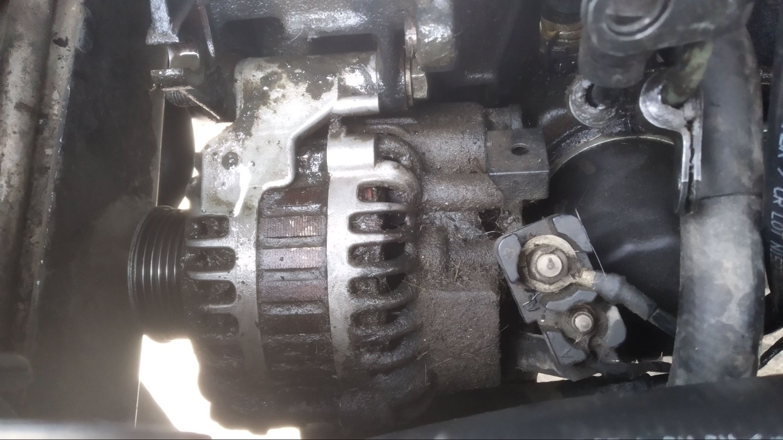

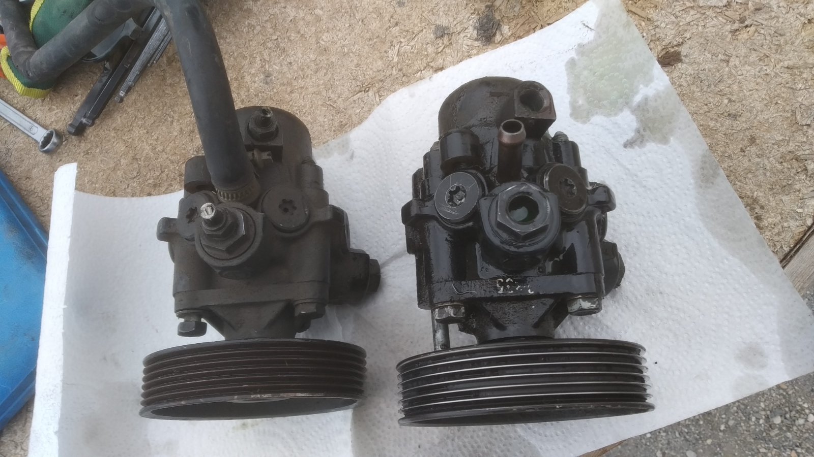

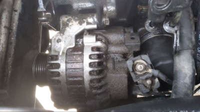

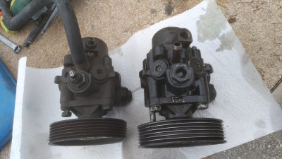

Got the pump off. Local scrapyard had one! Not sure why they loosened a 13mm bolt. It is dirty though, needs a nice wash. As does my alternator but wondering if I should clean it, since it has electrics? I need a new aux belt as its contaminated and an accumulator sphere. Will use old belt for start up though, in case the pump spews everywhere!

Ah, the old LHM in the alternator trick! is it just grimy, or wet with LHM (which has dripped from the pump)? If it's just grimy then it's probably OK, but if there's evidence that LHM has got inside the alternator then it's not OK. The problem is not so much the oil as the carbon and other dust that it traps, turning it into a grinding paste (which is probably also electrically conductive).
I agree that washing these is not usually recommended (although I have got away with a squirt of degreaser and a flush out with water, then leave it to dry before firing up), but doing nothing is really not a good idea. You've got the belt off, so now is the time to get the alternator out. If you don't think you can dismantle and clean it internally yourself, it would be worth getting it checked/reconditioned by an auto sparky.
Would your local scrapyard also have the alternator? If your 'new' pump is just dirty, then the alternator off the same car should be OK :-k .

Thanks. I cannot trust the local auto electrian (long story, bunch of @rses). I think that disturbing the dirt, without doing it properly, will just push the dirt deeper in. It is utterly filthy, full of LHM paste. Will have a look tomorrow and decide.

As Armidillo says... I've had a few LHM contaminated alternators now and I've cleaned them adequately without stripping them by well and truly dousing them in electronics grade solvent and blowing them clean with an airline... Keep washing and soaking in solvent until it runs out clean!
Check very carefully the compatibility of that replacement pump... There are detail differences in pumps and if the replacement is not absolutely identical you may run into issue with the aux. belt fitting and alignment...

Wahhhh! Not the pump then. Luckily the pump seems a good one, even sounds quieter, with no immediate leaks.
