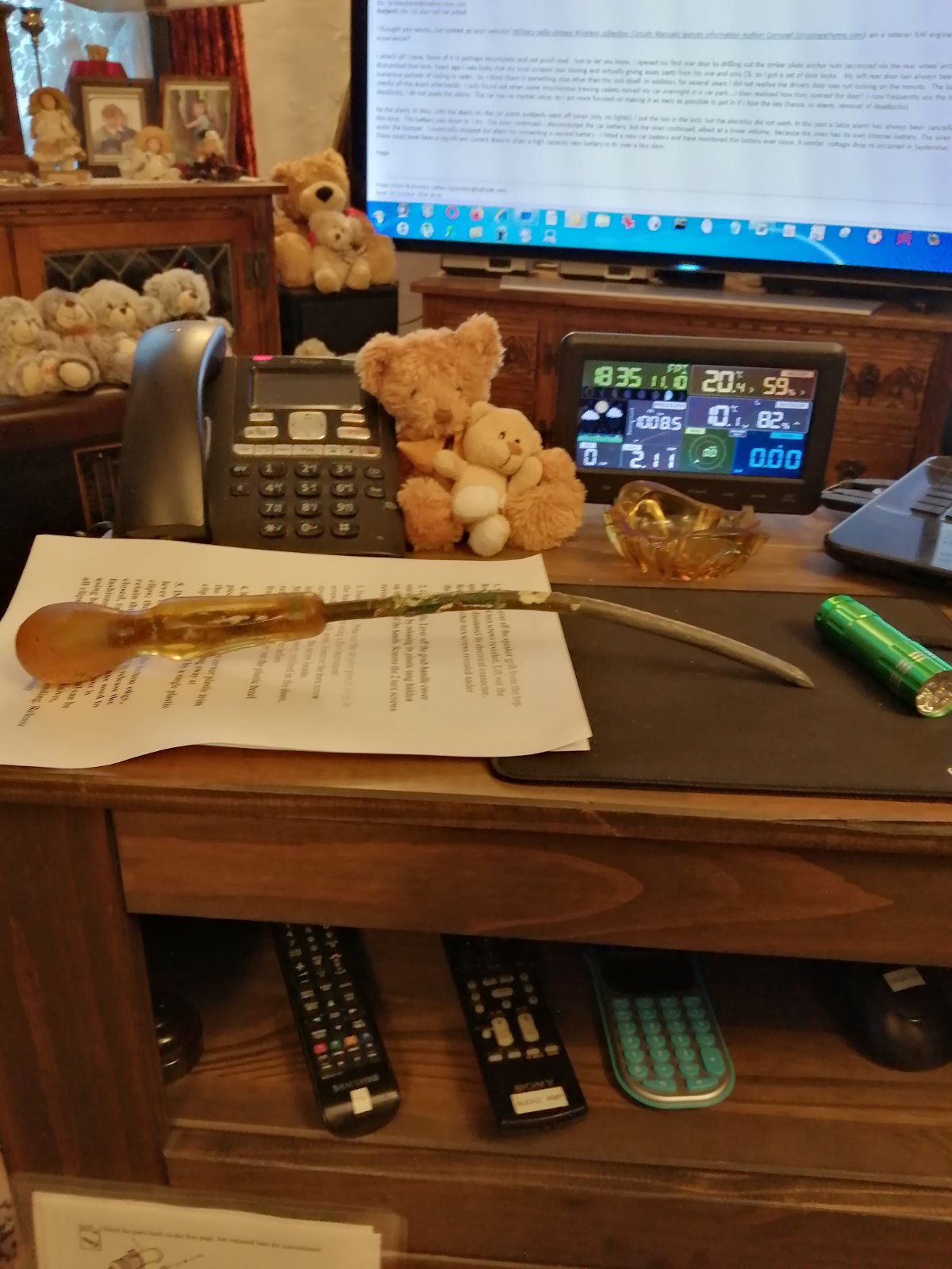

Picture is of my patented screw driver, that worked better for me than diinner knives with the end bent over to pull the door panel off with the door closed : )
The spokes behind the speaker can be griped with mole grips, to pull the door panel away enough to get the screw driver in.
The opposite door can be used to see where the door panel fixing are which gives a better spot to leaver near.
Move the front pasenger seat forward, so that the screw driver has more room to leaver.
