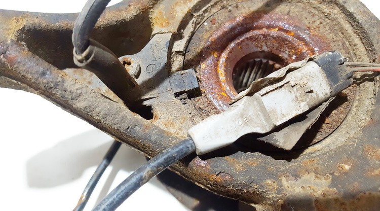

While you have the discs off undo the ABS sensors, and be sure that the surface they mount to is clean and rust free. This might need scraping and chipping at to remove thoroughly.
The area underneath the sensor rusts, and pushes the sensor away fron the magnetic ring. This picture gives you an idea of what it looks like,
Also have a look at the magnetic surface, be sure there's no missing bits.

The Xsara Picasso has traditional type sensors,
A common cause of this issue is the pickup on the front CV joints rust & break meaning the pickup can slip on the joint & cause erratic readings. This in turn can make the ABS activate as it thinks the wheel has locked up.

This has for me been the most common ABS fault on my Citroens.
