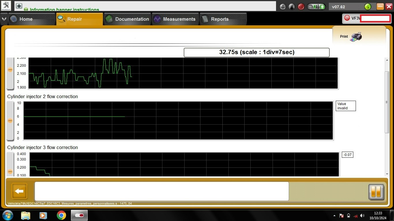

My 2008 Peugeot 207cc 1.6 HDi has a weird fueling issue so I thought I'd have a quick look with DiagBox to make sure the injectors are coded correctly.
While in there I did a live test on the four 'Injector Flow Correction' values.
Not too sure what I'm looking at but 3 of the injectors have what seem to be sensible values in the 0 to 2 range, but injector 2 is returning 'Value Invalid' and is flat lining at 6.
Does anybody have any idea what this means?
Invalid injector correction value

I'm guessing this means the ECU is pushing an extra 6mg per squirt into injector 2 (at idle!) which is then just coming straight back out of the low pressure return.
My leak back test kit arrives soon so I'm suspecting this will confirm that I might need to replace injector 2...

Re: Invalid injector correction value
Now I've learned that the '6' is a reduction. So the ECU is almost shutting down injector 2 at idle as it's leaking so much back to the low pressure return (detected by a lowering of rail pressure maybe)
Gonna do the leak back test tomorrow and I suspect it may be dramatic.

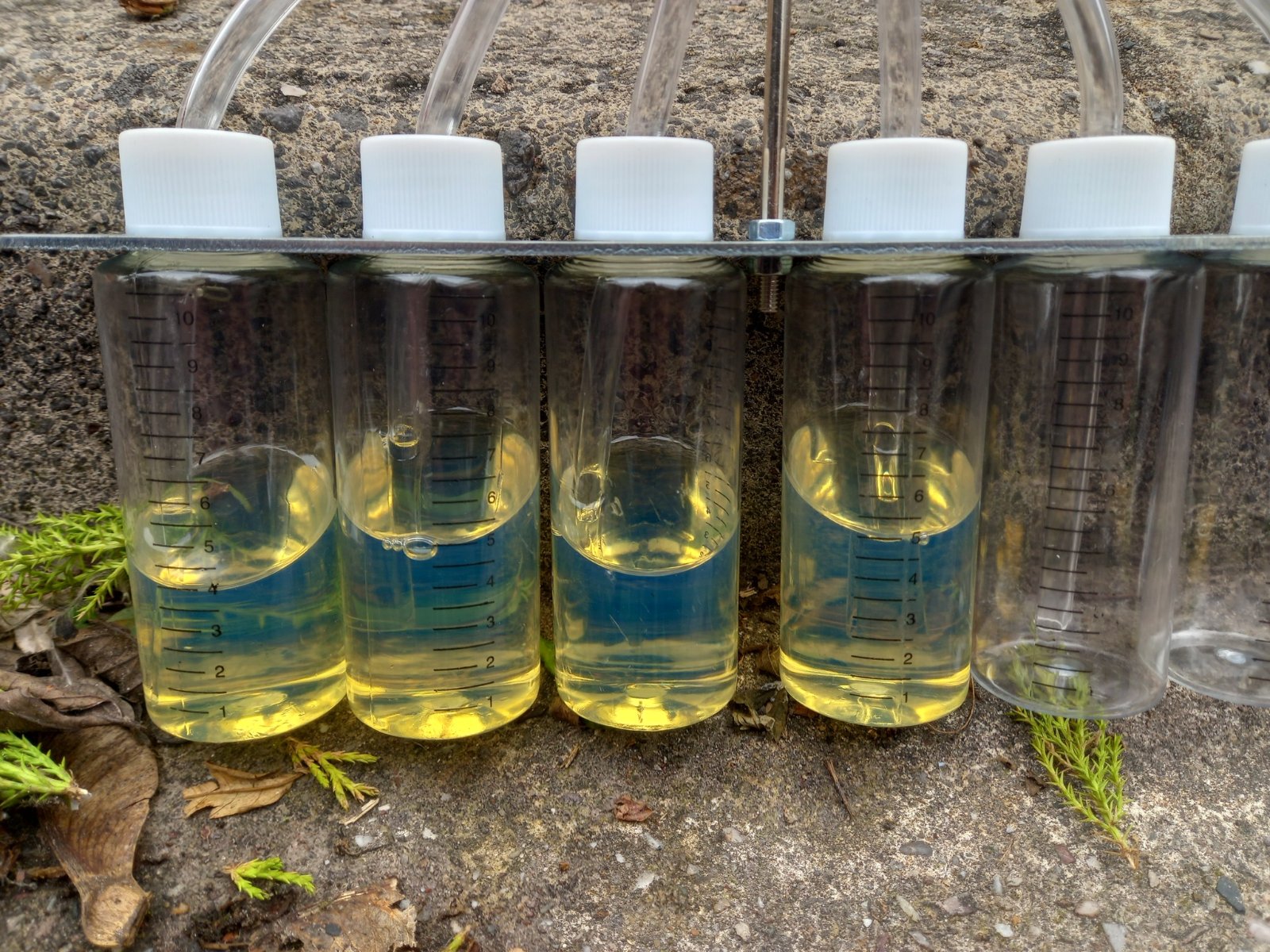

Car has just returned an almost perfect leak back test. Urgh...
So why no smoke?
Only thing I can think of is that the heavy negative adjustment at idle is compensating for the a leak which goes away under pressure. So... leaking pilot jet?
