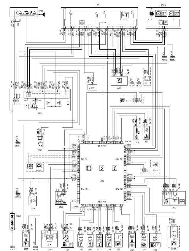

The CAN connection (the thicker wires on the engine ECU in the diagram) is a data bus that passes information & controls around the car. The ECU & the BSI are the 'ends of line' of the CAN (under bonnet side) & im not sure how the ECU will react to not seeing a BSI connected to it. Under normal circumstances the engine wouldn't start without the BSI as the immobiliser functionality is built into the BSI however you have an unlocked ECU.
Have you considered input from the brake & clutch switches? The ECU uses both of these inputs.
What about diagnostics/fault finding? Are you going to integrate a diagnostic socket? How will the ECU let you know there is a fault? There is no output on the ECU for an engine management warning lamp, this is transmitted to the instrument panel via the CAN & VAN.
The TPS is 1261 in the diagram

Is there any possibility of sending me a clearer picture of this diagram at all please?

Re: Berlingo wiring diagrams
Don't worry. I've just put my glasses on. Jeez I'm getting old!

@wheeler
Where can I find the key to the components on the diagram you have posted please?

I've just found the key here. Trying to navigate this forum as a newbie.
The originals are high resolution files, unfortunately the forum blocks us from uploading the original file type as they can be harmful.Skylinenuttergtr wrote: 12 Oct 2024, 08:10 Is there any possibility of sending me a clearer picture of this diagram at all please?
Moderators can upload them.
