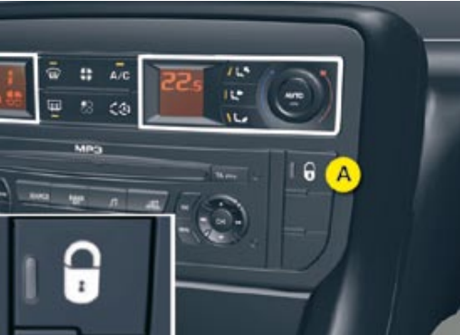

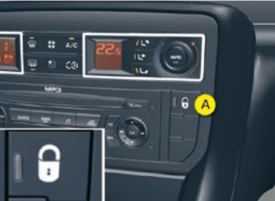

As for the auto locking, there's a feature that you can activate or deactivate. It basically means when the vehicle moves off above about 6 mph, it locks all the doors for you - designed against traffic light theft, where crims will eyeball valuables on the passenger or rear seats, then attempt to open the door, grab your gear and leg it.
It's a feature that I always have on.
To activate or deactivate this feature, you use the central locking button on the dash shown at 'A':
When in the vehicle close the doors and press and hold this button for at least 2 seconds - a confirmation message will appear on the instrument panel display with an audible signal. To deactivate, just repeat.

So just re-activate is using the method I showed and that should be the end of the warning.
Just remember that if you have driven off and come to a stop later (with the engine still running), and say you are picking a passenger up for example, you'll just have to press the locking button shown above once to unlock the vehicle so they can get in.

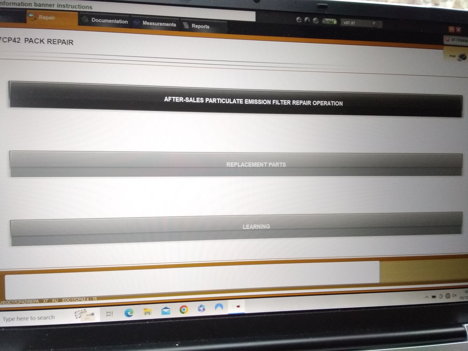

topped up the fluid this morning, poured in the whole 3 litres, and nothing came out the overflow. I've seen a chart somewhere on this forum that says my car has a 3.5 litre tank, I guess it really was empty.
Went through "repair" - "ignition/injection" - "repair pack" - "replacement parts" - "filling of additive tank" -

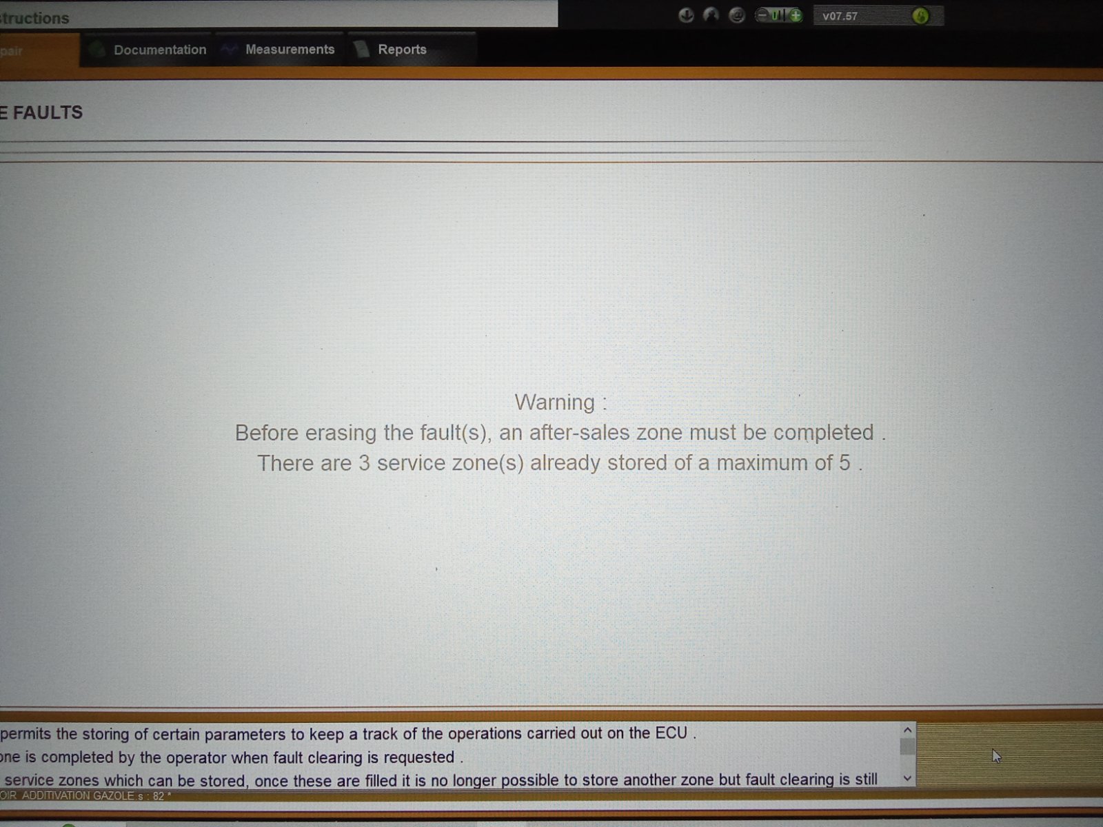

so far so good, then I came to the screen in the pic, which I wasn't expecting. Anyway, followed the instructions, set up "after sales zone 4", although I've no idea what that means ?
But a successful result I think, service light is out, the warning message has disappeared at start up, and even the annoying "automatic door lock deactivated message" is no more.
Thanks for the advice, unfortunately I doubt it'll be the last time I need to ask :-D

x 6955
Re: Particle filter fluid low
Well done - ignore that message in the last screen - it's only for dealer-use and won't affect operations.
