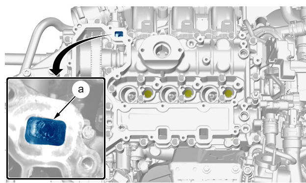

This fault can be the result of destruction of the timing belt along with p0014 if the dashboard warning lamp is also lit.
This refers to a C3 Aircross with the EB2ADT Engine with fault codes P0011 and or P0014 and is quite detailed, so may assist with something you missed (grab a coffee):
The following checks should be made:

Remove the upper and lower cylinder head covers.
Additional parts which must always be replaced: None.
In addition, carrying out this repair requires the following operations to be carried out:
(Note: I don't have the video referred to below!)
If the result of the check on one of the crush points (measurement of the size of the red spots crushed in the video using the image below) does not conform: Carry out repair 7 (Replacement of the engine).
If the result of the check on all of the crush points (measurement of the size of the red spots crushed in the video using the image below) conforms : Carry out repair 6 then check 4.
- Observe the safety and cleanliness recommendations
- Perform the operations that are required prior to a disconnection of the ancillaries battery
- Remove the ignition coils
Refit the upper and lower cylinder head covers.

Re: Ds3 1.2 puretech timing belt? Other?
From my experience the problem with oil starvation will be visible on the marked camshaft. Apparently oil is going thru variable timing solenoid valves to the camshaft (arrows) and the weakest point is circled. Bearing might be sized or even some deposits on the camshaft If your wet cambelt started shedding rubber bits to the oil sump, it might block oil supply chain hence problem on the top of the engine
