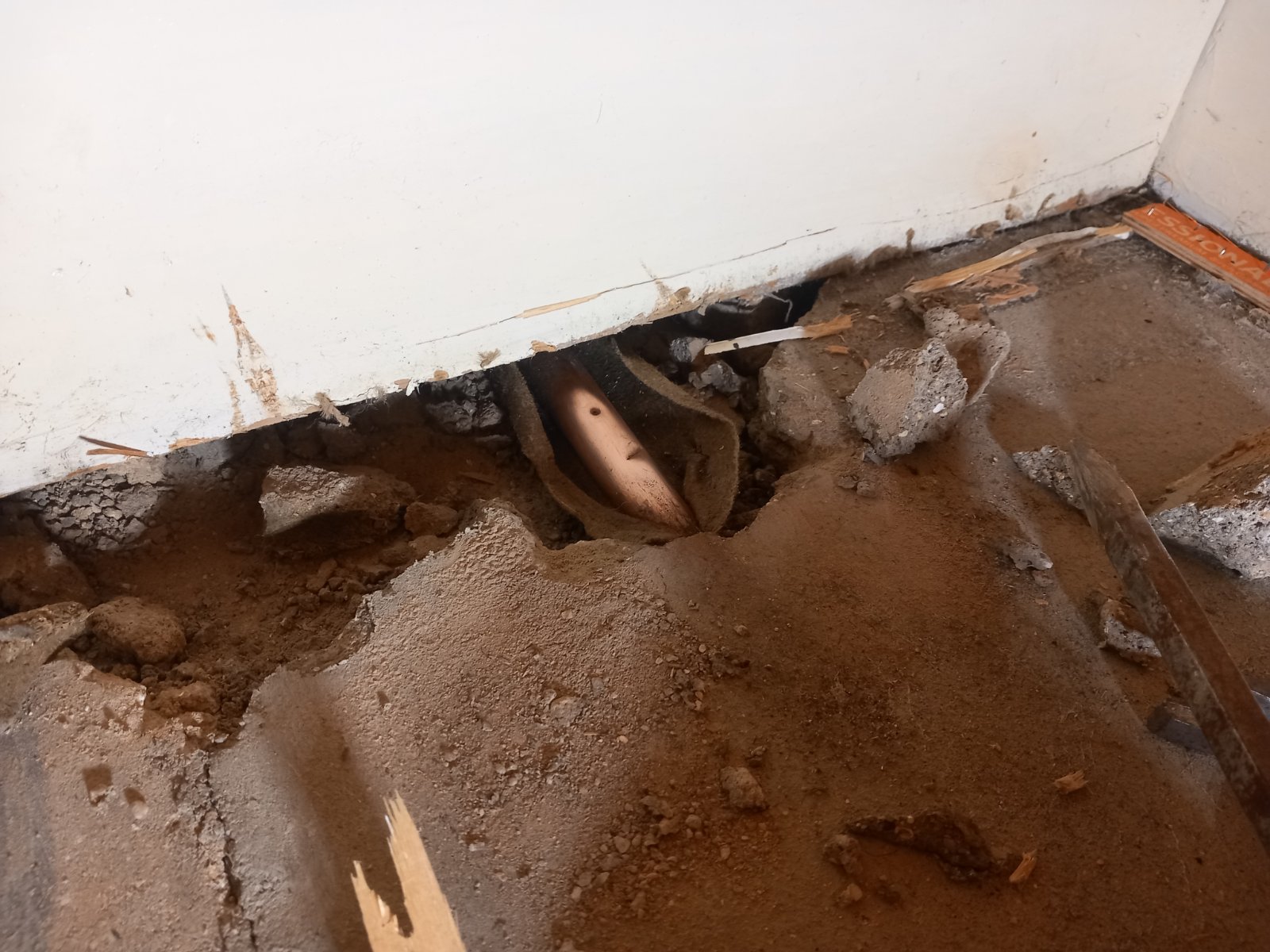

Yesterday, I finally found a person who could and in advance of a visit today I dug up the pipe. It was about 3/16" below the screed and perfectly pierced by a carpet griper nail as predicted...
Gas is still off and this morning I noticed I woke up to no funny vaguely gearbox oil smells!
I guess the engineer will chop out the damaged section of pipe and splice in a new bit...
I was so lucky my house didn't make a news headline: 'Mystery explosion destroys house in Paggers and makes several neighbours homeless'
I think I'll do the lottery tomorrow. I must have a top quality guardian angel looking after me

A lucky escape Jim - good to see the old pipe was wrapped to stop the cement degrading the copper pipe
Lucky you could smell it and what a shot by the gripper fitter

I'll second Skull's comment on the wrapping and I'd suggest covering the repaired pipe with a stainless steel plate where the gripper is going to be refitted - just in case!!

Yes, looks like thin Denso Tape... Good plan on additional armour before it's re-screededmickthemaverick wrote: 04 Oct 2024, 09:18 I'll second Skull's comment on the wrapping and I'd suggest covering the repaired pipe with a stainless steel plate where the gripper is going to be refitted - just in case!!![]()
