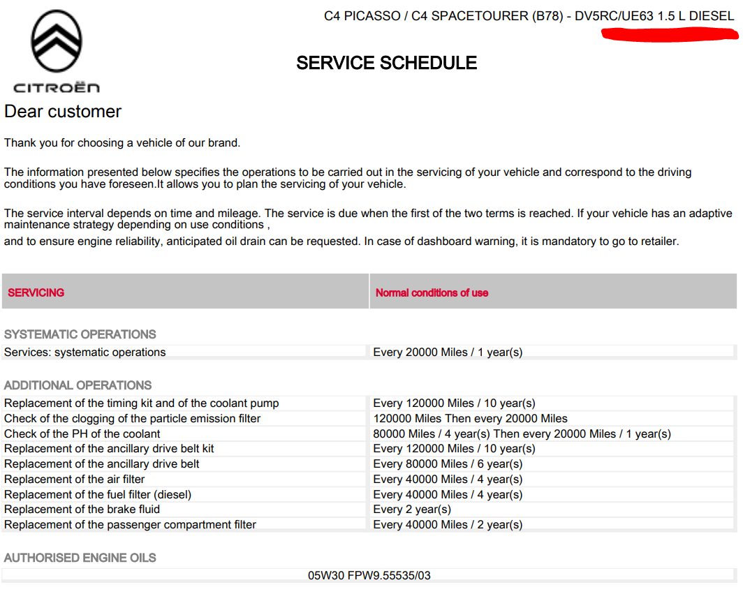

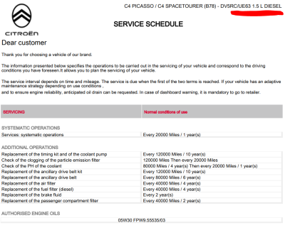

That's all they will give you unless you were the original customer when the service was done, where you could request a copy invoice - but they won't provide these to you for reasons of privacy and confidentiality as they will have the previous owner's details on.
You'll just have to accept that the dealer's stamp warrants that the servicing has been carried out properly to the correct requirements and intervals.
If you want to know the main servicing operations, provide your VIN for me. Please post your VIN in full without spaces - it will be automatically masked from public view after submitting your post & will only be visible to staff.

Okay back after a good nights kip. Grandkids are great but they are hard work. Anyway my VIN, VF7**************[VIN obfuscated, can be read by forum staff]. Thanks for your time.

Re: Service history.
Click or double-tap Image to Zoom
