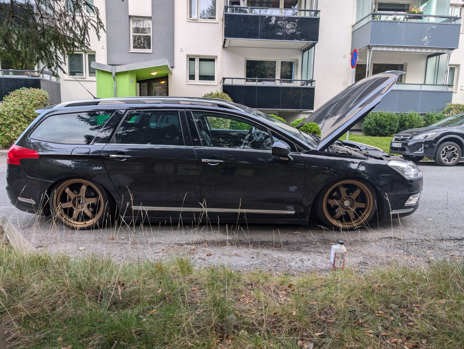

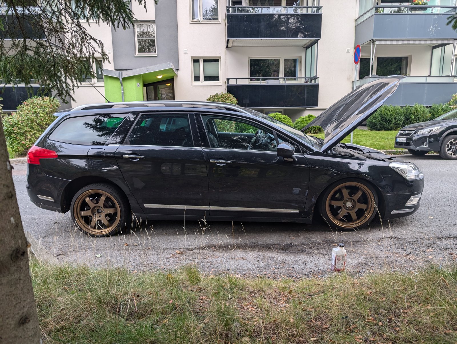

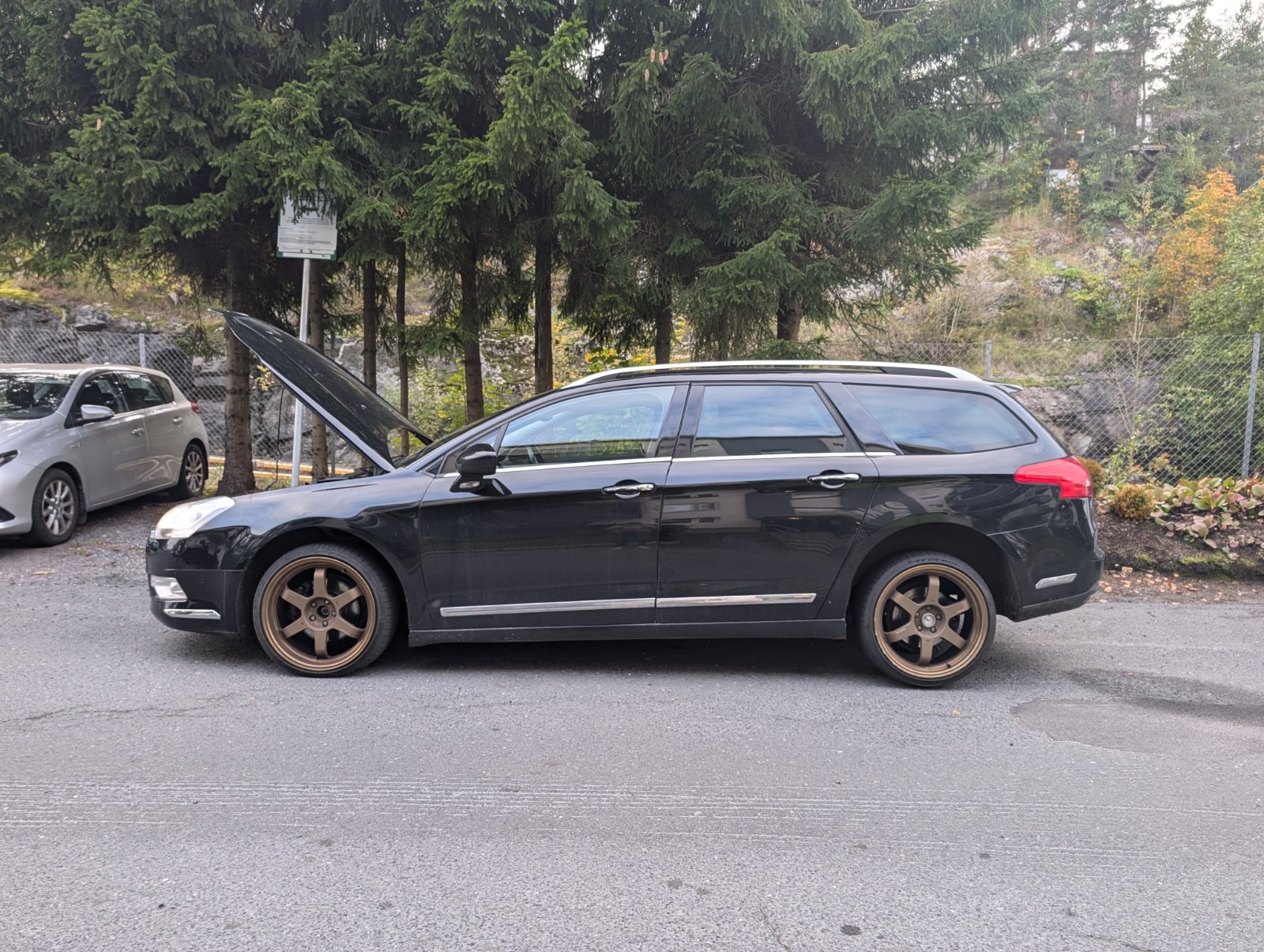

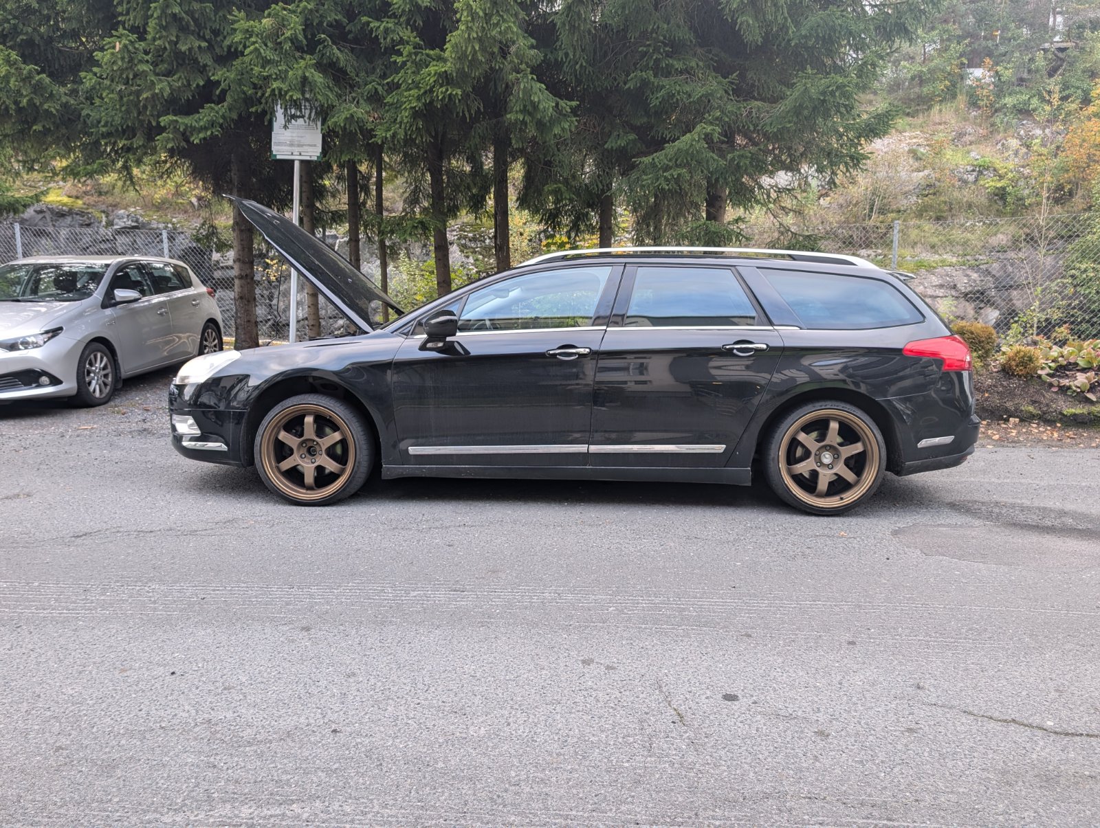

Added pictures showing each side raised and lowered. Notice the right side and especially the front right.

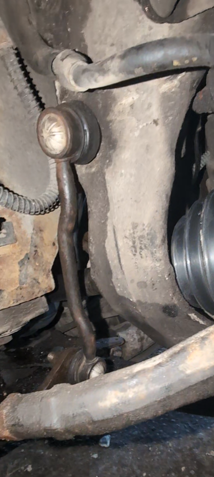

That is strange behavior, can you rotate the steering to allow you to look under the wheel arch? I wonder what condition the anti roll bar drop link is in. It is the only structural aspect I can think of that might allow one front side to be lower. Possibly also the anti roll bar bush at either end of the sub frame. Can these be viewed? Just to eliminate them from the investigation. Make sure the car is solidly supported before reaching in the wheel arch in case there is a serious structural failure.

They were replaced just 1,5 years ago and look fine. I checked underneath earlier today when this happened. See attached picture.
