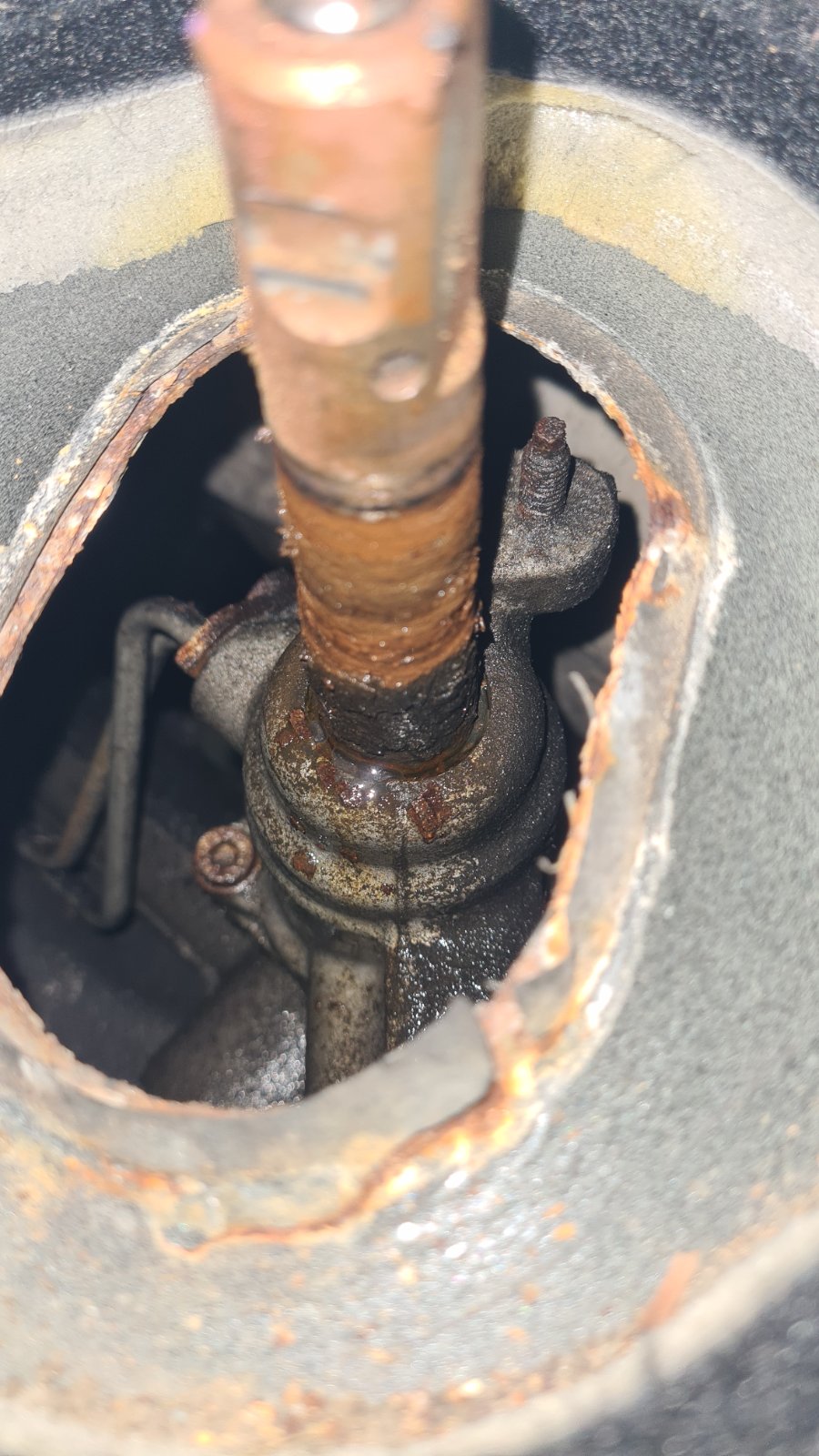

If the steering rack, you should be able to see it by looking through the steering column hole in the floor after removing the plug. If the pinion looks rusty with fluid in the surrounding area, then that will likely be the start of the rack seals going.

My bet is the rack, struts tend to leak "a bit" for a long time and the wheel arch gets wet, tanks normally just do not let go unless the car has been jacked up/worked on....
The racks leak onto the under-tray and run/blown down/across to drip inside/rear by the drivers side wheel. It can collect there for some time in small drips but when they go they start to flow a lot more.

It's 100% steering rack.
I guess it wasn't leaking that badly before so that when it was parked up there was no visible marks on ground as the under tray caught it and driving must have emptied the pool.

Why ?....simple = because it is a really S@@t design from Citroen using equally sh@t materials for the shaft.
A LONG thread but worth a read https://www.frenchcarforum.co.uk/forum/ ... ering+rack

I checked the rack about 2 years ago, and it was bone dry and no major corrosion.
I still covered it in grease as a precaution. Guess the salt and snow on the roads got to it in the end.

It needs doing every year (grease,,, however I switched to Bilt & Hamber underseal and a boot)....or a boot needs to be fitted....as done by a number of people in that thread.

Ah, yes many of us have been here. In the short term you can save the amount of LDS lost by putting the car on high suspension and leaving it parked during the day. The leak in the steering is at the lowest point in the system and causes the LDS tank to leak out vie the steering leak but if the car is left on high there is a lot less LDS left in the tank to drip out - it's all stored in the suspension. I did this for a few weeks until I got the steering rack swapped. I went to the place in Wakefield - they've done lots of C5s. very quick turn around and they replace the pipe too with a modified Berlingo pipe. Only complaint was a couple of weeks later I noticed the flexi part of the steering pipe you can see above the track rod gaiter on the near side, was routed and rubbing heavily on the steering gaiter. Glad i noticed it. I don't know if this was caused by the use of the berlingo pipe or not but I used a thick zip tie to holt up up a bit and it has been fine ever since. I was not going to take the car back to Wakefield because I live in Glasgow and it wasn't practical. It is still holding out now after 19 months. My first refurb rack lasted less than a year and leaked again. I did fit a rubber gaiter to that over the shaft but it didn't help for me. Others have had better success. I am now just regreasing this annually so hopefully will hold out.
