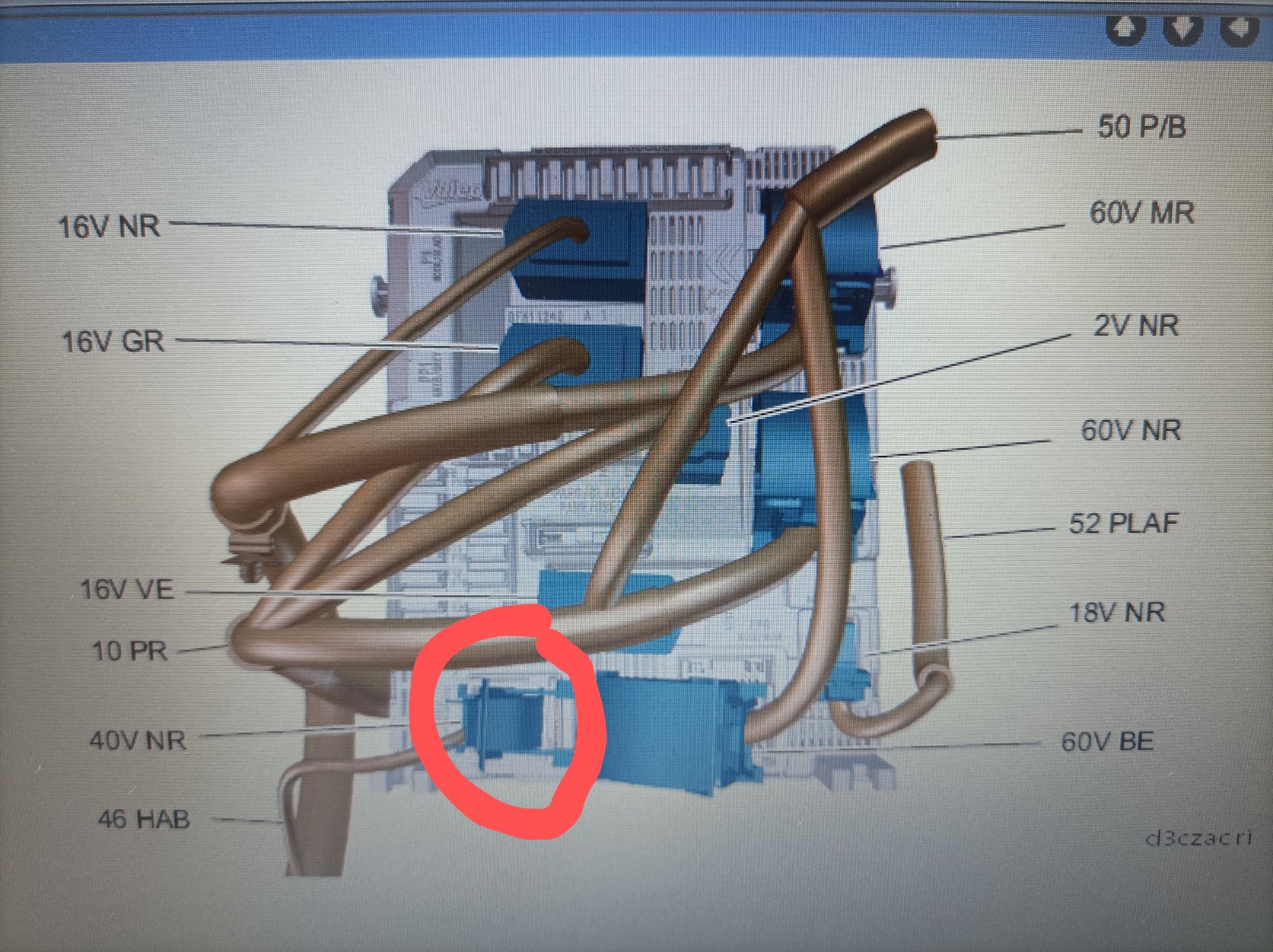

As above really, I am hoping somebody might be able to tell me if there should be something plugged into the EH2 NOIR/BLACK socket on my BSI.
I am having all sorts of issues and I am wondering if it could be related to this. I can't see a plug anywhere. Any information would be appreciated!

This is the plug in question. I am assuming from this that it is missing but please let me know if you think different. I am still learning how to use sedre

So the 40V NR is a 40 pin black connector and so won't show up as it's not a harness. This being the case, if it's not there then I suspect it's not supposed to be and is likely for equipment you don't have.
