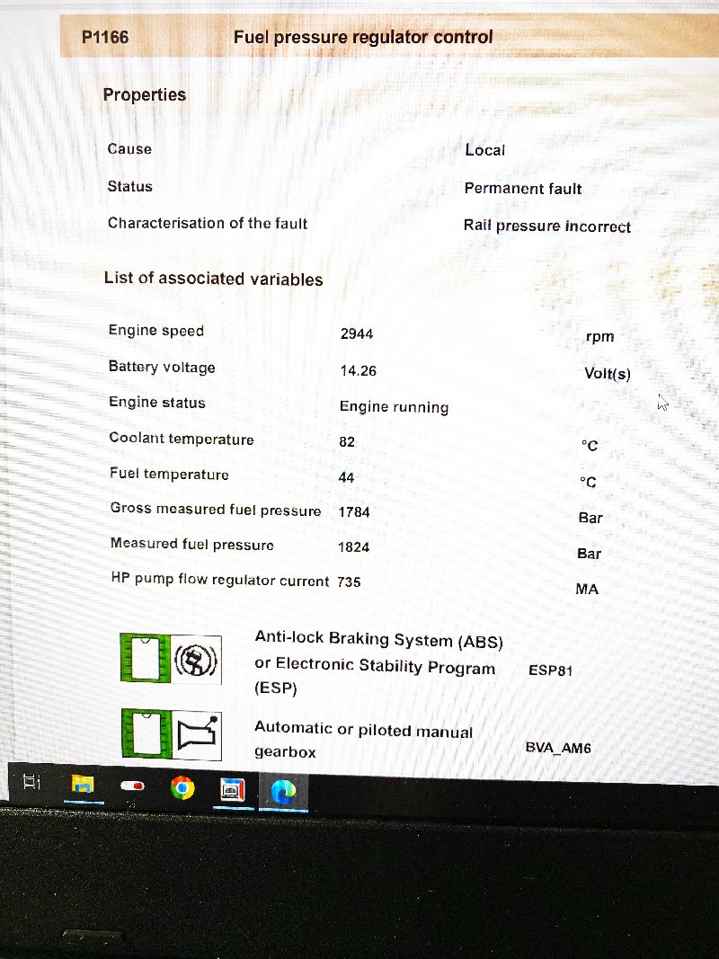

So the time has come to work out what is wrong with my 2009 C5 X7 (2L 138) that keeps throwing a P1166 code that puts it into a limp (ish) mode every time I use kickdown to overtake.
Can anyone give me an idea where to start please?
Is it too high or too low a pressure?
Should I start with the HP fuel pump or is there a Fuel Pressure Regulator somewhere?

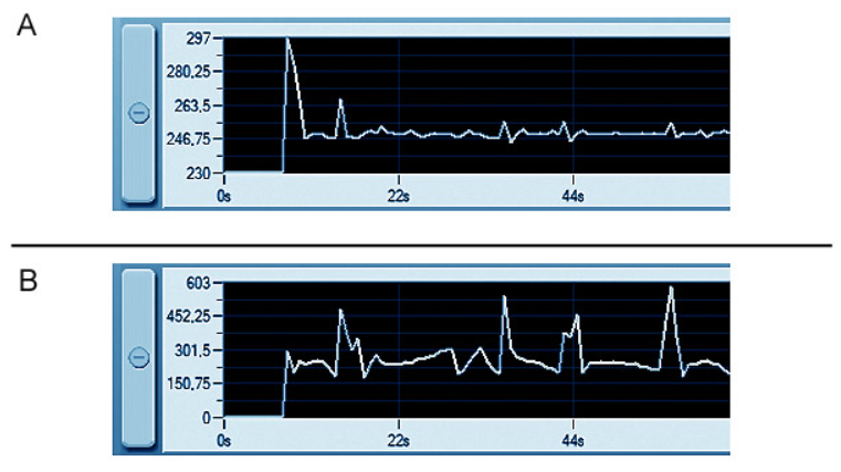

There's a known fault for this engine (DW10BTED4) with any of the following codes present: P0088, P1166, P0181 or P0183):
Symptoms are a flat spot on acceleration, or the engine stalling, unstable idle speed or hesitation (particularly when cold with engine speed between idle and 2000 RPM).
Action is to replace the high pressure fuel pump pressure regulator where necessary.

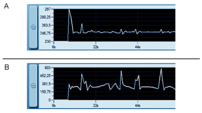

A dealership with Diagbox would confirm by the following checks. You seem to have Diagbox, so just run some live tests of the engine ECU and look specifically to find the 'measured fuel pressure' parameter or choose customised parameters and select it yourself. It should provide the output in the form of a live graph for you as the engine is running. Compare to the chart below:
"A": Signal conforms.
"B": Signal does not conform (Significant fluctuation).
- Start the engine and let it run at idle.
- Check the "Measured fuel pressure" signal using the diagnostic tool:
- If the signal fluctuates significantly (Fuel pressure unstable) (Figure "B"), replace the high pressure fuel pressure regulator.
- If the signal does not fluctuate significantly (Fuel pressure stable) (Figure "A") do not replace, but continue with other diagnosis.
There should be any other codes apart from one or more of those listed above present (apart for the common glow plug faults), so deal with any other faults first.

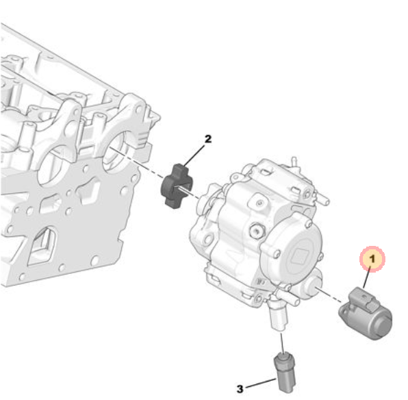

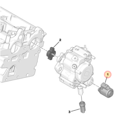

(1) Regulator, part: 193339, £215.41
Let me know when you are nearer to replacing it and I'll put a guide together.
