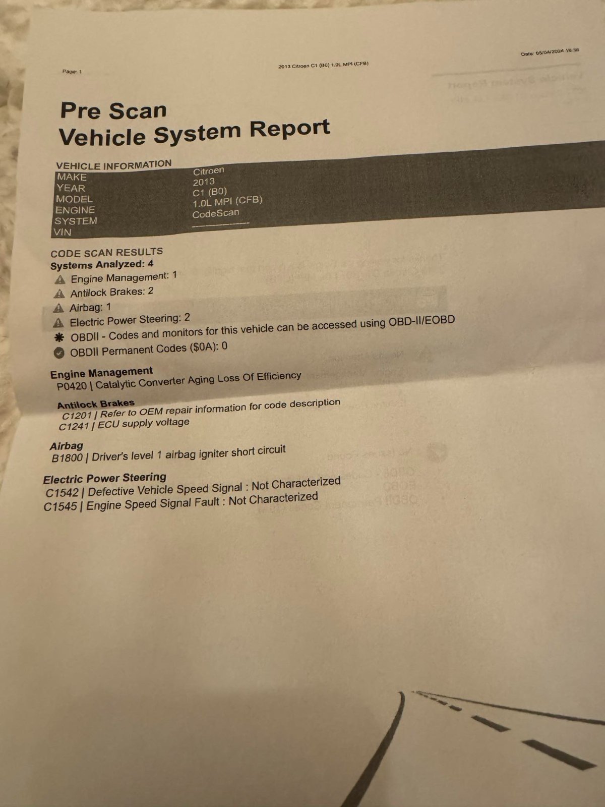

Hi All.
Daughters C1
EML came on, a while ago Catalytic faults, a ahrd drive and it went, then she got the ESC light on, i had a scan done with a code reader:
Any ideas where to start? Garage who did the scan said take it to an auto electrician....
Thanks

Re: Citroen C1 63 plate obd11 faults
There's no further info for this vehicle, being a Toyota, so I can't really help, except to say that many of these issues can relate to the wheel speed sensors, as this info is used for lots of systems. The codes are very limited and don't expand on this - so I'd probably recommend you get it to the dealer as they'll have a better understanding from their diagnostic data.
