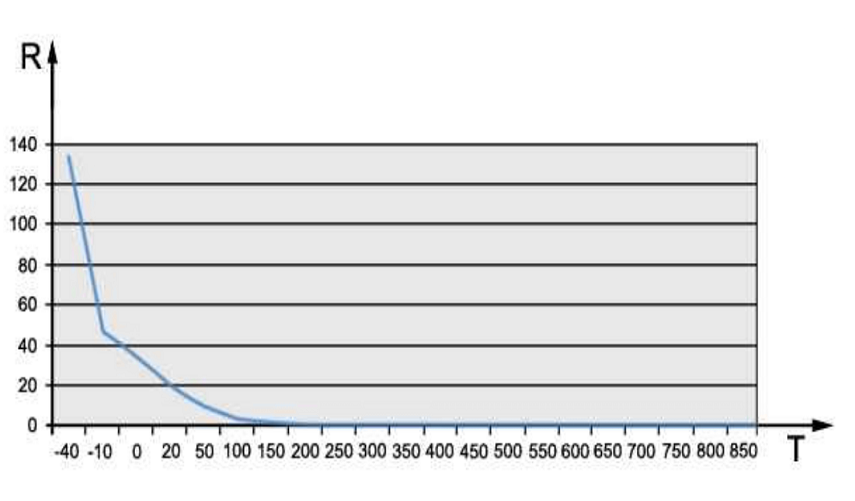

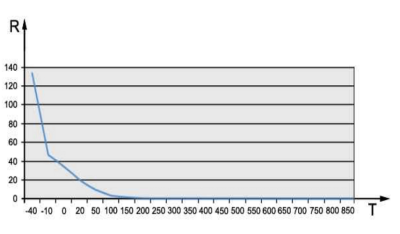

The exhaust temperature sensor is a resistive type sensor with negative temperature coefficient.
Once the temperature hits over 160 °C, the drop in resistance is very small the hotter the temperature is:
So I guess you should be able to see if the resistance corresponds to the temperature in the readings below (at least from a starting point of 10 °C upwards) until it reaches say 90°C, near operating temperature and see if the corresponding resistance in rows 4, 5, 6 & 7 change accordingly.
| Minimum value (°C) | Temperature (°C) | Maximum value (°C) | Resistance R (In Kohms ) |
| -50 | -40 | -30 | 133,8 |
| -20 | -10 | 0 | 46,76 |
| -10 | 0 | 10 | 34,49 |
| 10 | 20 | 30 | 19,86 |
| 40 | 50 | 60 | 9,748 |
| 90 | 100 | 110 | 3,770 |
| 140 | 150 | 160 | 1,802 |
| 190 | 200 | 210 | 1,001 |
| 240 | 250 | 260 | 0,616 |
| 290 | 300 | 310 | 0,412 |
| 340 | 350 | 360 | 0,293 |
| 390 | 400 | 410 | 0,218 |
| 440 | 450 | 460 | 0,168 |
| 490 | 500 | 510 | 0,134 |
| 540 | 550 | 560 | 0,109 |
| 590 | 600 | 610 | 0,090 |
| 640 | 650 | 660 | 0,076 |
| 690 | 700 | 710 | 0,065 |
| 740 | 750 | 760 | 0,056 |
| 790 | 800 | 810 | 0,049 |
| 840 | 850 | 860 | 0,043 |
