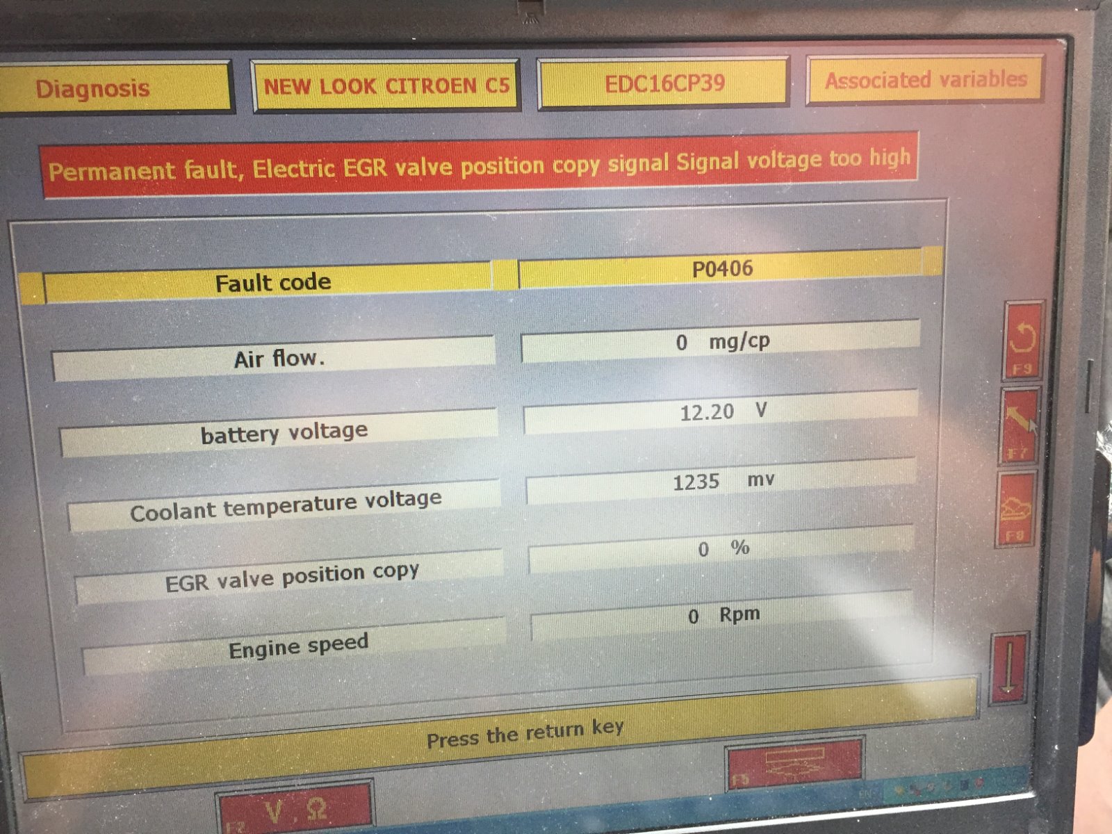

I will add some Lexia screenshots.
This is the air live data
It also comes up with speed control fault.
One of the faults listed is EGR throttle fault. Not to be confused with EGR valve. I assume this is at the throttle port?
I found a section on Lexia that activates replacement EGR valves but this just raised false hopes.
Here is the persistent Lexia fault screenshot
Here is the Electric EGR valve repeat signal fault.
Fault details permanent fault P2100
Fault details P2111 permanent fault
Fault details P0406 Permanent Fault
