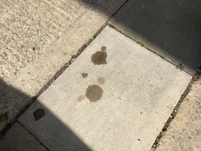

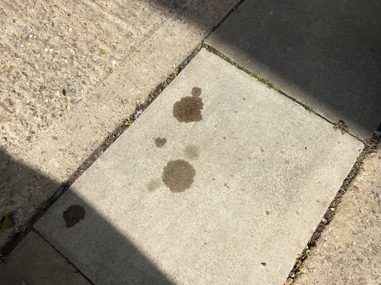

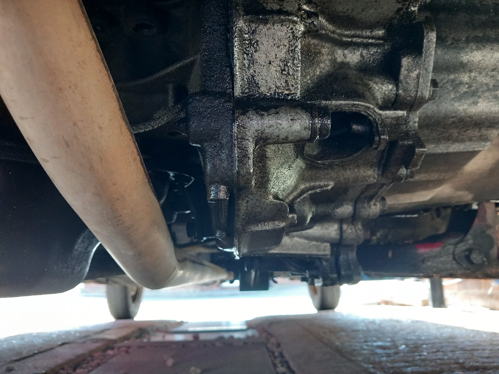

I have a big job coming up on Strawberry... She's a little incontinent :(
I really cannot tolerate even the tiniest of leaks so it must be sorted...
It looks like the rear crank seal. Not an uncommon problem. Definitely engine oil...
It'll be a gearbox off job so I'm may as well do the clutch at the same time...

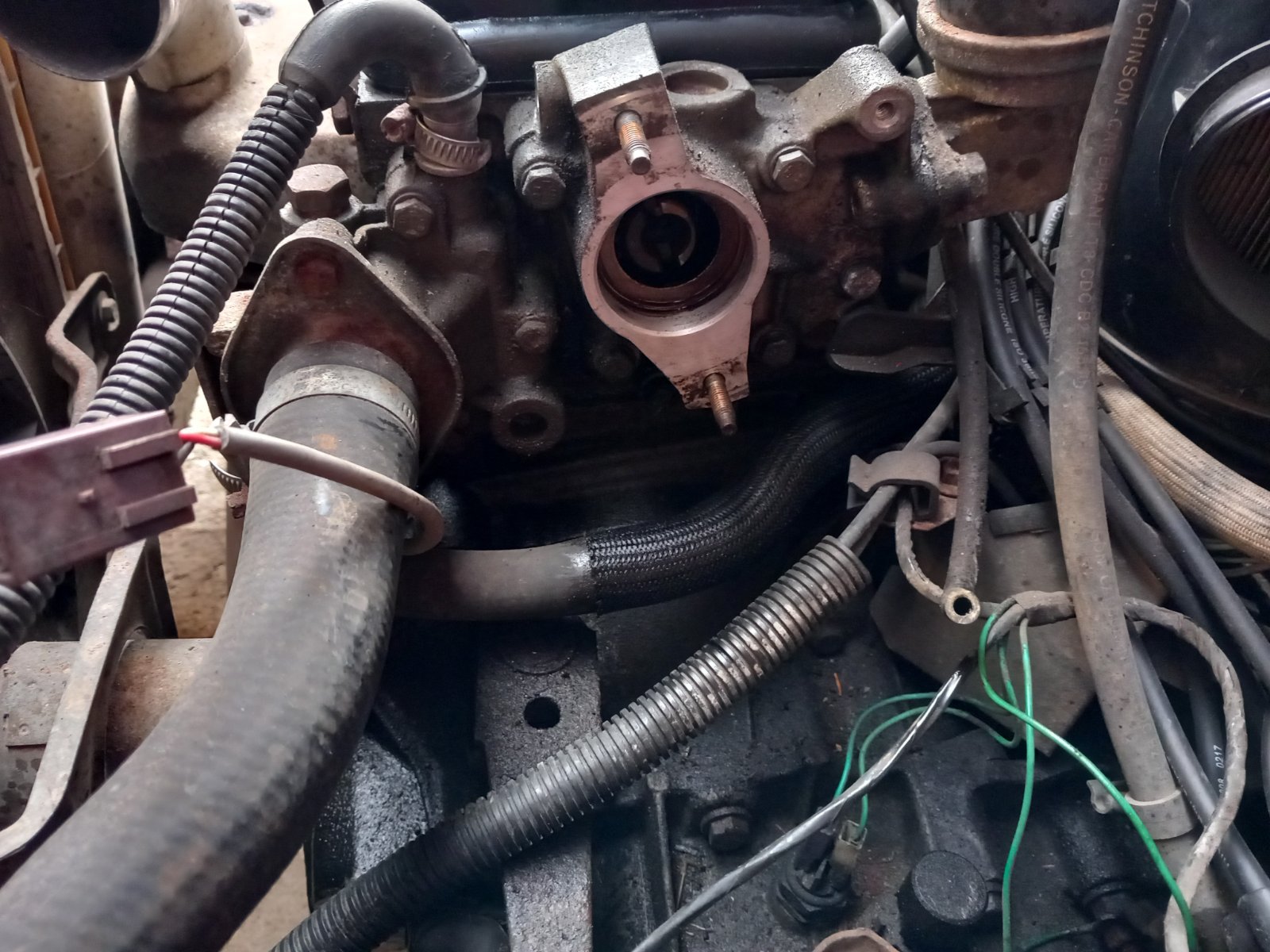

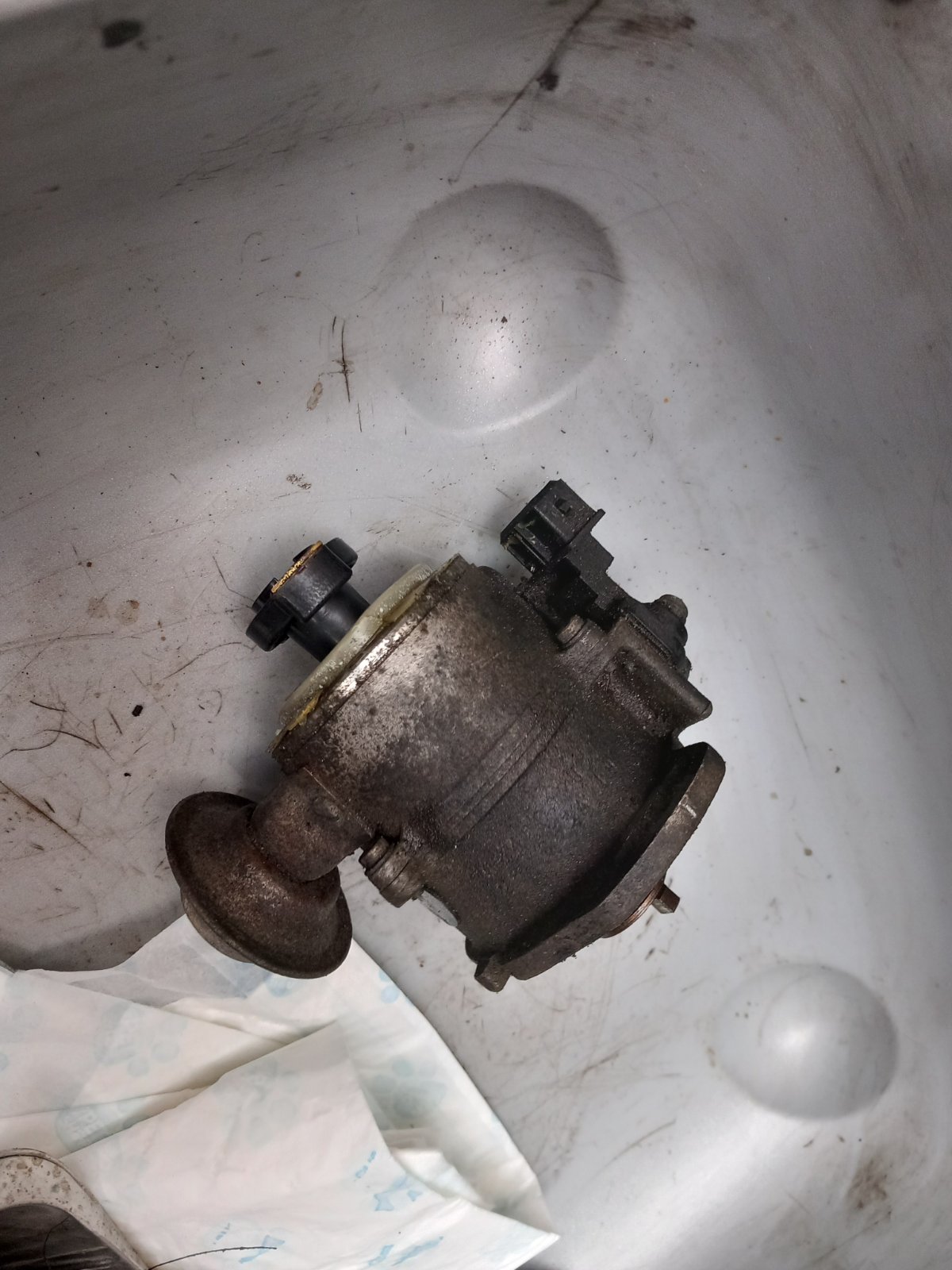

In search of the source of Strawberry's oil weepage, I removed the coil and distributor and found oil just about everywhere :twisted:
These photos do not do it justice...
Even the distributor and ignition module was covered...
Interestingly, she's quite recently had a new distributor cap and new plug leads... Likely the old ones were so covered in oil the only solution was to replace...
Loads of time was spent degreasing and cleaning up using clutch 'n' brake cleaner - the only solvent I can tolerate - and the airline. All the old muck was very effectively collected in puppy training pads; something I'm very grateful for Alasdair recommending them to me and dragging me into B&M or wherever it was to buy a pack of 100 for a tenner... They work a perfect treat :D
Now all is clean and shining like Bristol bacon so in theory the source(s) of the leak(s) should be very easy to determine over the next few days...

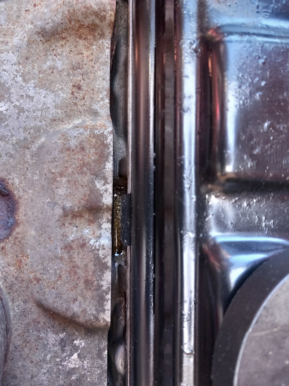

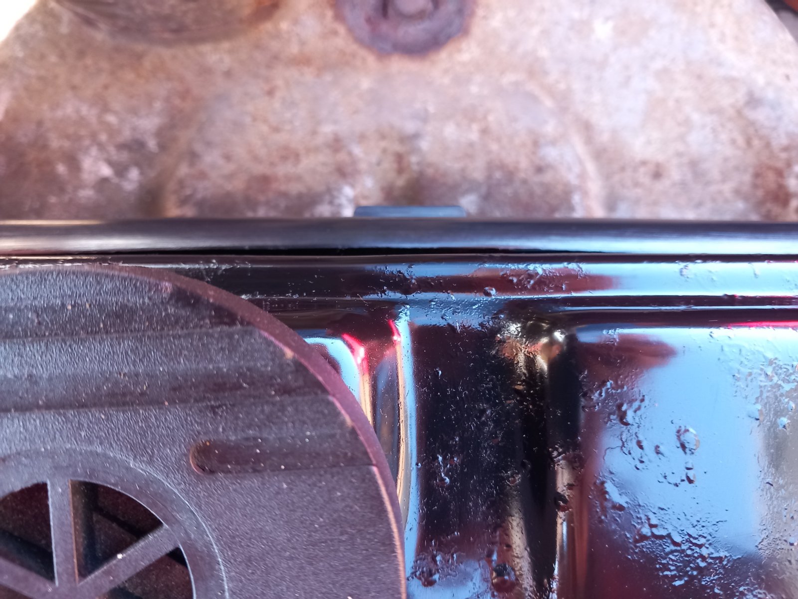

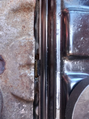

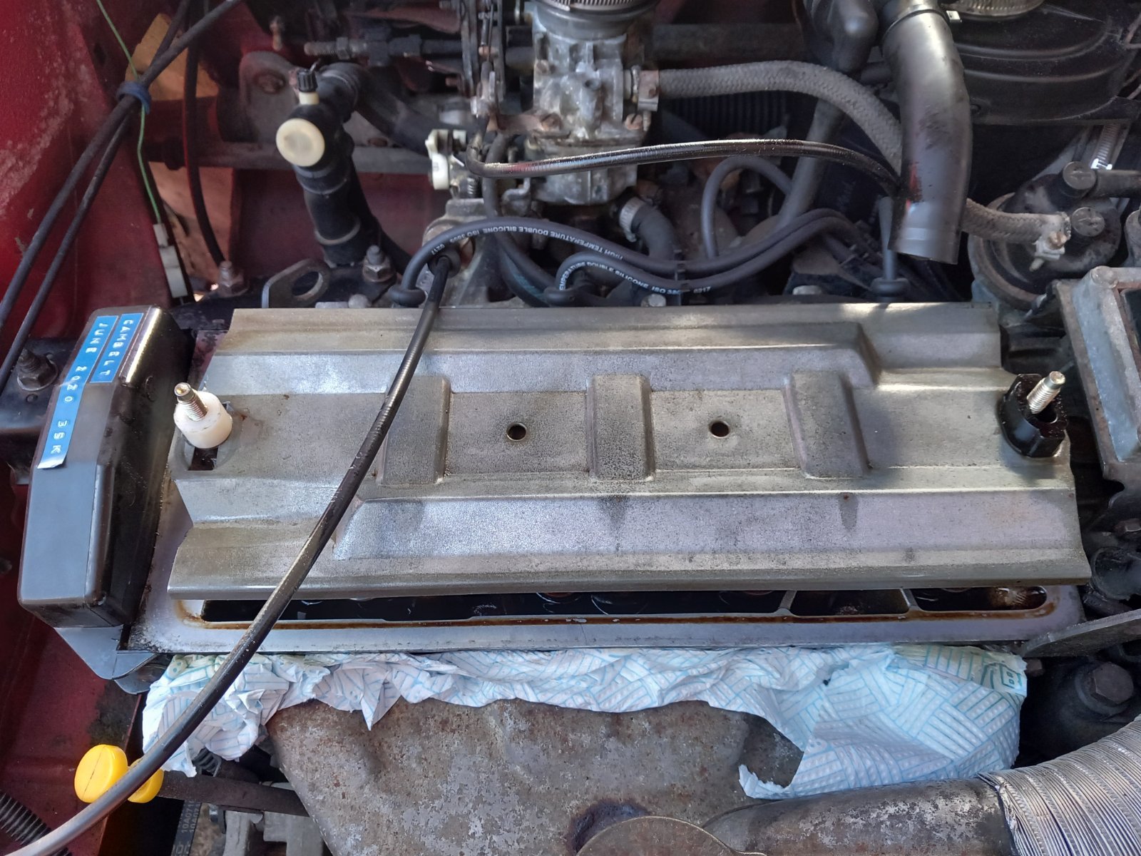

Strawberry revealed at least one leak overnight - out of her rocker box along the line where oil pools along the gasket...

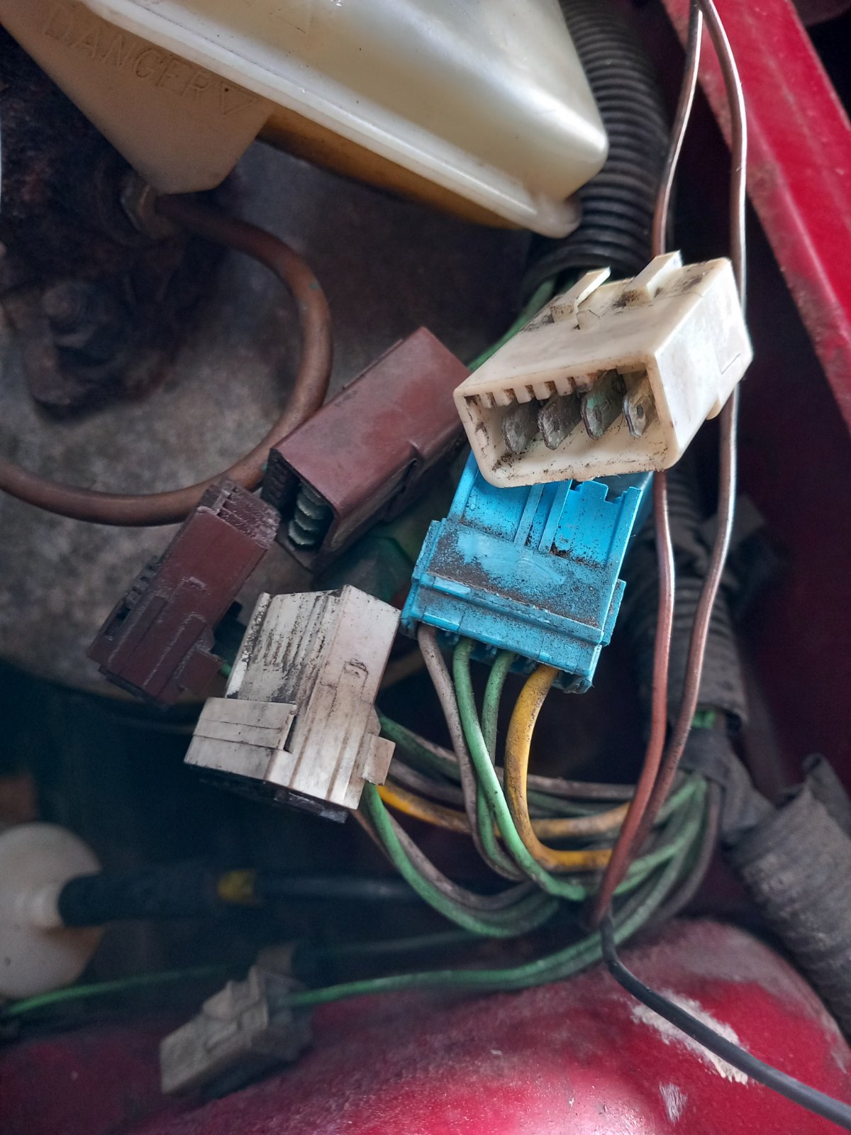

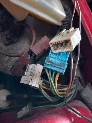

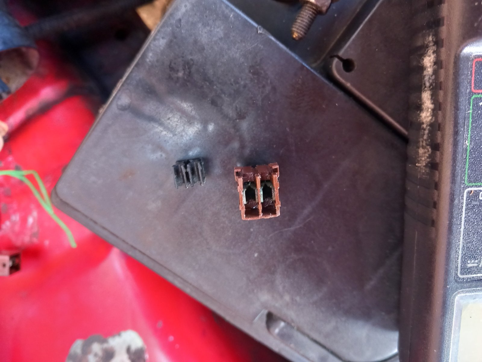

Before looking further at that I thought I'd warm-up by fixing her left front indicator which again failed late yesterday after all the disturbance from the oil cleaning..
I immediately went to the connector that seemed to be the cause last time. I disassembled it as far as I could, gave it a good clean and reassembled. I also found, during the process, ACF50 rust treatment fluid is good on corroded electrical contacts ;)
But it wasn't the cause of the problem... It was in fact the brown connector up by the brake servo. Well tarnished... In fact, all three were.
All the bulkhead connectors were given a good clean with proper contact cleaner and after reassembling the two-pin downstream connector, all is now good... Fingers crossed... Citroen electrics at their 'finest' so who knows :twisted: :lol:

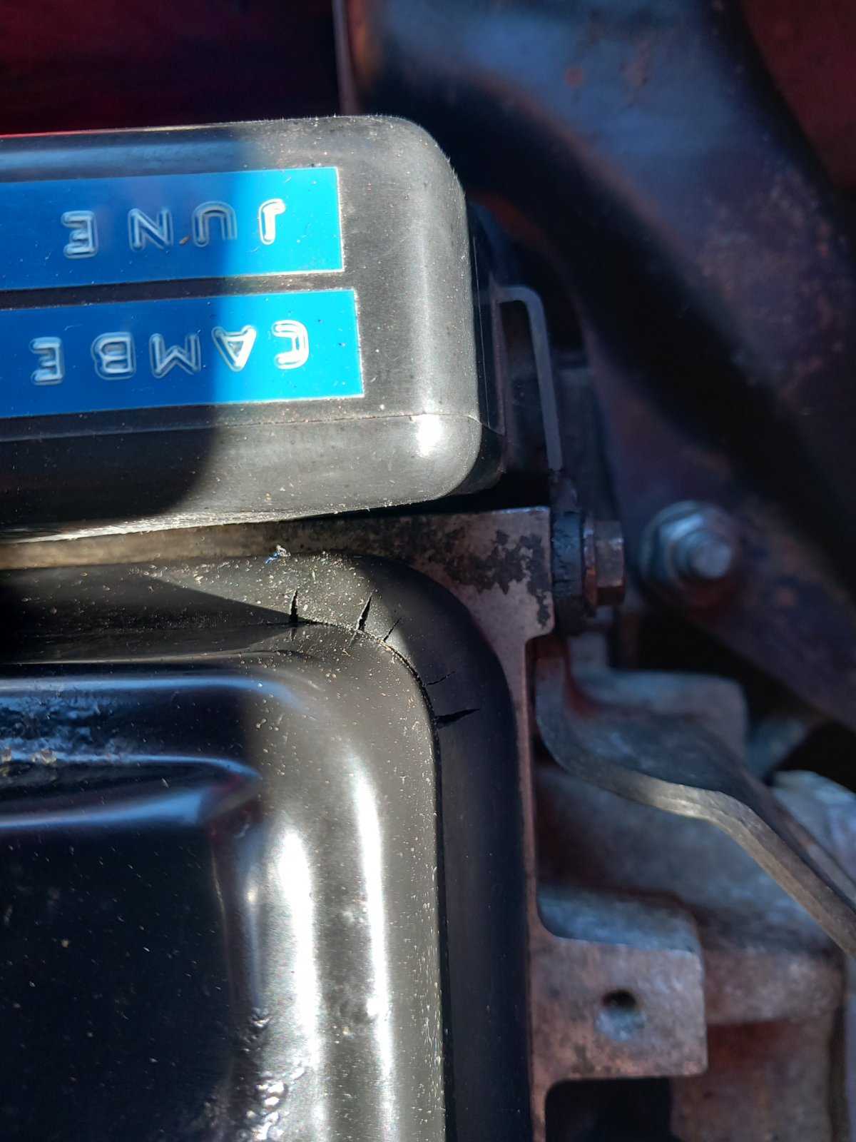

Onto the the leak(s). When I checked the valve clearances I thought the rocker box gasket was good to be re-used as these top cracks are not really a problem...
I had a new one in stock so thought I'd swap it anyway... Then I found the root cause, something I missed when I checked the valve clearances...

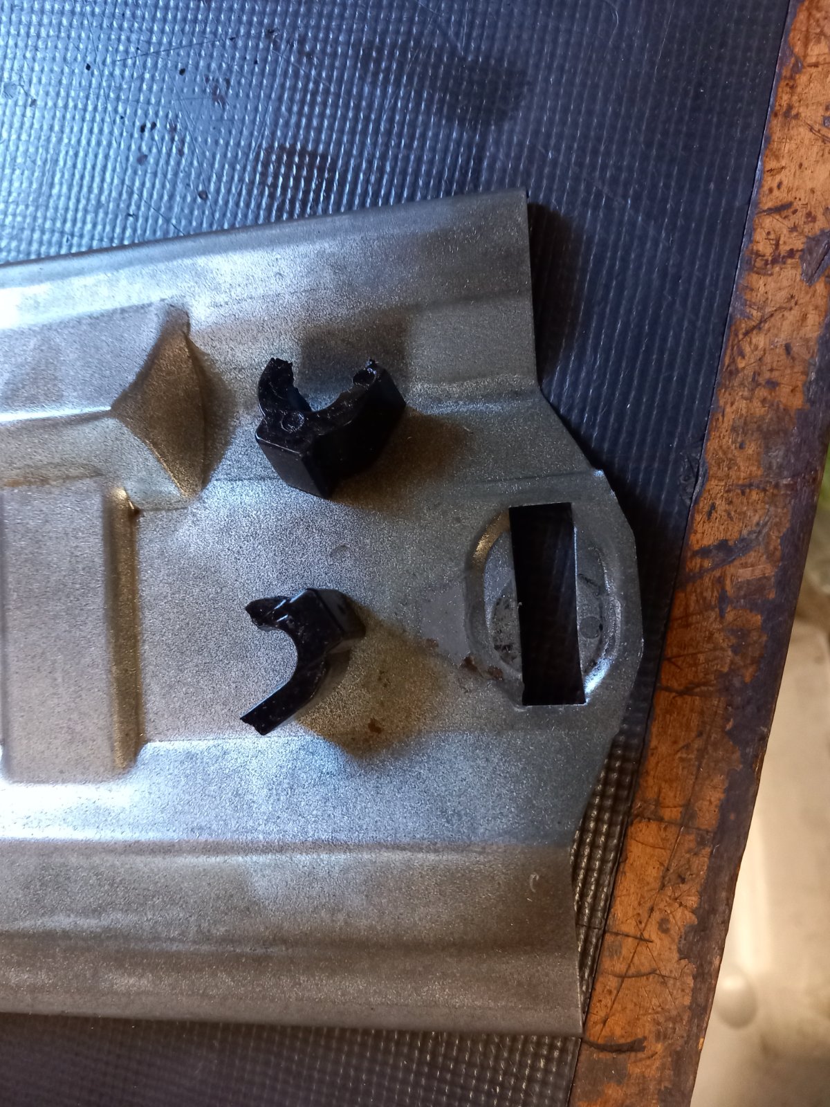

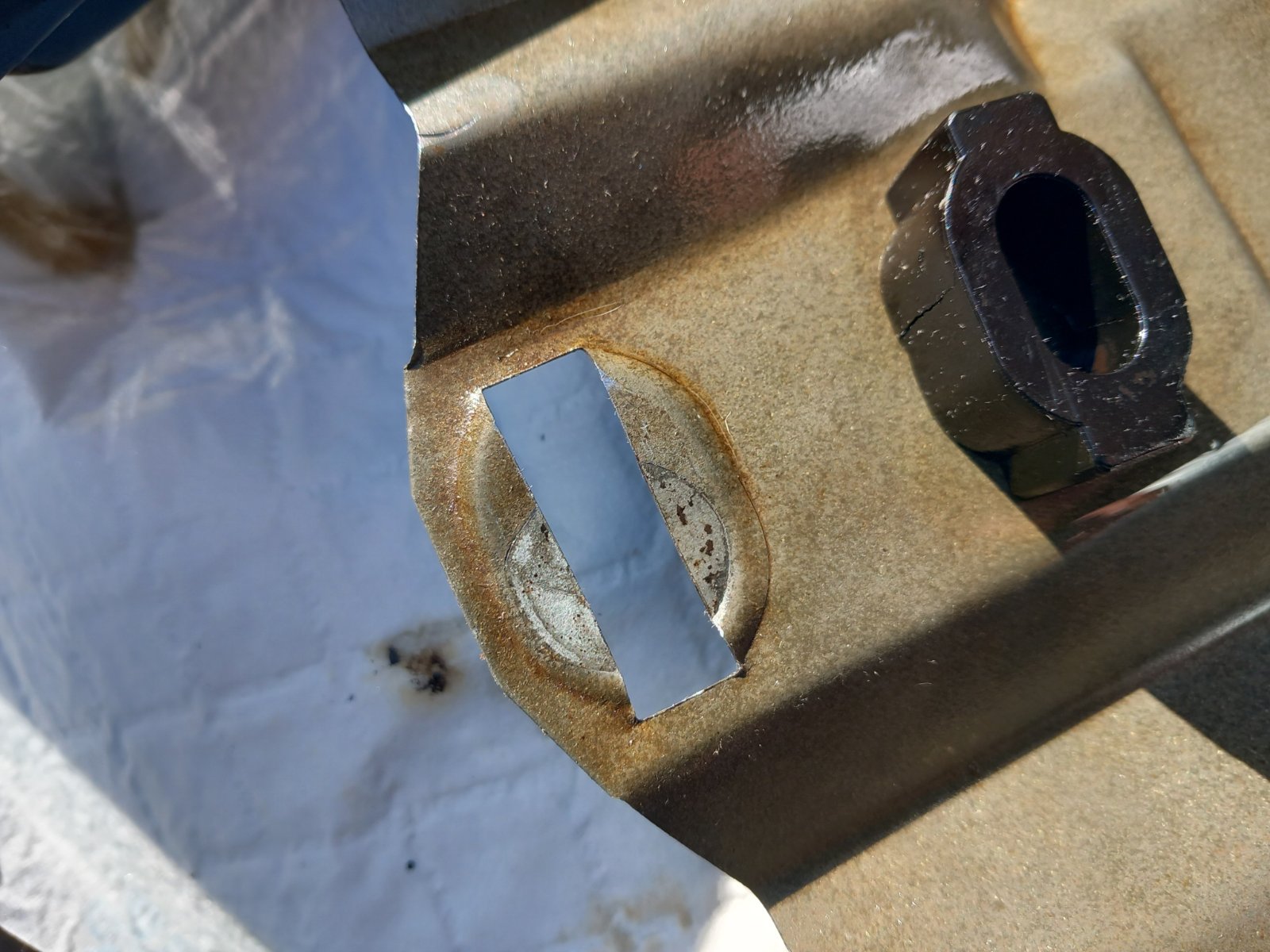

The oil baffle under the rocker box was bent and distorted where one of the spacers sit... This meant the rocker box could not properly sit down and allow the gasket to fully seal. I suspect it may have been like it for a while and may account for the mass of oil that had wept out over an extended period..
I looked to straighten the baffle and then noticed the spacer on the distorted side was cracked... Often because in the past the rocker box nuts have been done up far too tight. See later ;)
And then, on closer checking, this happened...

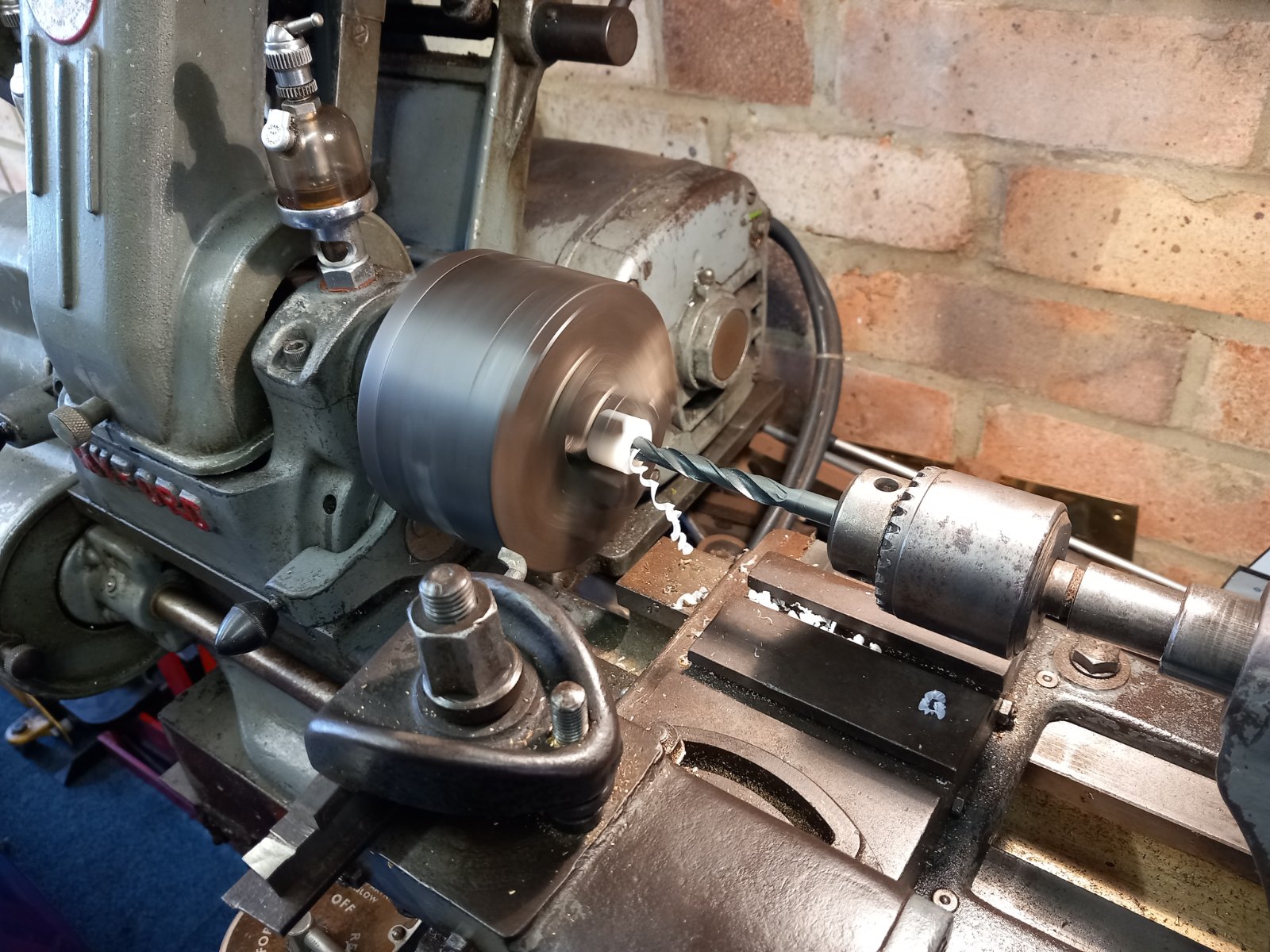

By no means game over, I've been here before as when I first had Daffodil I found one of her baffle spacers was missing entirely and allowing the baffle to rattle! I turned up a new spacer from nylon...
I know it was OK as I checked it was still good a couple of weeks back when I checked Daffodil's valve clearances...
So I turned one up for Strawberry on the lathe...
Here it is ready for the rocker box to be refitted...
No leaks could be seen during a road test but I as far from happy. I could see a gap around the top of the gasket where there should not be one... I was concerned, even though the gasket was sealing, it wasn't sitting properly.
So, I had the rocker box off again and refitted it... This time putting the baffle up inside and fitting both together over the studs...
Now all good :D
The two special nuts that hold the rocker box down really need to be torqued as it's easy to over-tighten them and likely crack the original baffle spacers...
The torque setting stated in the early (original) Haynes manual for the Series 1 cars is just 5 ft. lbs. In the later manual that covers Series 2 cars, it's 12 ft. lbs.
I went for the lower figure...
Now to see if that was the only leak or if there's more. So far, no more have shown up...
Fingers remain crossed ;)
