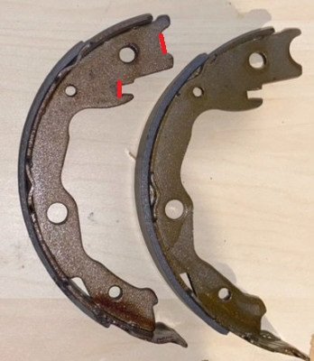

I've yet to ever do battle with a drum-in-disc setup which didn't seem like a cheaply made solution to a problem that never existed. Why can't you just have a cable operated cam which operates on the caliper itself? Why do we need a completely separate mechanism which certainly in the case of Jaguar's interpretation in the early 90s *barely* worked sufficiently to pass the MOT even when set up perfectly?
A decently designed drum brake setup is no more or less trouble than a disc arrangement, it's just different. I believe the Volvo uses a drum in disc setup which I'll no doubt need to dabble with at some point, given the handbrake is pretty poor - not that that's a huge issue in the real world with the car being an automatic.
My gut feeling is that the issue you're seeing is that the new shoes aren't sitting in exactly the same wear surface as the old ones. The friction material may be fractionally wider.
I think what you might just need to do is set up the adjuster (I can't believe such a modern car as this has a manual adjuster...even the drum brakes on my Trabant are self adjusting) so that there's a fair bit of drag initially and see if it self clears after you've driven a mile or two. I really can't see what else it can be.
Have to admit that dealing with brakes on any modern car these days is firmly in the "A garage can deal with that" if it's anything beyond changing a set of pads on a conventional disc setup as the makers seem to be coming up with ever more inventive ways to make what should be a ten minute job an utter nightmare.

I'm thinking along similar lines - there is one weeks worth of wear (and a few deliberate partial activations of the handbrake while doing 30 to see if they were working at all) on the new disc/drum with the old shoes fitted. This has worn a smooth section on the inside of the drum (which can be seen in the photo) that exactly matched the old shoes. As you say, the new shoes may be slightly wider (although they look the same to the eye) or had groves and thus may be making first contact at the edge of an unworn section of the inner hub or where a groove was and thus dragging.Zelandeth wrote: 07 Sep 2024, 18:05 My gut feeling is that the issue you're seeing is that the new shoes aren't sitting in exactly the same wear surface as the old ones. The friction material may be fractionally wider.
Also when you apply the brake it doesn't work as well as it should because the resting position is set further back than normal to try to avoid the unwanted contact point.
I had pretty much come to the same conclusion as you before reading this post - adjust it until the handbrake is at least partially working with the handbrake applied, accepting there will be some drag, then give it a little bit of driving and use with the handbrake nudged on and off to allow the shoes and disc to bed together and then check and re-adjust. It may just require more than usual bedding in before a final adjustment can be made due to using the old shoes with the new drum then swapping in new shoes. (In other words it may not have happened if I'd got the right shoes the first time.
Another possibility is there may be a small amount of "twist" in the alignment of the surface of the shoe lining material such that it's not perfectly parallel to the drum, the shoe material is very soft and wears away easily so it would quickly wear with a bit of use while moving to wear down the high side until they are perfectly parallel.
I'm rapidly coming to the conclusion that I don't want to be doing car repairs at all anymore. I was very handy and enthusiastic when I was younger (my posts on this forum go back to 2005 and I was doing cars for 15 years before that) but I've fallen out of love with it as even a "trivial" job like changing some brake parts seems to turn into a disaster that so far (I'll still need to do more tomorrow) wasted two weekends and has left a bitter taste in my mouth as well as causing a lot of stress over a rapidly approaching MOT.Have to admit that dealing with brakes on any modern car these days is firmly in the "A garage can deal with that" if it's anything beyond changing a set of pads on a conventional disc setup as the makers seem to be coming up with ever more inventive ways to make what should be a ten minute job an utter nightmare.
The front suspension on the Leaf is now exhibiting creaking and clonking as if it's got both ball joint and strut top bearing issues and that's very much going to be a case of "fix it please" as I won't be touching that.

I cannot believe how utterly useless this handbrake system is...
I adjusted the adjusters so both wheels could turn freely with the handbrake off and went for a gentle one mile drive at 30mph.
Got home and the rear left wheel was too hot to touch - 100 degrees according to a temperature gun... The right side about 40 degrees.
Jacked up the left, turned the wheel by hand, sure enough it was now partially binding, slackened it by about 4 clicks until it wasn't binding, checked the other side, it turned freely by hand so didn't touch that side.
At the start of the second test drive the left brake was back down to about 40 degree again. Another short 1 mile gentle drive with as little brake use as possible and the rear left wheel was up to 80 degrees again.
Jacked it up, spun it by hand - completely free to move. WTH ?
Furthermore, with the current settings both handbrake drums might as well not be there because I can push the handbrake pedal in all the way (which doesn't offer much resistance) and the car will still roll backwards with just the auto "creep" without even pushing the pedal, and while driving at 30mph fully applying the handbrake barely slows the car at all.
Third trip I deliberately applied the handbrake while driving a few times but it was as weak as anything - barely noticeable.
So they're basically useless and have no chance of passing an MOT. If I increase the adjuster any more they bind up and get extremely hot, if I slacken them even slightly neither side can actually act like a handbrake and would not have any chance of stopping the car rolling down a hill.
What am I missing ????? Surely they can't be this bad ??? All new parts. The handbrake cables are new, the handbrake lever inside the drum is moving across it's full travel and back no problems at all. Yet its binding when released, but unable to brake the car when applied. I just don't get it.
About to punt this one to the "experts" to deal with as I've had enough of this. Absolutely cannot stand drum brakes.

Having done the same handbrake cables/shoes job on my Leaf, after a failed MOT on the handbrake in 2023, and reading what you have done and tried, I can't think of anything I did differently.
The disc and the pads were ECP specials, cables from cleevly. They were LH and RH cables probably impossible to fit the "wrong way round" but straws are being clutched at.
Depends what degree of "experts" you get to do the job, but if I was them I would start from scratch and do new disks and shoes, and yes most will just get them from Motor Factors or ECP not Nissan.
I cant remember doing anything clever in adjusting the "single cable" element of the parking brake ie the one which goes eventually to the pedal. Maybe I pressed the pedal a few times. I think the procedure was to lock up the drum with the adjuster, and then back it off a certain number of clicks (6 or 7) to allow pressing the pedal to be as per a normal handbrake, ie effective and fully on with a particular level of travel.
Sketchy information but as much as I remember from the job. I think I did do a bit of bedding in of the new shoes not in any scientific way just a few gentle dabs of the foot operated parking brake, keeping it pressed on for a few hundred yards etc.

Play in the wheel bearing allowing the drum to sit non-parallel to the hub when the weight of the car is sitting on it? So it spins freely when jacked up but binds when there's weight on it?Mandrake wrote: 07 Sep 2024, 20:13 I cannot believe how utterly useless this handbrake system is...![]()

Brand new drums/discs. They haven't had time to corrode yet.mickthemaverick wrote: 07 Sep 2024, 16:48 Having seen your pics I wonder if the 'drum' part of the disc is not fully square, ie corrosion built up as in the sketch below?

Can you check your ECP purchase history to find out for certain what brand of disc you got from ECP please.NewcastleFalcon wrote: 31 Aug 2024, 22:13 Apart from the cables from Cleeveley my shoes and disks came from bog standard ECP I think (they did looking back on the thread probably "Eicher" brand). The adjuster is most likely the Achiles heel of your problems...can you put it in the wrong way round? does it foul on the lower spring if you do. Could the upper metal piece be mounted the wrong way? Hope you get it sorted when you look at it again in a fresher state.
I have an ECP a few miles away and they offer Audura, Eicher, Bosch, Brembo, Textar and Pagid in increasing cost, all in stock!
I'm starting to think there is a fit issue with the Triscan disc because it's only the last fraction of a millimetre that it goes on that suddenly it starts binding. It could be something like eccentricity in the inner drum surface of the drum/disc - I checked the disc surface where the pads make contact with a dial guage and it was almost perfect, (also showing it is seating on the hub properly) however that doesn't mean there couldn't be a machining problem on the inner drum surface.
I'm thinking of going the nuclear option and buying a different brand of disc (and it will also be unused and not worn to the old shoes) and popping it straight on to see what happens.
ECP are closed on Sunday unfortunately but I could wind the adjusters back to minimum so they don't drag so I can drive the car again, (I've been driving like that for months with only a parking brake anyway) and could pick up some discs after work tomorrow and throw them straight on. What have I got to lose ?
If it solves my issue I ask to return the discs (along with the original shoes) to Cleverly. I think my issues here might just be a poor after market parts brand.
