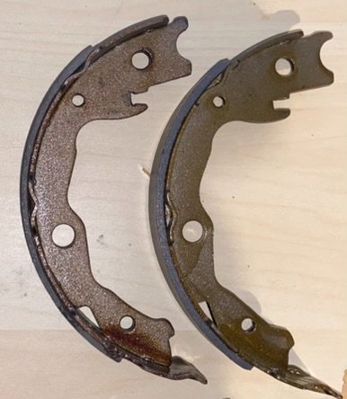

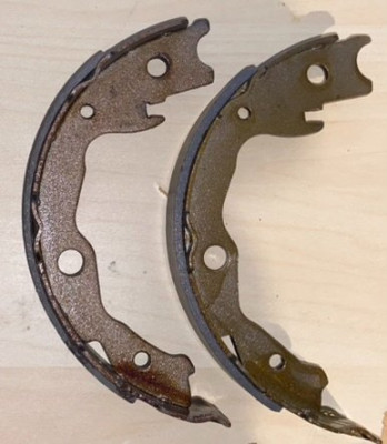

New shoes have arrived, these ones are Delphi instead of Triscan and are also for 2014+ Leaf instead of 2011 to 2013.
The design is very similar and would pass as the correct part at a casual glance (and did for me) but there are some significant differences in dimensions. Spot the differences:
The new, presumed correct shoe is on the left.
Hopefully the weather cooperates on the weekend. [-o<

It was the only logical explanation for your difficulties Simon, I presume they don't want you to send the wrong ones back, they certainly caused a lot of unnecessary hassle for you.

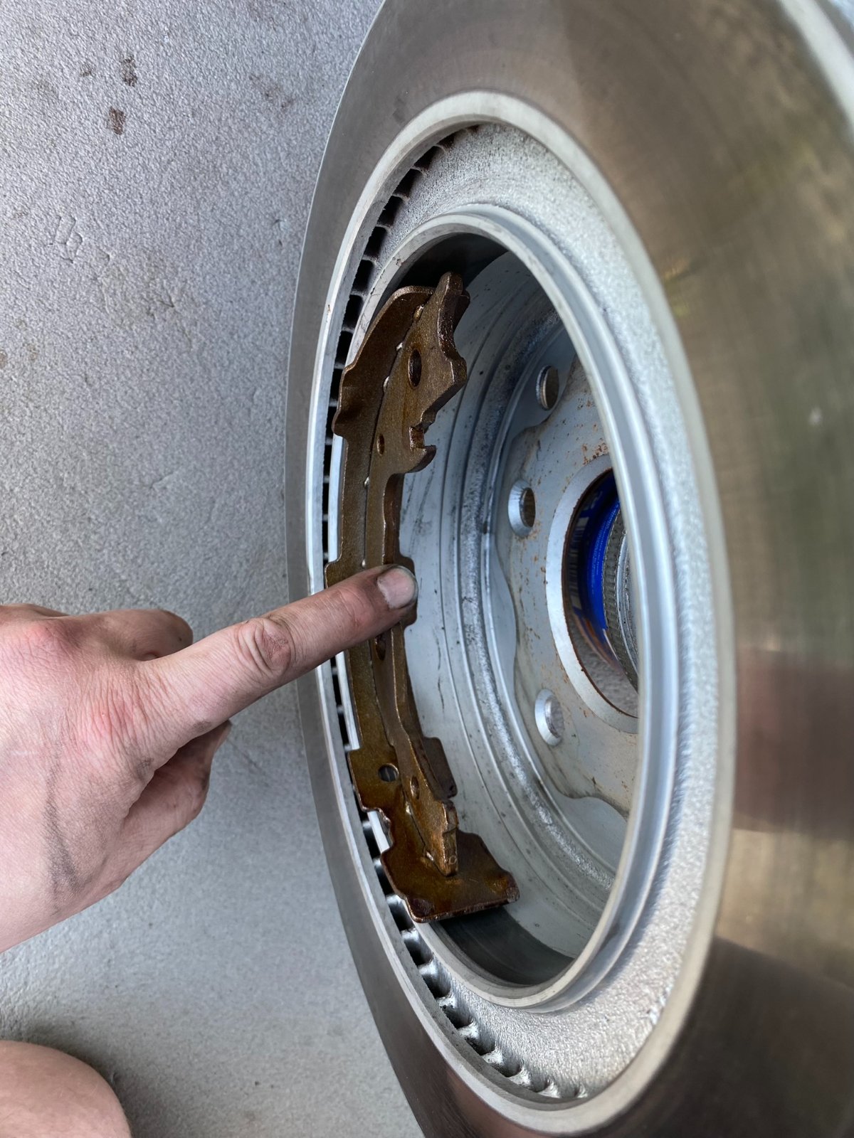

Well I'm stuck again! #-o
I've fitted the new shoes and they are definitely a much better fit than the previous ones and they do match the originals so I'm pretty confident they are the right part, BUT....
The drum slides over the shoes easily and if I turn the drum while it's just pushed onto the studs by hand it turns freely, however as soon as I put a couple of nuts and spacers on to pull the disc properly square it binds. #-o
It's happening on both the left and right sides. Loosen the wheel nuts slightly and allow the disc to move back the tiniest amount and it turns freely again.
Anyone have any suggestions as I don't understand what's going on here... :(
Why can the drum clear the shoes perfectly for 95% of sliding on then suddenly start binding when it's fully pulled home ? The adjuster isn't even extended yet it's fully wound in...

That sounds to me like the shoes are fractionally wider than the originals causing the edge of the shoe to bind on the face of the disc when tightened. If so a little run of a flap disc down the edges of the shoe backplate should sort that out :)

mickthemaverick wrote: 07 Sep 2024, 15:52 That sounds to me like the shoes are fractionally wider than the originals causing the edge of the shoe to bind on the face of the disc when tightened. If so a little run of a flap disc down the edges of the shoe backplate should sort that out :)
Sorry but I'm struggling to visualise what you're suggesting ?

There's no way the shoe can touch the front of the disc - there is a lot of excess inner drum. (at least 15mm)
The disc is also not touching the backing plate - with the shoes removed I can tighten the wheel bolts without introducing any drag.

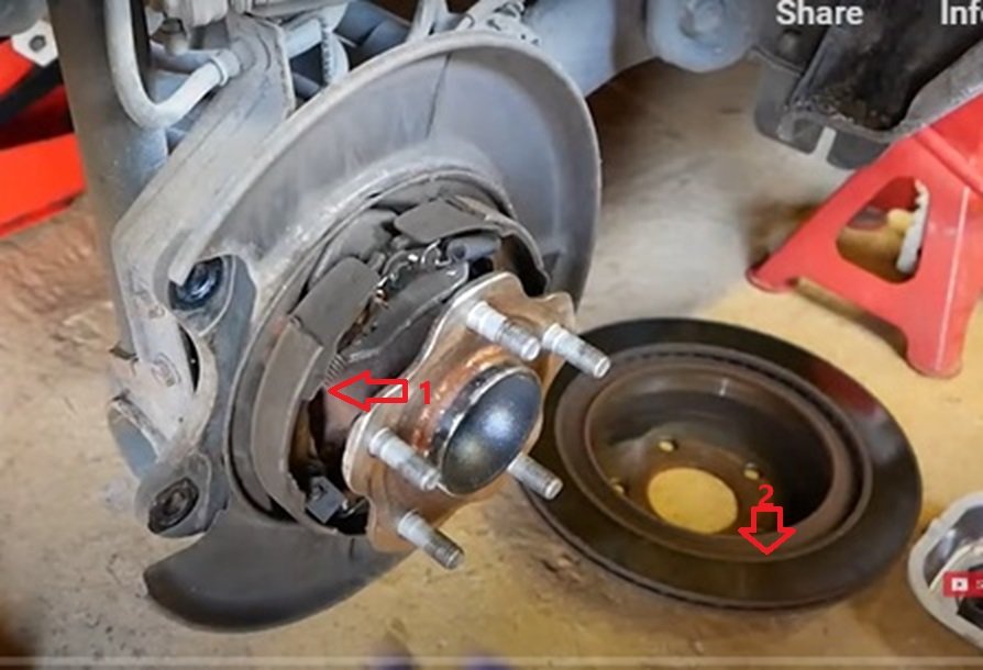

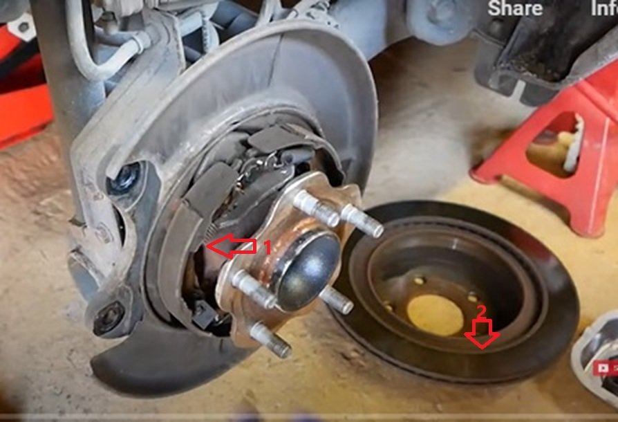

I am thinking that the edge of the shoe indicated by arrow number 1 is rubbing on the face indicated by arrow number 2 when you tighten it up.
So a quick shimming down of the edges may solve your problem and I would use a flap disc on the grinder. Does that help?

mickthemaverick wrote: 07 Sep 2024, 16:32 I am thinking that the edge of the shoe indicated by arrow number 1 is rubbing on the face indicated by arrow number 2 when you tighten it up.
So a quick shimming down of the edges may solve your problem and I would us a flap disc on the grinder. Does that help?
I can't see how that would happen when the shoe is entirely within the inner radius of the disc.
The only thing the edge labelled 2 might touch is the backing plate / stone shield but I've checked that with the shoes removed.

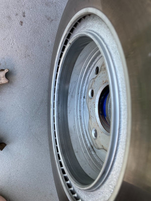

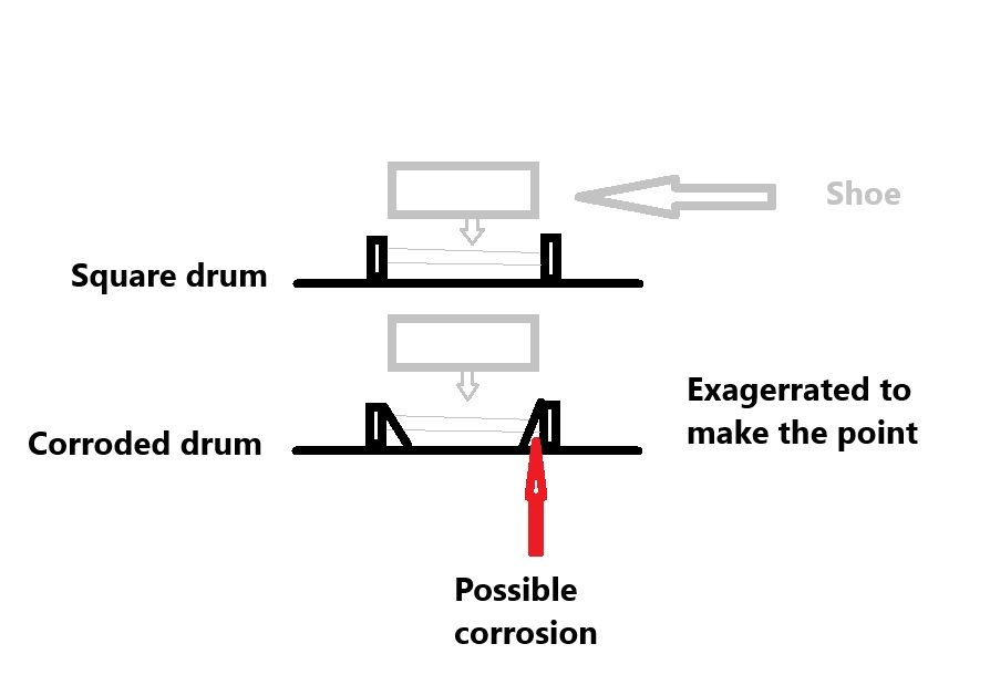

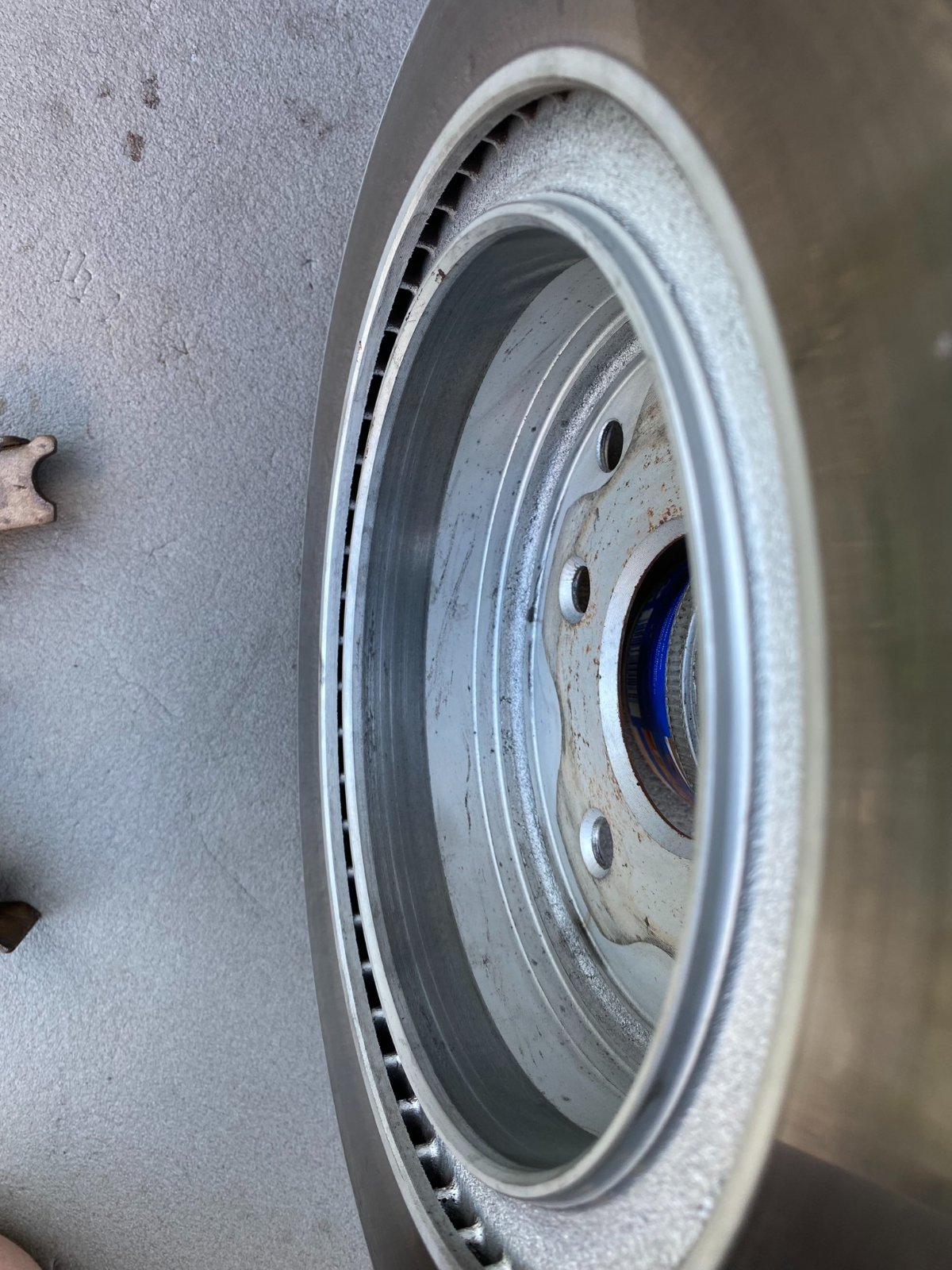

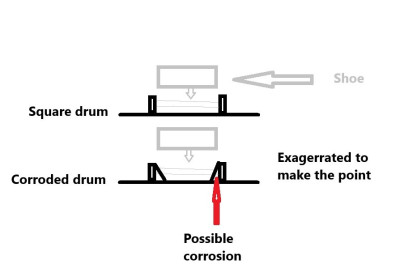

Having seen your pics I wonder if the 'drum' part of the disc is not fully square, ie corrosion built up as in the sketch below?
MTMO
MTMO
Posts: 21362
x 8162
Re: Simon's new Xantia V6 and Leaf blog
If you have a rubber wheel you can put on a drill I'd bolt the disc to the hub back to front so the drum is facing out, then use the rubber wheel against the outside of the drum to drive it round while holding a file, assuming there is clearance between the file and lug nuts, if not use abra paper, squarely on the inside face of the drum and thus removing any material which shouldn't be there. :)

I've filed a little bit back on the shoe where the bottom adjuster fits and I can now bolt the disc on without it binding at all.
However I now have the same problem that was there with the car before I did any of the work - which is that if I back off the adjuster to the point where the wheel isn't dragging with the handbrake off, it will not lock the wheel when turned in reverse when the handbrake is applied - I can overcome the brake in the reverse direction by turning the tyre by hand.
