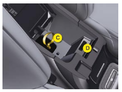

I have owned a C5 2009 station wagon for 1 year,
Yesterday, the electrical handbrake wouldn't turn off at all and I used the emergency yellow rope in the armrest because I couldn't leave the car there.
It came loose with it, but I can't get it back into place, and now it says on my dash that the automatic parking brake is not working, and it keeps flashing.
Is there a specific method to get the yellow plastic back to place, or do i have to use a lot of force?

From the manual in case you don't have it:
  • Release the strap from its location C.
  • Pull the strap to release the brake. A loud knock confirms the release of the brake.
  • Take care to put the strap back in its location C correctly. Otherwise, it will no longer be possible to apply the brake.
    Consult a CITROËN dealer.
  • Put the rubber mat back in place on the base of the armrest.
  • Remove and stow the chock.
This strap does not permit application of the parking brake.

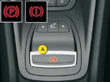

  • To re-engage the electronic parking brake (after rectifying the malfunction or battery failure), give a long pull on the control A until the parking brake warning lamp (!) flashes on the instrument panel then give a second long pull until this warning lamp is lit permanently.
  • The time required for the subsequent application may be longer than during normal operation.
    It is essential that the ignition is not switched on until the parking brake has re-engaged (flashing of the warning lamp (!) on the instrument panel then warning lamp lit permanently) to avoid damage to the parking brake.
