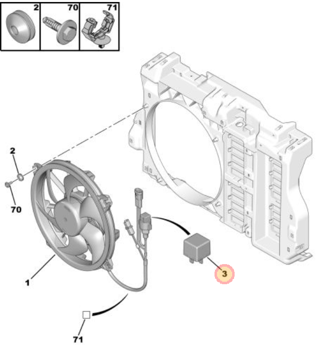

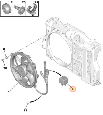

... and of course, I forgot to answer your main question...
Relay is shown at (3), part: 6545XF, £30.95
