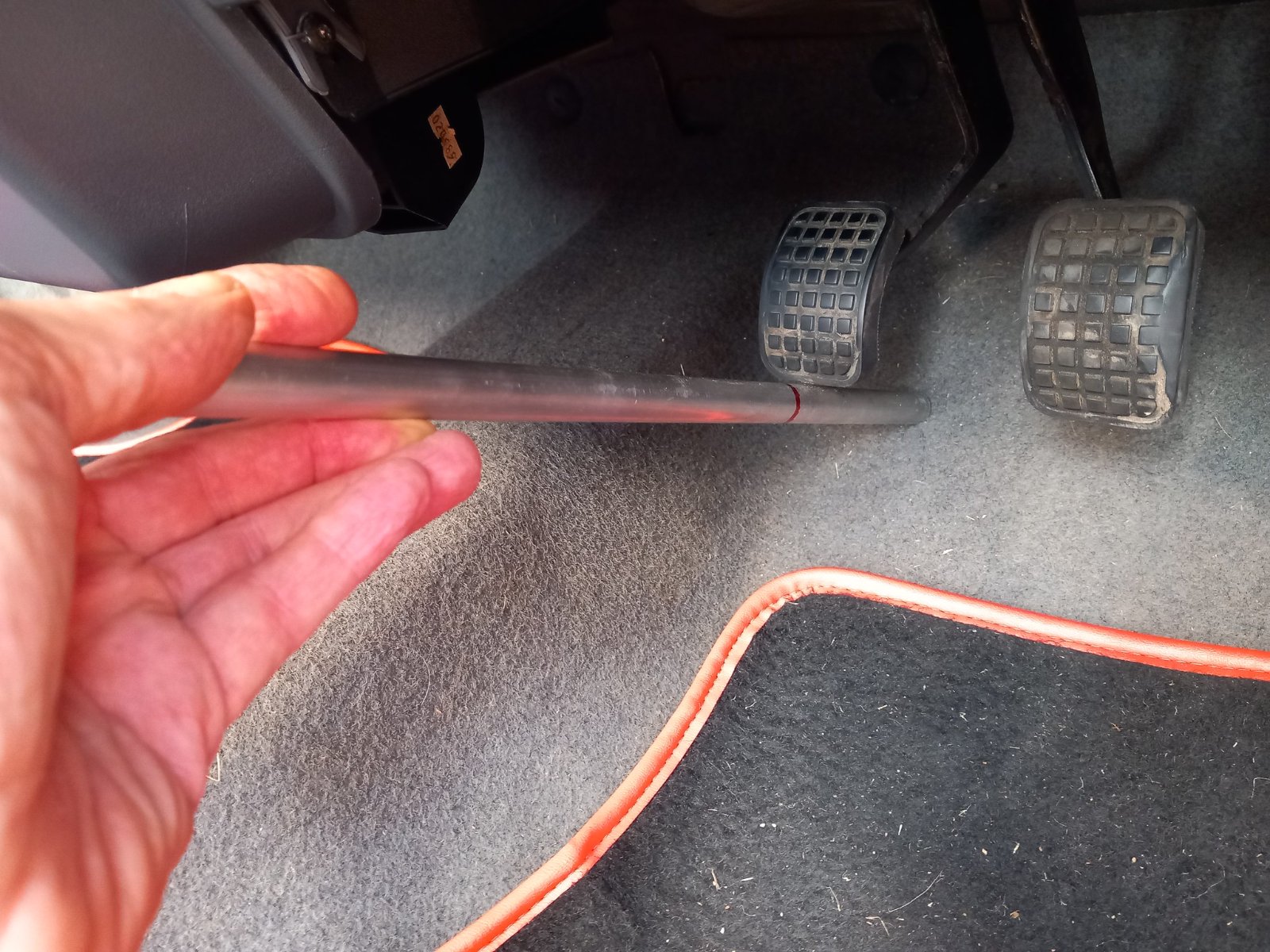

First job on Strawberry was to adjust her clutch as it was a bit low... It's checked by pedal travel... Less than 5 inches and it needs adjustment. It was less and it did...
The clutch is adjusted by by lengthening or shortening the clutch cable by way of a nut, locknut and washer on the engine-bay end of the clutch cable. Easy to do. Access is improved by removing the battery.

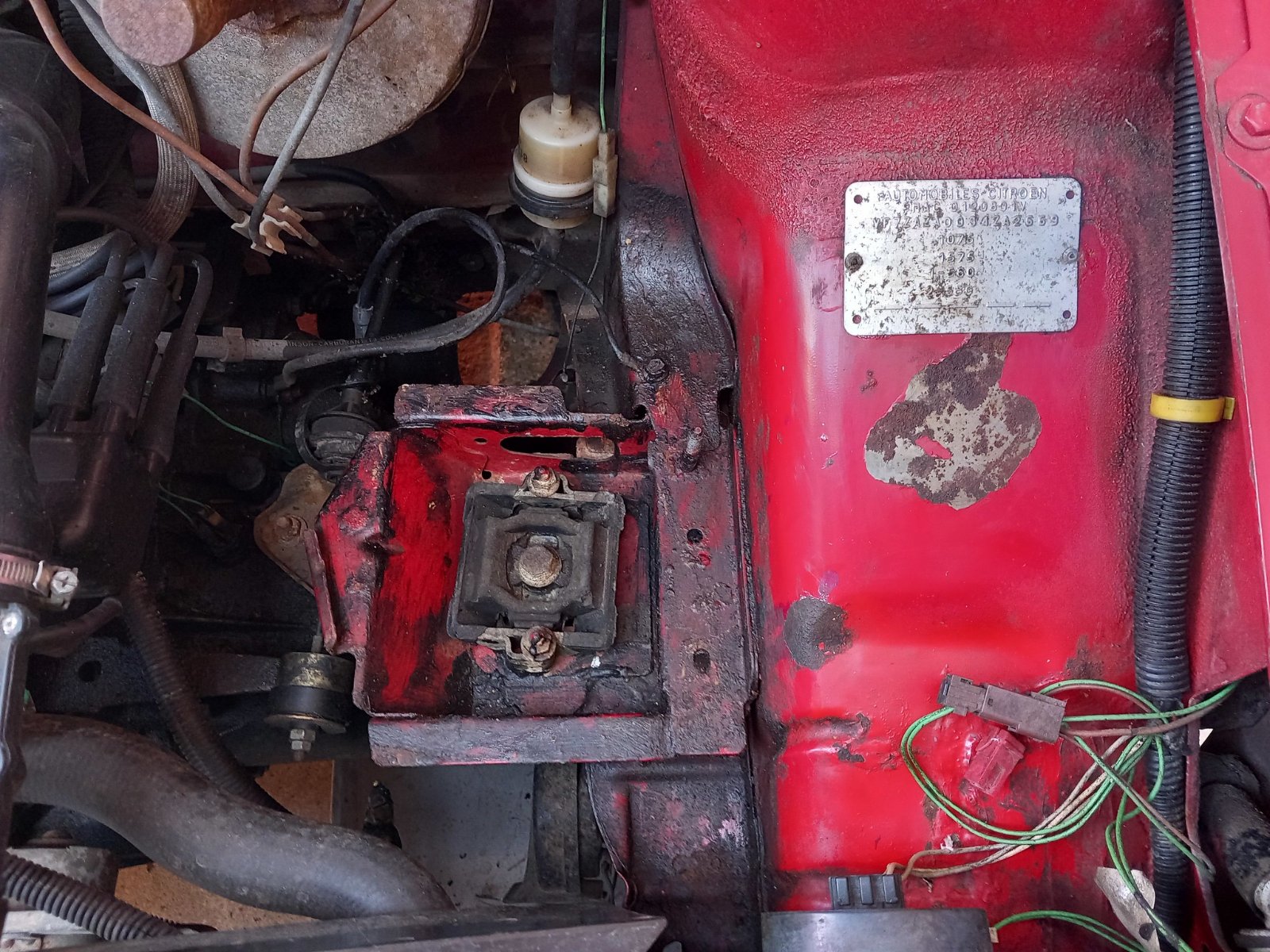

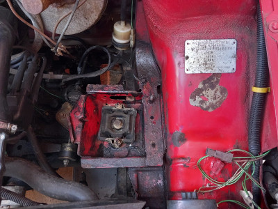

This gave me a chance to check for rust under the battery tray - a common place - and all is good. As are her inner wings. It's all mucky down there and some plaint is flaking off which needs attention. The 'muck' is actually rustproofing compound that's attracted loads of grime... I've started cleaning up the engine bay

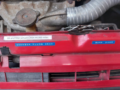

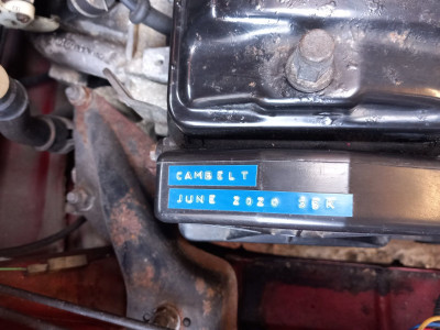

As testimony to how the car has been maintained, there's Dymo tape all over the engine bay such as these:

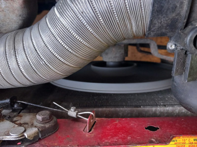

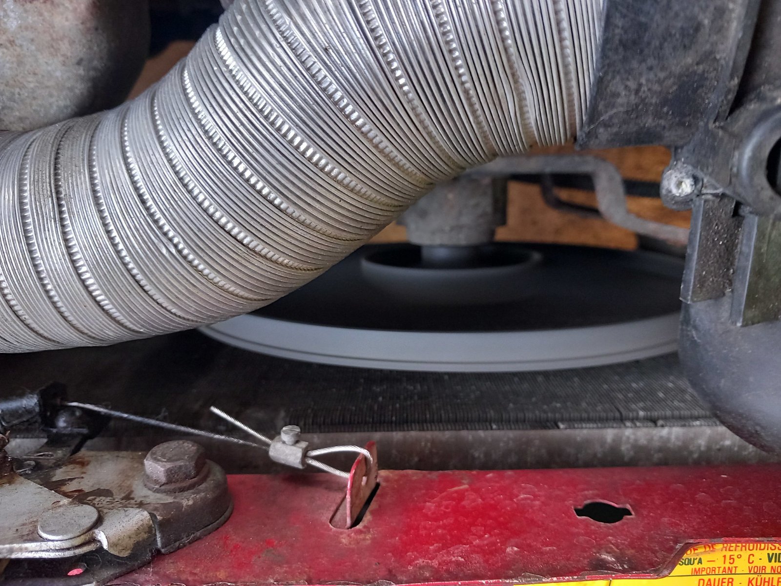

One essential job was to check her cooling fan works... They can fail and if they do it can be bad news for the engine if stuck in traffic... Happily, all is well and the fan spins lustily when called into action

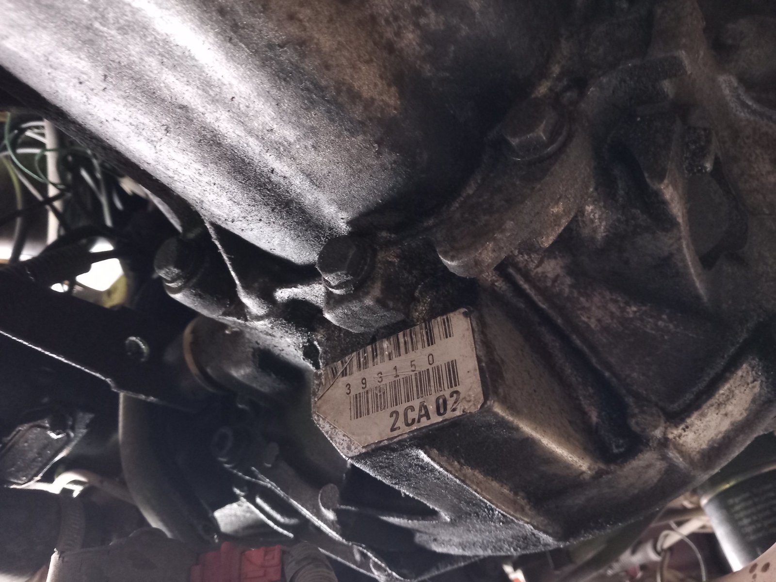

It is amazing what survives over time - a paper sticker on her gearbox and it's been there for 35 years! I never knew barcodes were that old...

Looks pretty good Jim, that bare steel (and little bit of surface rust) just a quick bit of anything just to stop it now.
The AX is full of interesting little details - like the earth points on the strut top washer: has that not got a rubber mount at each contact point with the body? (Strut top and wishbone bushes, track rod end ball joint typically has nylon inner, anti roll bar on rubber mounts)

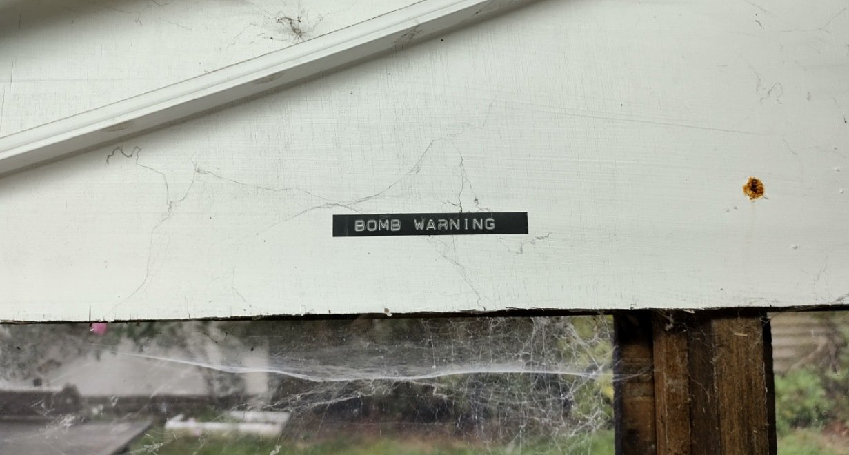

Not yer average bit of Dymo tape
I recovered this from an old bunker some years ago. Can't remember the exact context of it - whether it was situated by a light that lit up when things were likely to get a bit hot, or whether it was to mark where the 'Bomb Warning' clipboards with paperwork filled out in triplicate were to be placed
- I know not. I have a feeling it was an ROC HQ or maybe even a Regional War Room bunker - probably long gone now. It resides in my shed as it'll probably alarm the fewest people there

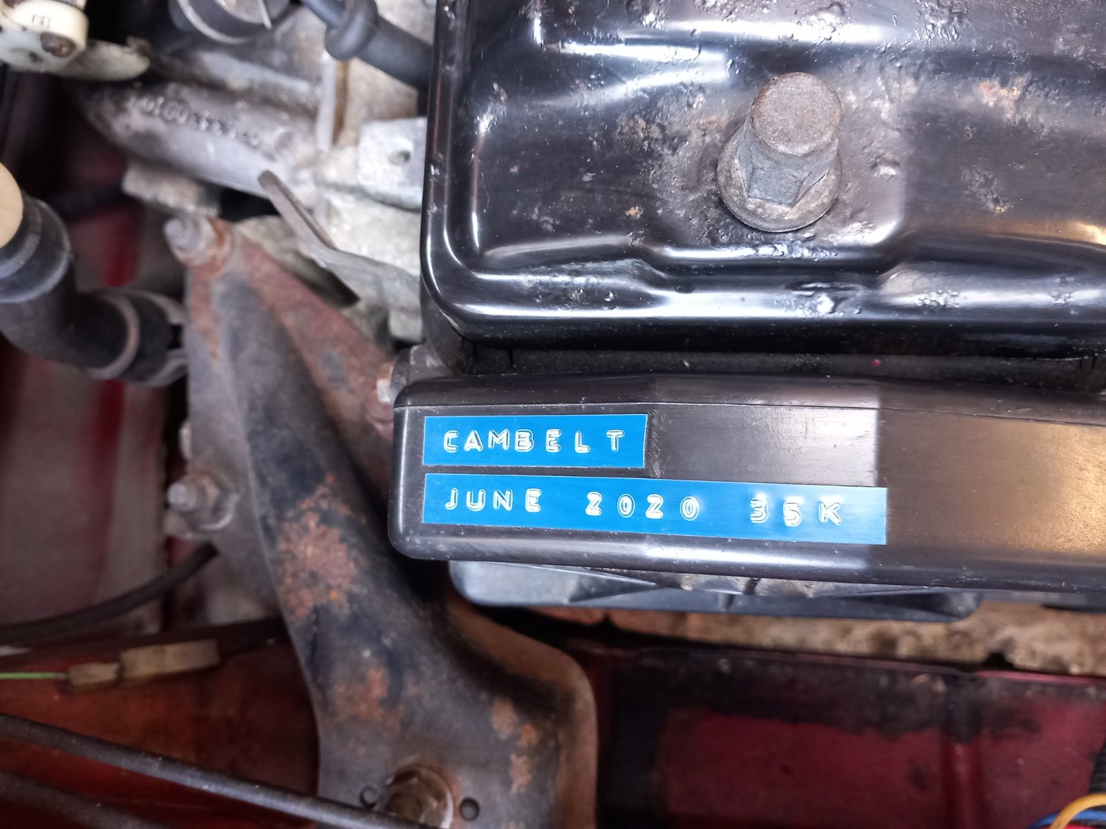

Another bit of Dymo on Strawberry:
Which tells me her belt will be up for renewal next year - on a time rather than mileage basis...

Was it Strawberry's belt you reckoned was a bit over tight? If so does it make sense to change it rather than adjust the tensioner? Just thinking you're getting halfway there to a belt change (ok would also then likely expand to include water pump swap and so perhaps coolant change too) when digging down to the tensioner.

Yep, I'll do the pump and tensioner when I do it properly Matt but for now I just want to check the tension and that's a ten minute job on the AX!MattBLancs wrote: 03 Sep 2024, 05:42 Was it Strawberry's belt you reckoned was a bit over tight? If so does it make sense to change it rather than adjust the tensioner? Just thinking you're getting halfway there to a belt change (ok would also then likely expand to include water pump swap and so perhaps coolant change too) when digging down to the tensioner.
Albeit there looks to be much less digging on the AX (than say the last one I did: the C5) !
I can hear the belt whining... It may be the tensioner although to my ears it sounds over-tight and that concerns me ...
