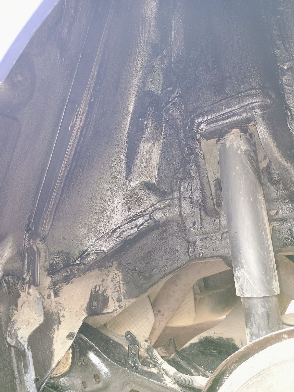

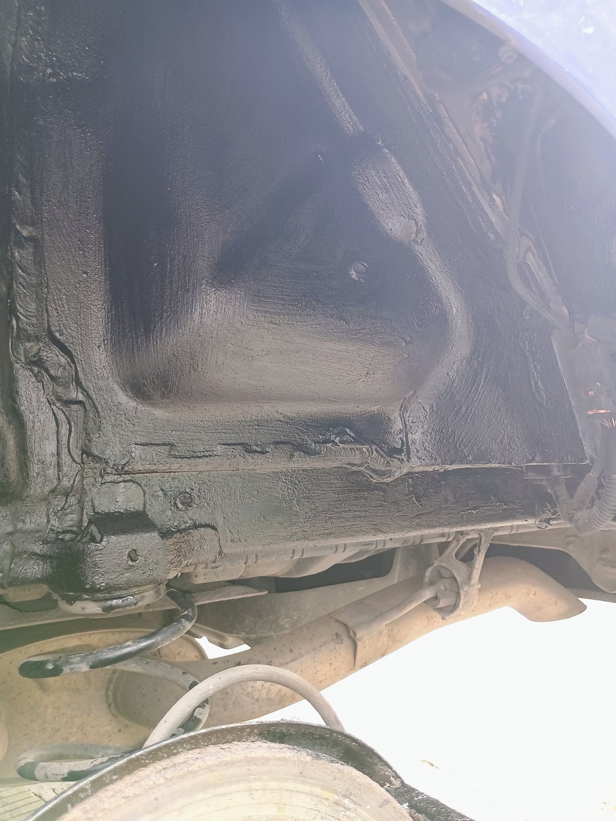

Not Black Velvet, more (chassis black last night then) black gungy Tetroseal this morning, again in between the showers. Wheel arch and rear suspension (just this side) both now coated.
Wheel arch liner reinstated (after a crack repaired with the hot staples) now with number plate penny washers, standard M6 nuts and bolts, liberally copper greased!
Hopefully less of a fight if/when it next has to come off

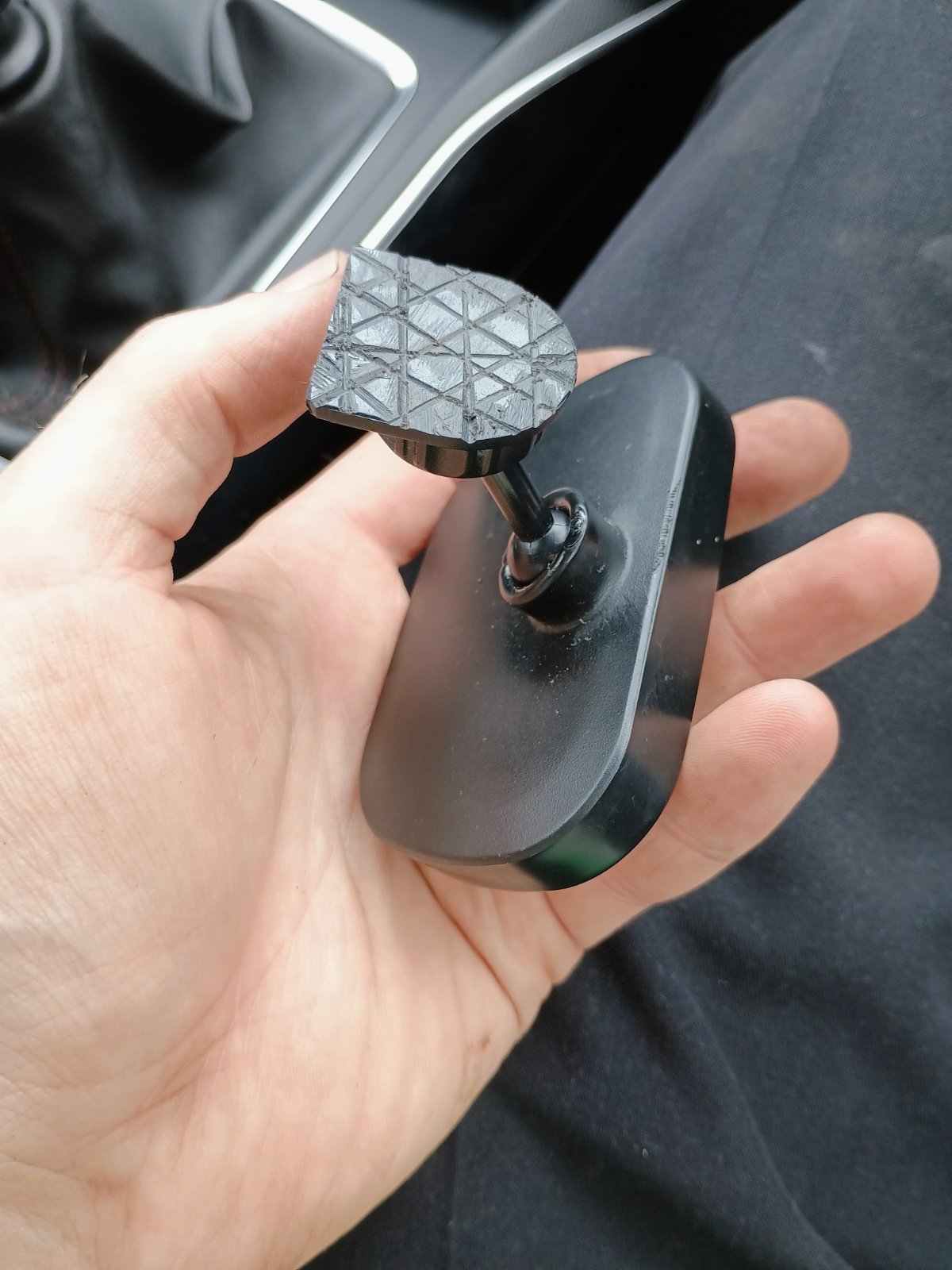

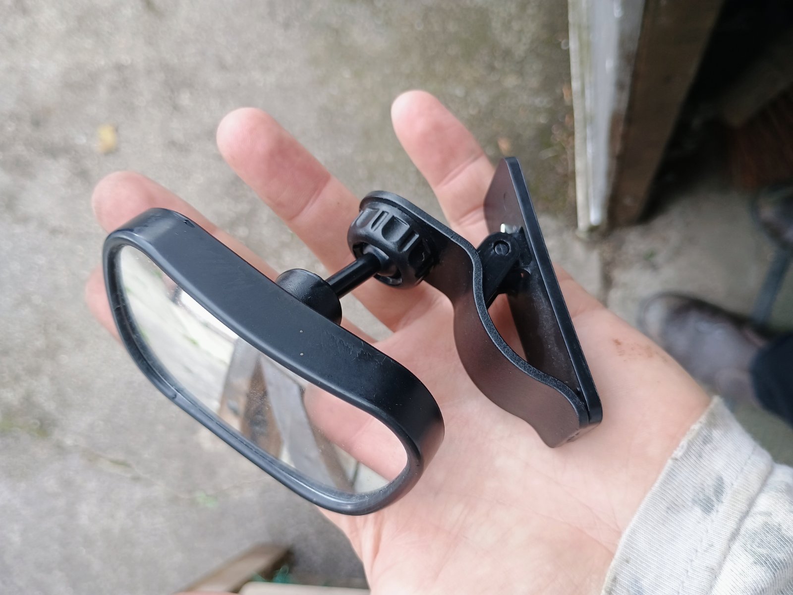

Whilst the underseal dried, I did an interior mod, or addition. This cheap mirror has never really successfully "clipped on" to anything.
So, sliced off the silly clip and added a bit of roughness for glue to key to.
Now a hot glue gun blob has stuck it to the windscreen, above the standard interior mirror.
(All to the aid of keeping an eye on the little ones sat behind us) :)
