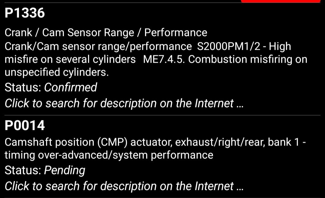

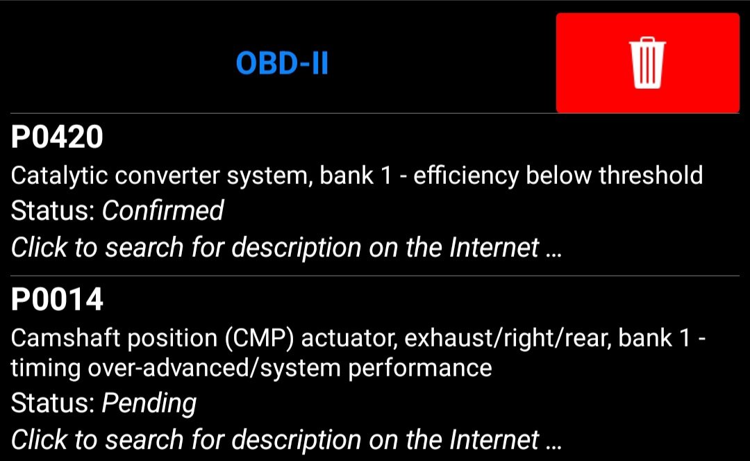

One night after driving around 8 miles, the EML came on (drove fine) n when I got home, read the codes, and came up as CMP Actuator/rear/bank 1/exhaust timing over advanced.
So not knowing history of car, I changed the belt and tensioners (belt was wayyyy overdue), filters, oil. Shortly after drove around 8 miles again, and went into limp mode, misfiring like hell. Read codes, missfire cylinder 3. After some diagnosis, it was spark plug. New set of plugs in.
Car was fine couple of weeks (but still smoking, getting progressively worse) and EML came on again for CMP Actuator Exhaust..
Changed actuator, then 2 days later came up as front inlet actuator.

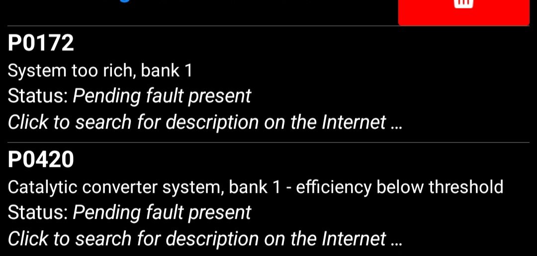

Since then had various codes for misfires, cat, timing over advanced, rich fuel mixture etc.. (see attached images for some examples) until today, limp mode again, misfiring like hell, turned out one of the new plugs had failed πŸ™„ replaced that, and so far driving fine, but still VERY smokey. Ive checked the PCV and theres no splits, and its clean. (Could see evidence on plastic it had been opened before)
Noticed today too theres now a rattle when revving engine from the cat πŸ™„
She really loves the car, dispite it being an absolute headache, and would like to repair and keep if possible, so any help/advice greatly appreciated.

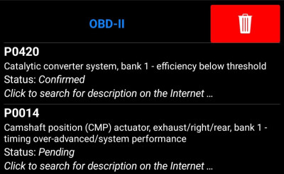

The excess oil consumption has probably destroyed the Catalytic converter. Hence the P0420 code. It may have only damaged the downstream O2 sensor but you would have to replace it to find out (I doubt it tho).
Cam dephaser solenoids can fail or get crap in the screens and give you the P1336 and P0014 codes. You can try swapping the solenoids front to back and see if the code moves.
Not sure on the P0172, it's only pending, which means it was transient. I wouldn't worry about it ATM.
Thanks m8, very informative.
I was actually considering Sea Foam to try and remove any carbon bulid up?
The Cat is definitely toast, as it rattles at certain RPMs if rev engine when stationery.
Whether the missfires have killed the cat, or whether the failed cat is causing the missfires, is yet unknown.
I did initially clean, and swap the solenoids when the 1st code for the exhaust one appeared, and it didnt follow or come back, but did start getting the other codes instead, so thinking it may still be due to solenoid problem, I replaced them both with new, and sometime after that is when I got the one come up for inlet side πŸ™„
Thing I was most curious about, was alot of codes were relating to over advanced timing, running rich... coupled with the cat bein demolished, and 2 plugs on seperate occasions now failed (both different cylinders each time) I was wondering if its possible the timing could be slightly out/over advanced??
When I changed the belt, I used the dedicated cam/crank locking tools for this engine, so I know that was bang on, and obviously turned over by hand and relocked with tools to double check before starting it.
But I have absolutely no clue how VVT and dephasers work?? I have always owned diesels, and havnt had a petrol for a long long time, long before this modern stuff. (My last petrol was a H reg S2 RS Turbo, and prior to that, a H reg Calibra 2.0 Redtop) so my knowledge previously, cam sprockets were fixed, and that was it lol.
Is there anything I should he aware of timing wise, other than locking the cams and crank as I did with the tools?

The VVT system uses oil pressure to advance the cam timing. The solenoids "modulate" the oil pressure in the VVT system. There are inductive pickups that sense the positions if the cam shafts.
You can get problems with the solenoids, the pickups or the camshafts.
Unfortunately your symptoms seem to "move round" and become difficult to diagnose.
Generally speaking, if the VVT system isn't working, you just get poor performance. It should still run fine.
If you get misfires and rich mixture codes, I'd start looking at the injectors. Particularly if you are getting fowled plugs. Could also be a coil pack problem. IIRC these engines have separate coil packs?
