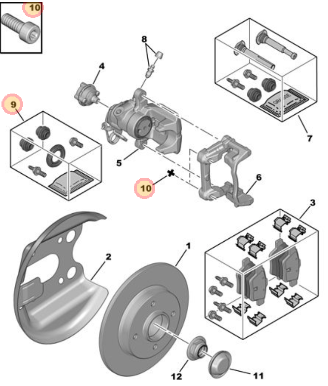

Just for your information and assuming this is for your 207, the originals are in fact 10X125-30 as you can see:
(10) Brake Caliper Fixing Screw, part: 9678008680 (revised part), £3.20
They also do a fixing kit (9) Caliper Repair Kit, part: 4427C6, £52.56

Thank you. I do have M10x30 x1.25 but they're 8.8 and looking around online it seems 10.9 grade steel is generally used for calipers so I'm probably better off sourcing original from dealer.
