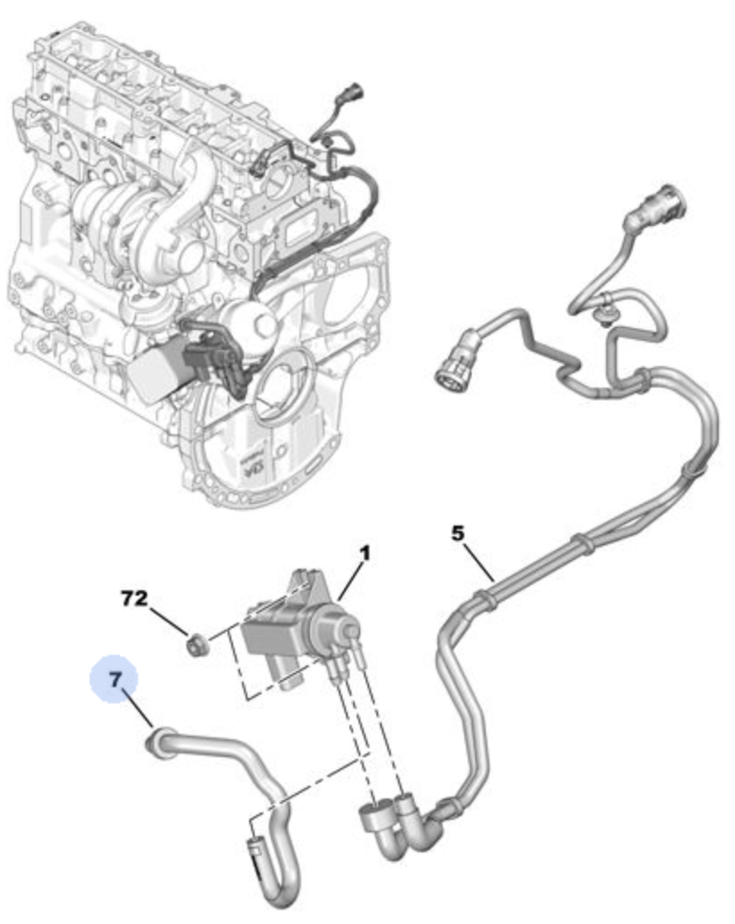

    Btw, do you think that the hoses can be replaced without any special tools? As I can see, the parts needed are on the diagram below.
