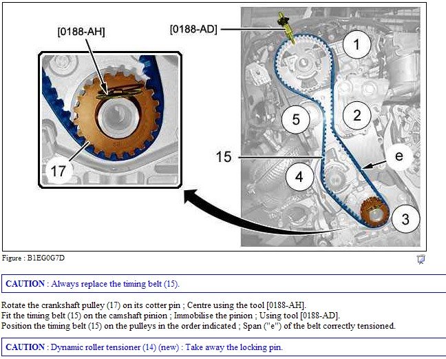

Maybe something to do with the crank shaft sensor or some of either sensors' wiring since possibly this and the cam shaft ones might be being compared to say one is not consistent.
- Posts: 12609
- x 1496
Re: P0341 after timing belt change

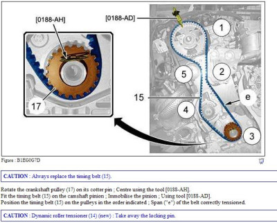

I think these have a floating crank pulley - doing the belt change without pinning the flywheel is asking for trouble.
wheeler
- Posts: 7932
- Joined: 21 Sep 2002, 19:07
- x 1056
Unless the cam sensor has been physically damaged in each of these timing belt changes above this surely has to be the belt hasn't been done properly?

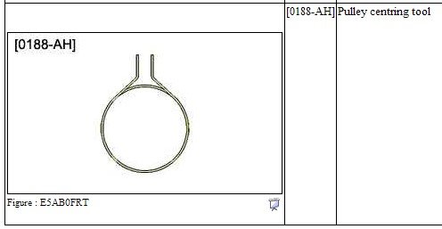

Even if you pin the crank at the flywheel the pulley still has a little bit of 'float' each way & is meant to be centralised with a tool like this, its like the keyway is slightly elongated.
Id guess that when the engine has been rotated the pulley has not been centred with a tool like this. If this is the case the timing will be very slightly out (less than a tooth) not enough to do mechanical damage but enough for it to be picked up by the camshaft sensor.
