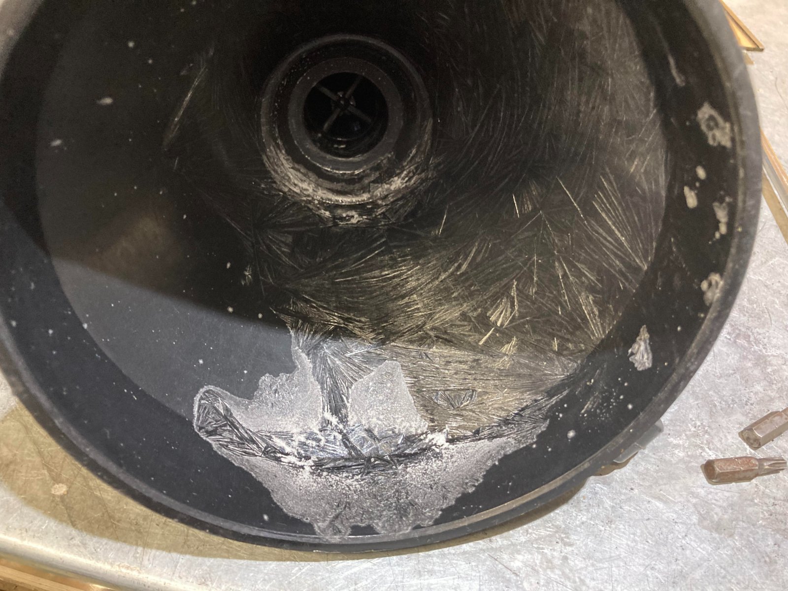

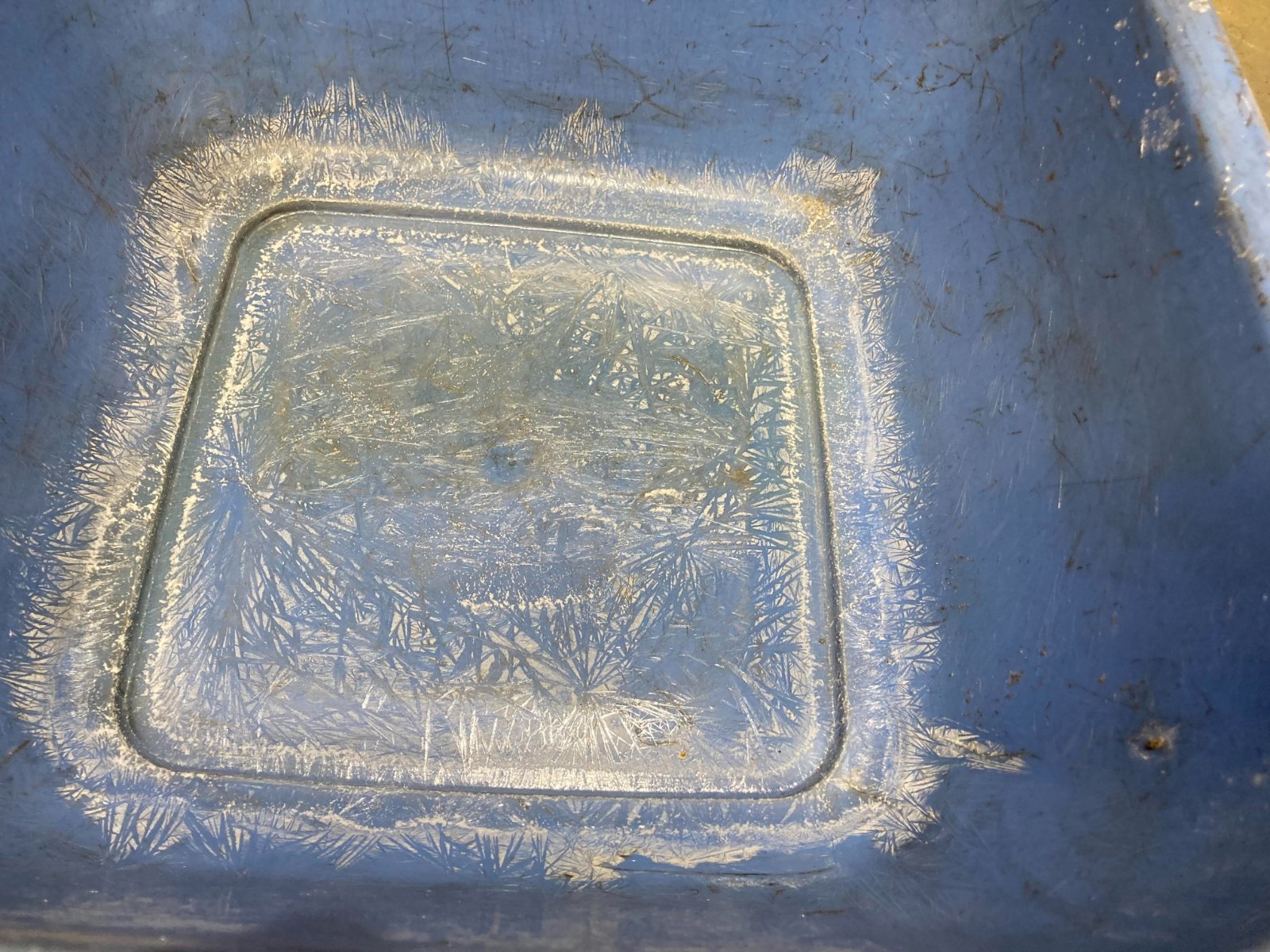

I have been using Wynns adblue additive in my car, but because I didn't know exactly how much was in the tank to start with I decided to drain the tank this time when the 1st low warning came on,
The tank contained 5 litres of adblue with unknown percentage of wynns in it. I then filled the tank with 15 litres of adblue ready mixed with the additive, so that from now I know it is the correct mix.
The 2 photo's attatched are , the drain tub I used, and the funnel I used for refilling, after being left overnight on my bench..... Both full of crystals.
So, is the additive worth it or just snake oil?
All thoughts welcome

I've been saying this for ages as far as my own use of it goes - I never let it get low and top it up every 2-3 months. I use Wynn's Clean and protect additive
to help maintain the system and prevent crystal build up - but the air is the biggest problem here. As you can see, once it's out in the air it crystallises very quickly - now imagine what it's doing in the tank with all that air when the level is allowed to get too low!
Once it starts crystallising, it's very hard to get shot of it, but regular use of the additive should help remove and prevent it from happening. One other thing - be careful with refilling when it gets too low - the manual will recommend the minimum quantities to refill it with - which can differ depending on what level of warning you get. As said, I never let it get that low, and you've just reminded me it's about time I went and topped it up again!
I mix the Wynn's in with the adblue container so that's it's ready-mixed and then just top that up.

As soon as the ad blue sloshes around in the tank any surface crystals will wash right off. Keep meaning to have a look inside the tank on ours and see what it's like. TBH I don't think it's working properly, as consumption seems to have gone down, but the light is not on, so I am ignoring it!

Mine has covered about 8000km for 11 litres on the last 2 fills. I am not really concerned about the volume it uses , more the crystalisation I have written an email to Wynns UK asking why my new adblue with their additive in had crystalised in the funnel, probably down to air contact but just interested in their answer.
I think Marc has the right idea in keeping the tank topped up.

Good morning,
Thank you for reaching us.
As you probably understand, the behaviour of AdBlue and our treatment is different in the outside than in the tank. In direct contact with the outside air, both the AdBlue fluid and our treatment got evaporated and, crystallization appeared as crystallization is a by-product of one of the ingredient of AdBlue, the urea. Which, at room temperature is a solid element. Our treatment will prevent from crystallization in the fluid, but when fluid evaporates… However, these crystals of urea must be quite softer than the ordinary crystallization of just AdBlue fluid.
If you wish to test our treatment, collect those crystals, put them in a jar, add a small amount of our treatment ADProtect (to cover the crystals) and stir. You’ll see how our treatment works.
