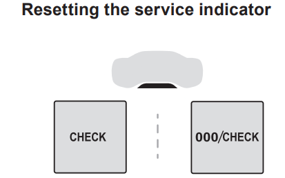

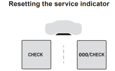

1) The maintenance indicator reset is in the handbook.
The service indicator must be reset after each service.
If you have carried out the service on your vehicle yourself:
2) The Aircon is always on to a minute degree, but if you mean operationally on, then just press the A/C button off from the climate control section in the touchscreen. But I highly recommend you just set the climate control to the driver and passenger temperatures you want and press AUTO. This will ensure the A/C system seals do not degrade which they will do if the A/C is not used regularly, plus it will ensure the condensation is removed.
- Switch off the ignition,
- Press and hold this button,
- Switch on the ignition; the distance recorder display begins a countdown,
- Release the button when =0 is displayed; the spanner disappears.
