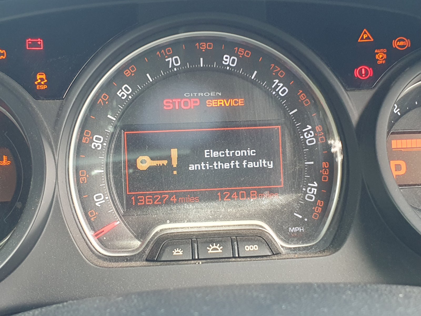

Hm, I'm getting a "electronic anti theft fault" when I turn on the ignition. Car still starts.
Fault code I found was 04BA that seems to be different things when searched.
Possible the key fob?

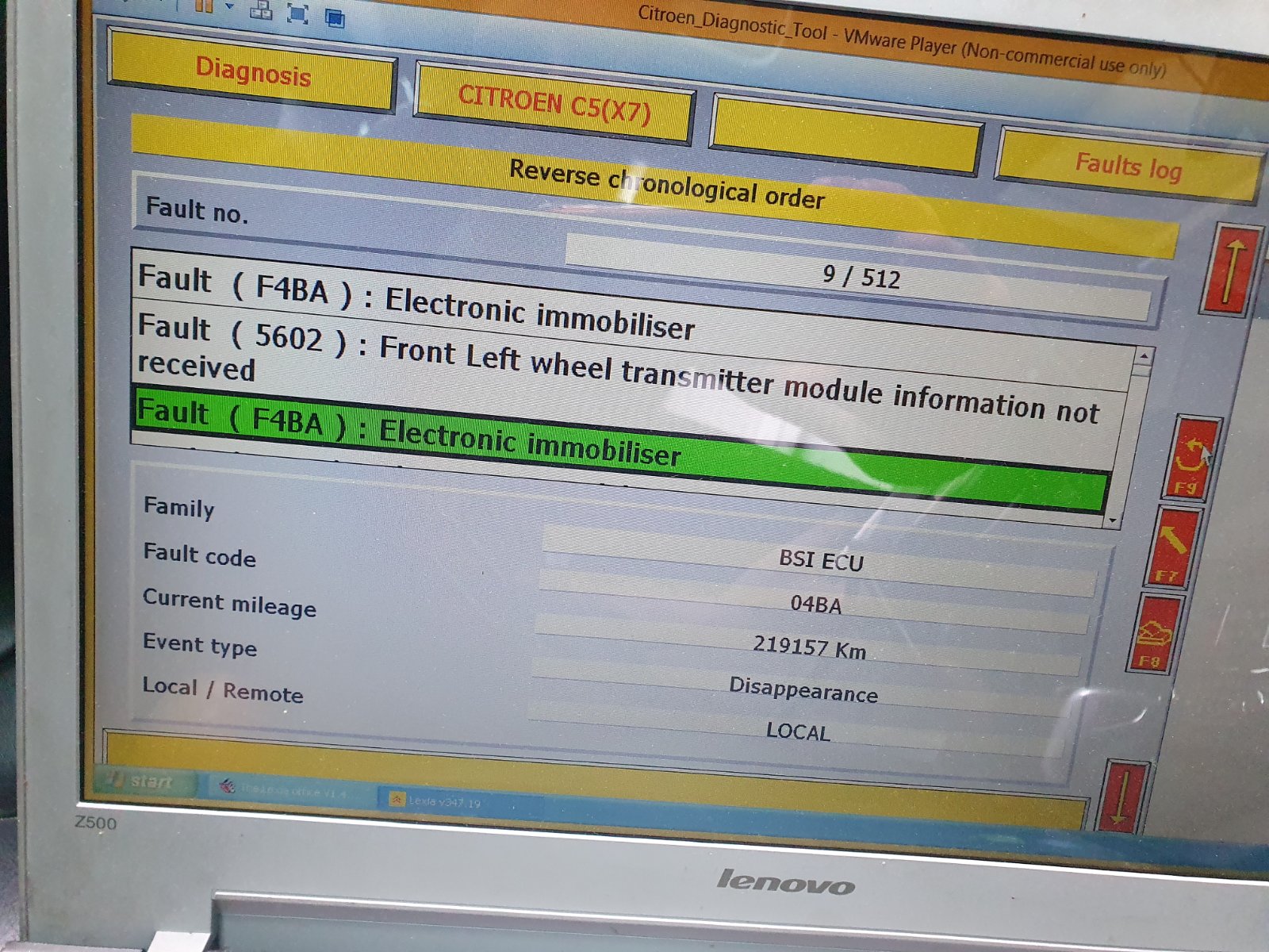

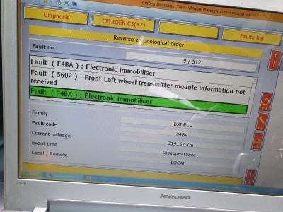

Here's the fault as shown on the old type lexia 3
What do you suppose it means by 'type of event' disappearance
Graeme M
- Posts: 42019
- x 6955
Re: C5X7 2.0td anti theft fault dash watching
Quite possibly Graeme!
This can be a non-characterised fault with the BSI - but in this case it is referring to the Electronic Immobiliser.
| Fault Code: | F4BA |
| Description of Fault: | Electronic immobiliser fault: Not characterised. Key not authenticated after 1 or 2 seconds. At least one of the following conditions must be fulfilled: - Key in the ignition switch and identified: Ignition off - Ignition on |
| Conditions for Fault to clear: |
| Downgrade Modes whilst Fault is active: | - |
| Symptoms: |
| Suspect Areas: |

I wonder if I disable the alarm via the button it might prevent any immobiliser issue?GiveMeABreak wrote: 12 Aug 2024, 14:55 Quite possibly Graeme!
Fault Code: F4BA Description of Fault: Electronic immobiliser fault: Not characterised. Key not authenticated after 1 or 2 seconds.
- Ignition onConditions for Fault to clear:
- The key is authenticated by the built-in systems interface
Downgrade Modes whilst Fault is active: - Symptoms:
- Possible display of the message "electronic immobiliser faulty"
- Starting problem
Suspect Areas:
- Built-in systems interface
- Switch module at the steering wheel
- Transponder aerial
- Key transponder
- Body CAN
Graeme M
- Posts: 42019
- x 6955
That's a separate system Graeme. This is concerning the signal from the key fob to the transponder aerial in the Comms unit under the steering wheel, that then starts the authentication to the BSI, Engine ECU and back again and concerns the starting of the vehicle.
Do you have your spare fob, and is this still happening when you use that one?
