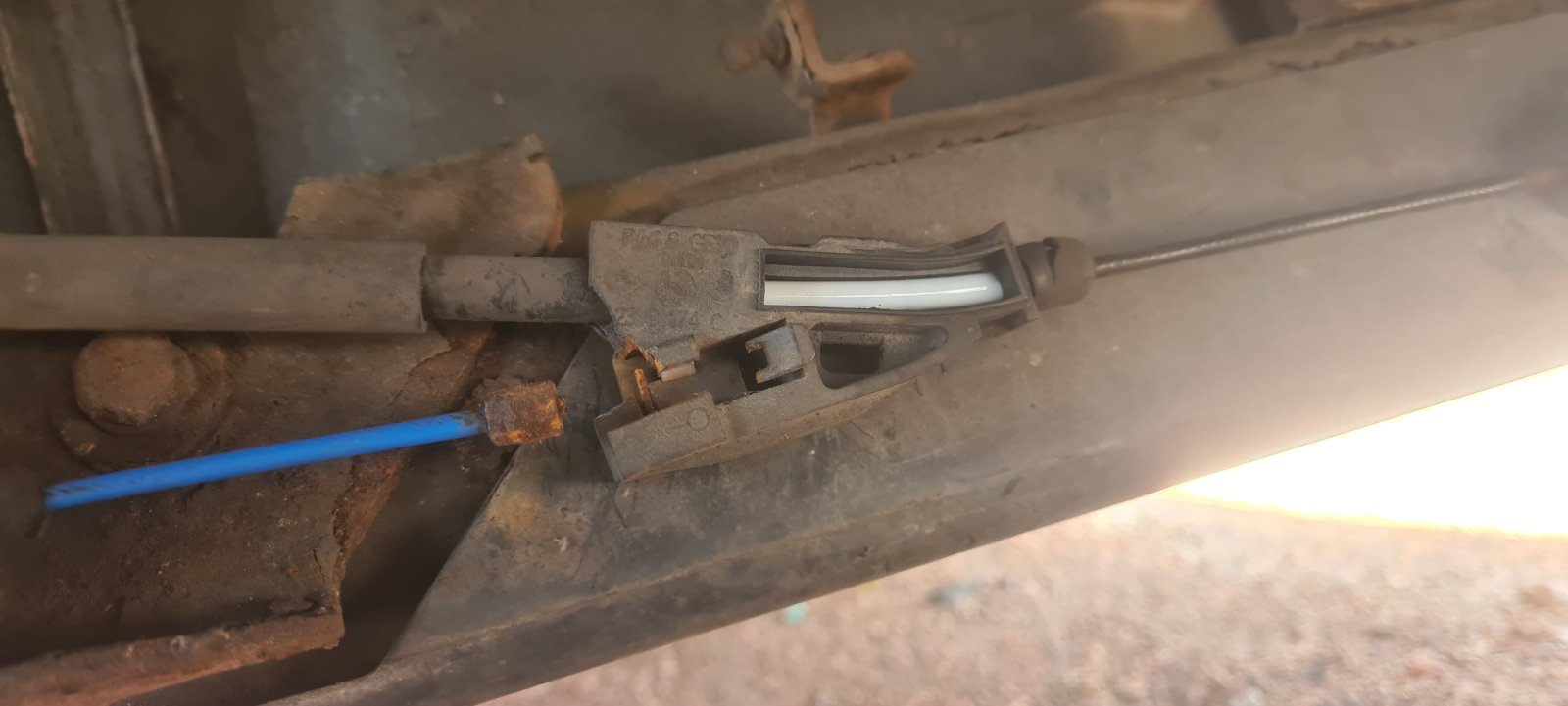

]Your correct Richard it does, after further investigation the plastic piece that joins the one brake to the other has snapped. Is there any way of just buying the plastic piece, or has it fit to be the whole cable?

Re: C4 Picasso P1336 / P0303 and others.
That's only available as part of the main cable from the handbrake unit under the front passenger seat. It's not that expensive or too hard to change.
