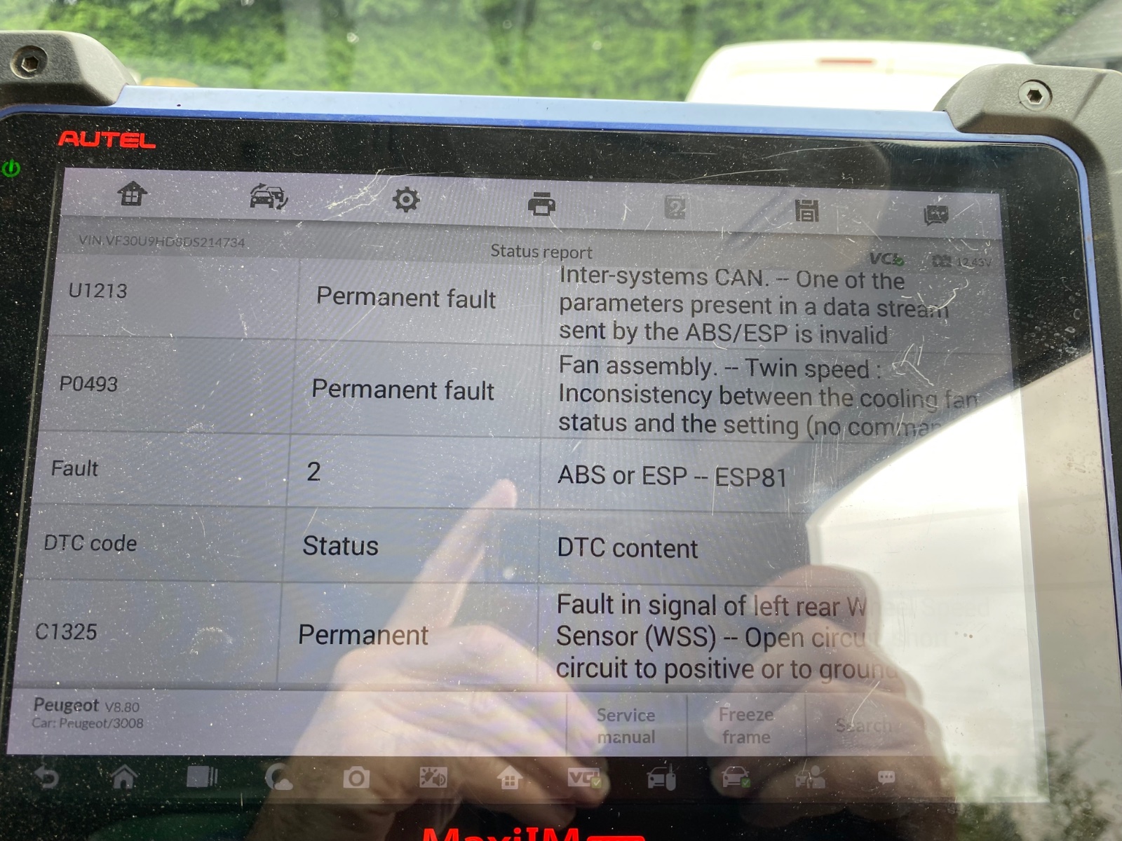

For future reference for others who may experience this issue.
Here are some photos:-
So C1325 was the error code showing an issue with the signal from the left rear wheel sensor.
The error can either be caused by writing to the sensor or the reluctor ring starting to disintegrate.
From the DTC, I then graphed the wheel sensors to see if there was any obvious errors reading them. There wasn’t. All sensors read fine at time of testing.
By allowing the car to roll down a slight slope I could control the speed and see if there was any dropouts but there wasn’t. The sampling rate on the Autel wasn’t fantastic, an oscilloscope would have been better.
I then inspected the reluctor ring using a boroscope which I video but I am unable to upload this as it is 136Mb in size.
With the naked eye, I could see a very slight crack in the ring and it was scored concentrically around its radius in two places.
As the brake discs and pads look in great condition, I am just going to replace the reluctor ring with one off Ebay for now as replacement discs include the ring as part of it.
With the boroscope, I could see detritus been attracted along the magnetic surface. I dare say that some iron has fallen behind the sensor and ground the grooves in the ring.
I may well remove the other side as a point if maintenance and clean up any detritus stick to the sensor and ring in an attempt to extend its lifespan. I’ll also probably copper-ease the backs of the pads whilst I’m at it.
