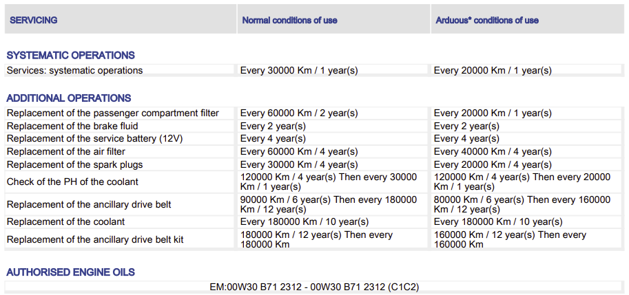

Is it possible to share the servicing operations and intervals recommended for my vehicle according to the manual parts specifications?
I'm also trying to understand if a need to change the fuel filter.

Here you go, VIN blacked out:
Click Image to Zoom
There's nothing specific regarding the fuel filter shown, but the replacement will depend on each vehicle's age and mileage, as an additional operation which the dealer would normally inform you of.

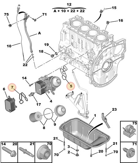

Could I request a part number for engine oil cooler gasket please?
- x 6950
(5) Engine Oil Filter Body Seal, part: 9804281880, £54.62
(7) Seal, part: 9804338480, £33.01

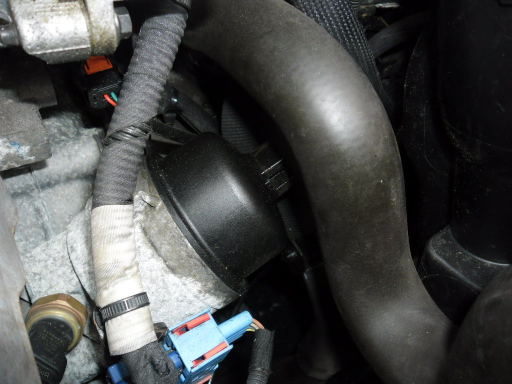

Hi Marc, Can you help with this mystery please. I believe it is the oil filter cover on my car, but it seems to have an electrical connection on top. However I can't find any loose ends of wiring harness that should plug in to it. My vin # is VF7**************[VIN obfuscated, can be read by forum staff]. I've just spotted a reply you have just done to Mexico14 which might show the item (Item 9 possibly), but no signs of any electrics. Thanks.

There's no electrical connection - it's just the oil filter cover and the bit on top is just a moulded nut type thing for rotating, but there are no electrical connections there.

Just had another look with the sun shining in the right spot... and all I can say is my bad, your absolutely right as always, a large hexagon with a strange clip on the side,
