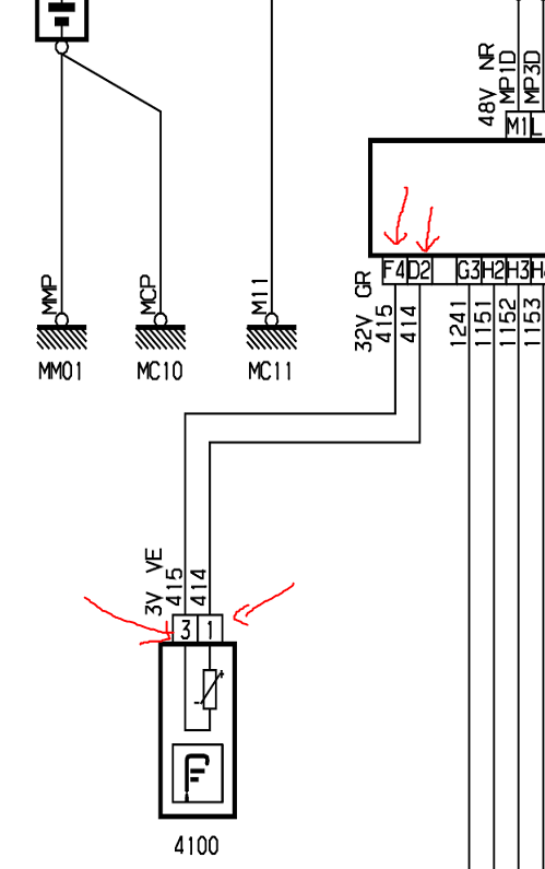

Is there a way to find out how many cables had the three-pin oil level sensor connector and where the wiring goes? I think I saw only two cables for the three pin connector when we lift the car. I purchased a new sensor (Valeo 366200) but I have not replaced it yet. My engine is RFJ (EW10A) VIN VF7**************[VIN obfuscated, can be read by forum staff].
- x 6946
Re: Oil level measurement invalid
4100 : engine oil temperature + level indicator
Wiring / Pins
414: Oil level / signal
415: Oil level - signal
This will be a 3 pin green connector, but only 2 pins are used.
Wiring / Pins

For reference, the oil level sensor contains a thermistor, which is a resistor that varies its resistance with temperature. The ECU uses a small current to read the initial resistance (hence temperature), then feeds a high current for a couple of seconds. This heats up the thermistor but the temperature rise is slowed by the surrounding oil that is acting as a heatsink. Thus the oil level can be calculated.
