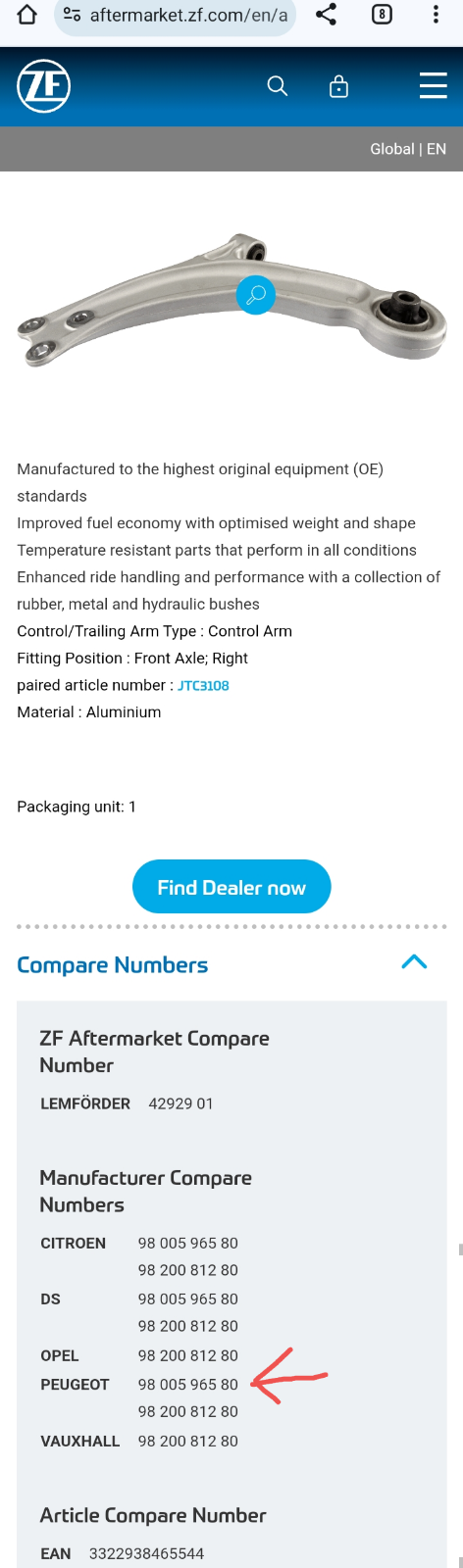

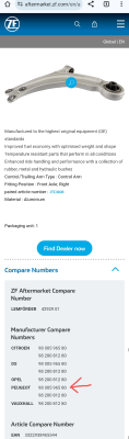

TRW / ZF offer two different ones for (what is probably !) your car. One is 'sheet steel' in construction, one is aluminium. They have two completely different OE part numbers across the range.
https://aftermarket.zf.com/en/catalog/p ... country=GB

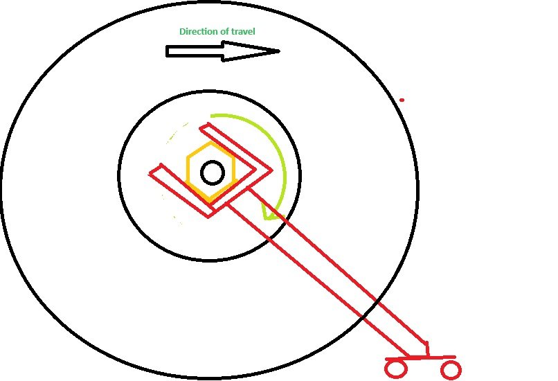

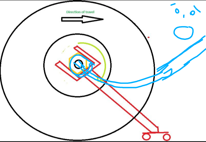

Just evolving Mick's "engine assisted" method:
Car on the ground, wheel centre cap off (or swap on the steel space saver) breaker bar through hole and rest end on the ground, drive forward (or backward for this one as it's the right wheel)
Would achieve same thing with less "dump the clutch and dive for cover" ? :-D weight of the car and grip of the wheel both working with you my suggested method.
Driving with loose driveshaft nut is not good for wheel bearing, but a foot or so shouldn't kill anything, I'd hope
Are you sure that is the right way round Matt? If it's the right, driver's side wheel, then to undo the nut you need to turn the nut anti-clockwise and hence the wheel clockwise which means driving forward surely? Unless it is a left hand thread and then the opposite applies!! :-D Further evolving that method it might be good to put the end of the bar on a skate to prevent it jamming and lifting the car up :-D

bobins wrote: 05 Aug 2024, 15:53 TRW / ZF offer two different ones for (what is probably !) your car. One is 'sheet steel' in construction, one is aluminium. They have two completely different OE part numbers across the range.
Interesting, thank you.
The alloy one does list the same Peugeot part number as listed on the alloy FAI part I've bought off eBay:
TRW site kindly provided (alloy wishbone)
Just back from National Tyres, all sorted. £44.99.

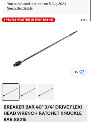

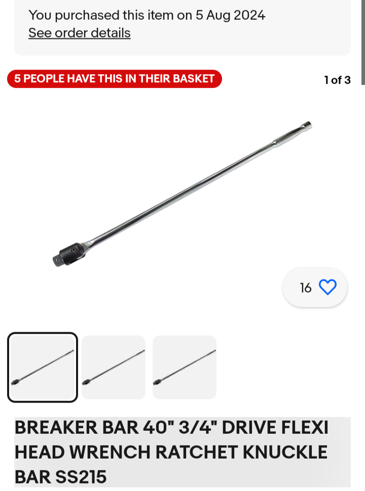

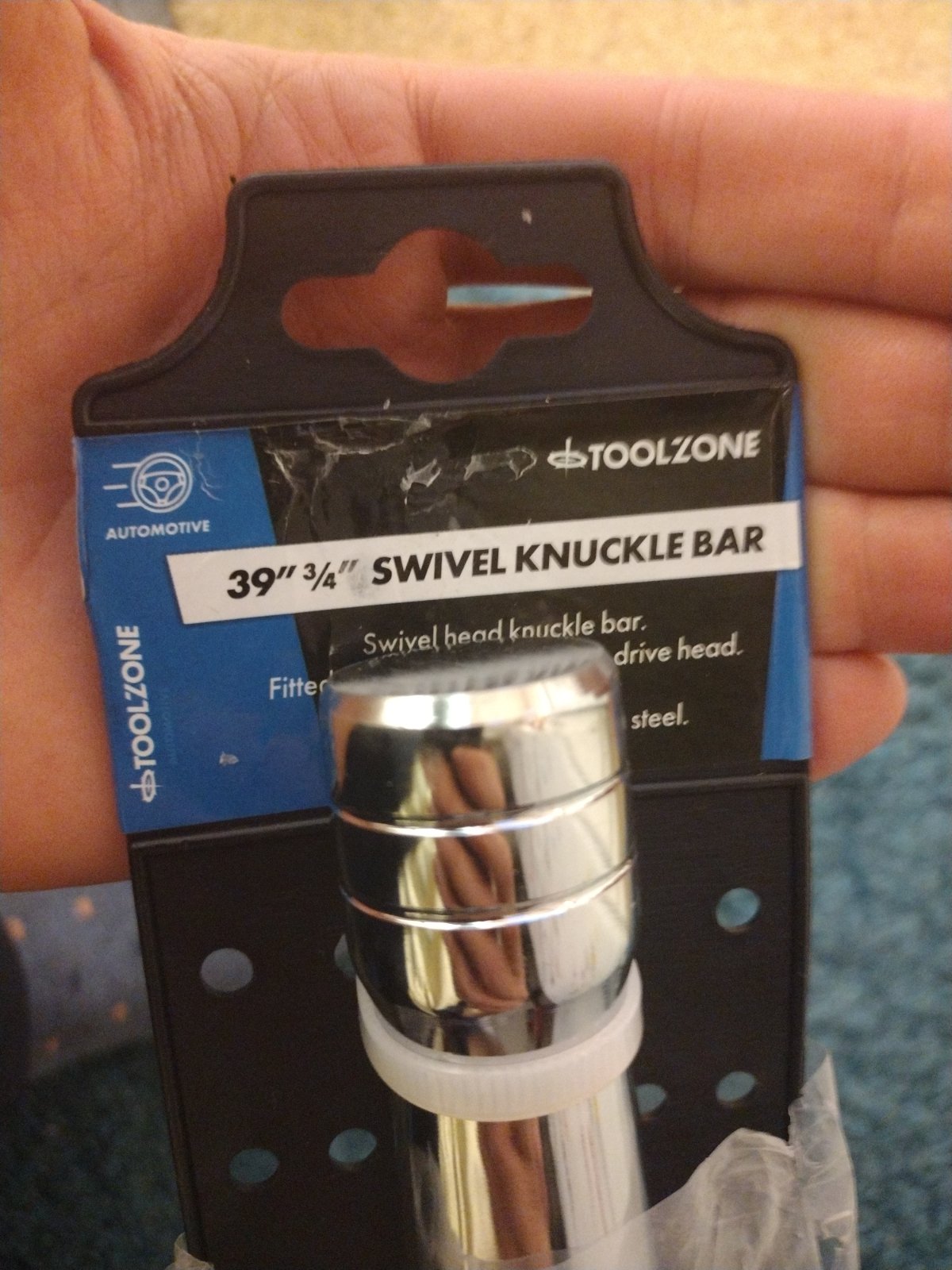

The big breaker bar arrived today, but I am absolutely livid, I've been short changed!!
This is what I bought:
eBay description
eBay description
And this is what the seller has the bare faced cheek to send out to me:
Spoiler: show
Details on what arrived!
Absolutely outrageous!!! :lol:
Posts: 21233
x 8126
Ouch!! Just shows how important an inch more can be!! :-D
Posts: 5337
Joined: 25 Apr 2022, 09:03
x 2355
Unread post by MattBLancs »
mickthemaverick wrote: 06 Aug 2024, 21:27 Ouch!! Just shows how important an inch more can be!! :-D
It's ok, I had a chat to the seller and he's explained it:
Spoiler: show
it's 39" long, but on the end it's 3/4" inch square,
39" + 3/4" + 3/4" = 40 1/2" so I've got some extra thrown in free!
:rofl2:

There's quite a few different part numbers for the wishbones Matt; Yours are 98 463 297 80 (left, replaced 96 783 113 80) and 98 463 292 80 (right). They are £150.90 each from the dealer...

mickthemaverick wrote: 05 Aug 2024, 16:15
MattBLancs wrote: 05 Aug 2024, 15:11 Sat in National Tyres - they're going to do the tracking shortly.
You are quite correct, right wheel should have been drive forward, left wheel would be mirroring the setup hence reverse.
Normal thread both sides.
I couldn't work out whether the bar digging in and trying to lift the car was to the benefit or detrimental to the desired outcome:
- on the plus side, weight of the car would then be resisting the lifting action which would then be increased the torque applied.
- on the negative side, lifting the wheel would reduce it's grip on the ground, hence would in effect reduce the torque it was able to transmit in effect from the other wheel,which is seeking to move the whole car forwards, meaning rotation of the wheel that was now being lifted, meaning net reduction in torque transmitted.
Also, I don't own a skateboard so am unsure what "and then the skateboard exploded" adds into the overall risk as a new and interesting failure mode!! :-D
Posts: 21233
x 8126

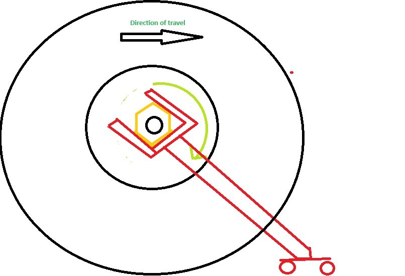

This helps to visualise what is going on !! :-D
Own creation
Own creation
Posts: 5337
x 2355
mickthemaverick wrote: 07 Aug 2024, 21:32 This helps to visualise what is going on !! :-D
Great drawing, for completeness, I've superimposed what my half inch breaker bar looked like at the weekend:
Not a bad likeness for my facial expression at the time, included too! :)
