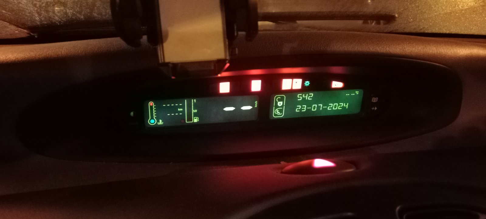

Hello everyone,
I'm having a problem with my 2004 Picasso, basically the dashboard comes on even when the car is not running and the key isn't even in the ignition, look at the picture that I took yesterday morning just as I got in the car. Anyone know how to fix it or at least tell me what's wrong. At first my mechanic said it was the air bag sensor, so we changed it to a new 1, but it didn't change anything. Thanks in advance.

Re: Problem with dashboard on a 2004 picasso
Any recent changes made to the electrical system or any work done?
Does the car have an aftermarket radio fitted?
Does it go out after a few minutes then illuminate again when the car is unlocked?
Have you tried a BSI reset by disconnecting & reconnecting the battery?
It might be worth looking for the SHUNT fuse in the cabin fuse box (it is not actually a fuse), put it into the opposite position for a couple of minutes, and then return it to the normal position (I do not recall what the official terms are). When I had a Xsara Picasso as a company car I had one occasion where the dashboard lit up like a Christmas tree, and I could not do anything about it. As the company had cover I called out the RAC, and when he arrived he did what I suggested, and it cleared the problem (never to return when in my care).
There may be something else causing the dash to come on. Can you try disconnecting the battery then un plugging the radio & reconnect the battery. See how that goes, a faulty radio can also cause issues with the dash display.
If you get a used dash display with a lower mileage than yours then the higher mileage from your car will be saved to it, if you get one with a higher milage then yours then your car will (permanently) inherit the higher mileage unless you get a specialist to reset it.
I’ll give you 2 examples i have had with the xsara picassos that i have seen believe it or not on numerous occasions.
Children posting coins into the CD player slot, i have seen this on quite a few occasions, nearly every time there there was no actual issues with the radio, just random issues with the instrument panel like the speedo showing dashes instead of a speed. Amazingly usually the radio is working normally but when you remove it & shake it sounds like a piggy bank.
The other one is those little liquid filled air fresheners that you clip onto the air vents, ive had these leaking into the radios causing instrument panel issues even though radio working correctly.
The instrument panel & radio have a master/slave connection so a fault with one can affect the other, disconnecting it should rule this out.

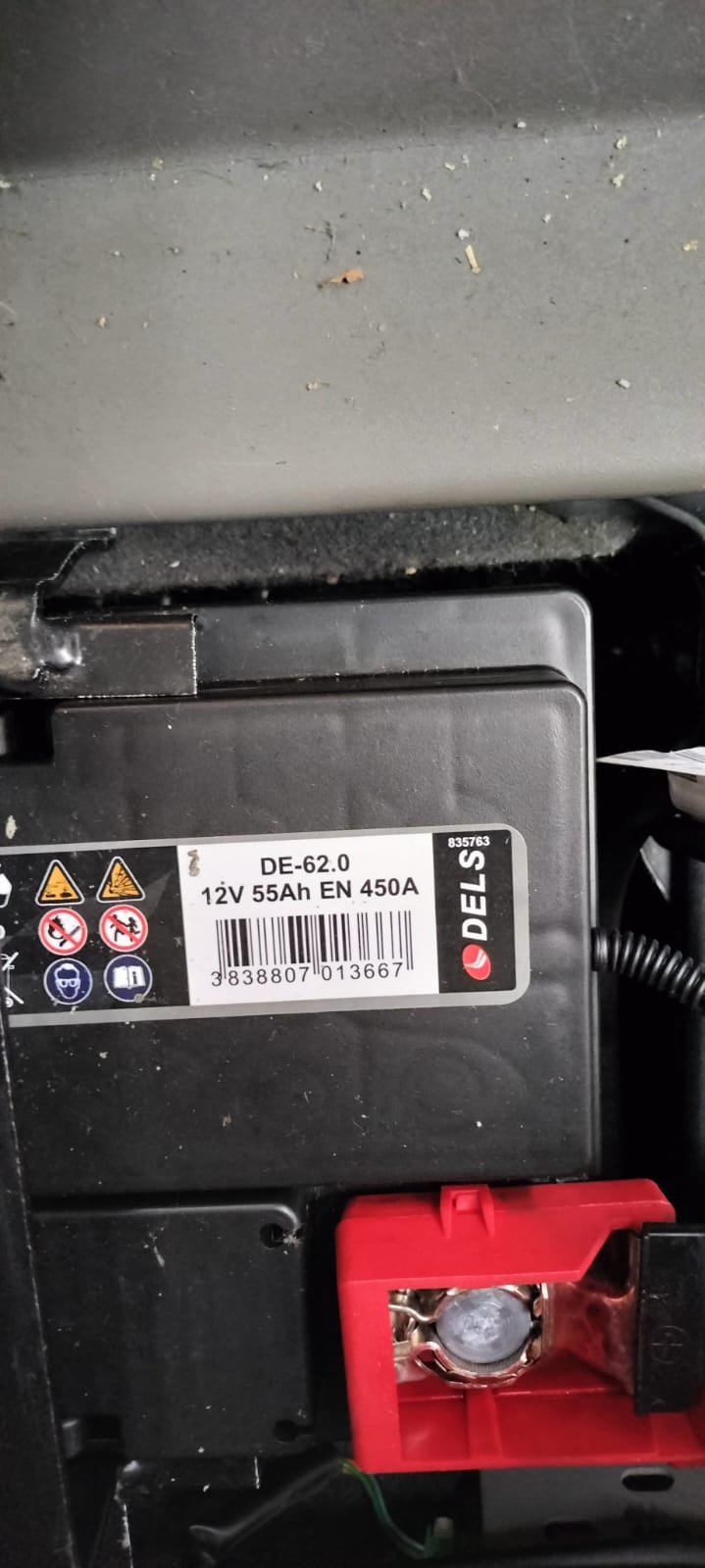

What battery exactly did you fit?FurryCurrySauce wrote: 25 Jul 2024, 17:29 The only thing I've done to my car was change the battery about a month to 6 weeks before the problem started.
This is the battery I replaced the older battery with, which I think is exactly the same make and model as the old onePaul-R wrote: 06 Aug 2024, 08:42What battery exactly did you fit?FurryCurrySauce wrote: 25 Jul 2024, 17:29 The only thing I've done to my car was change the battery about a month to 6 weeks before the problem started.
