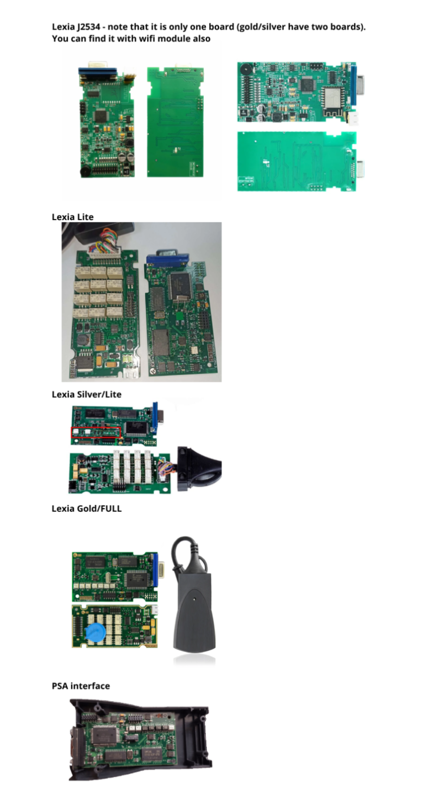

Just to add about multiple versions of said interface, the best will be "gold", "gold full chip", etc. Preferably, look for listings with a board view, as you can tell if it is indeed a full version. Cheaper ones should be listed as lite/silver.
Boards look different, as in most cases, gold has a gold line around the edges of the PCB and has 7 phototransistor optocouplers. I have a comparison of the board views of these versions (alongside OE). If needed, I could arrange a graphic with these, as I don't own rights to this exact image.

I quickly arranged a graphic - differences should be visible.
Short summary below is for C5 X7:
  • J2534 is not recommended as it is known to work incorrectly.
  • Lite with one phototransistor optocoupler - is a "rare" find and I don't know how it behaves.
  • Silver/Lite with two phototransistor optocouplers - should work just fine. People recommend it for only sporadic/rare use.
  • Gold - works fine, recommended by people for often use. The biggest difference is in protection against overvoltage, as far as I know.
As a warning, there were cases that gold/silver couldn't connect to some calculators (most notably hydraulic suspension/css). It should also be noted that these clones may have quality control issues, and even the more expensive gold version may not have worked out of the box or stopped working after some time. Sometimes you may come across a dishonest seller that can ship you another version than listed and tearing it down to see board, effectively deprive you of the possibility of a refund.
Therefore, it is strongly advised to contact a person with know-how or buy from verified seller/listing (preferably recommended from some local groups).
First of all, I recommend doing as Marc said:
GiveMeABreak wrote: 03 Aug 2024, 15:16 Have a chat with Jim at Easydiagnostics for advice.
